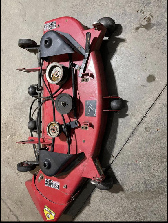

Jbell 0 #1 Posted October 8, 2021 I have an aged deck with a model 78280 sticker. Looking for options on a swap. I came across a deck off a smaller hp hydro with a sticker of 78265. Will it bolt up the same? I also came across a NHolland which seems to be the same disguised in blue. Both are priced for $300. Thoughts appreciated. Two images attached. Share this post Link to post Share on other sites
gwest_ca-(File Mod) 11,878 #2 Posted October 9, 2021 78265 is a 48" recycler for a 260-Series tractor 1997-1998 78280 is a 52" side discharge for a 260-Series tractor 1996-1999 Share this post Link to post Share on other sites
gwest_ca-(File Mod) 11,878 #3 Posted October 10, 2021 Suspect the model numbers starting with 98 on this manual are for product produced for New Holland. Share this post Link to post Share on other sites
