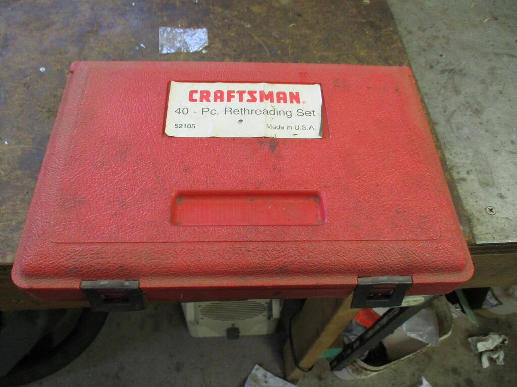

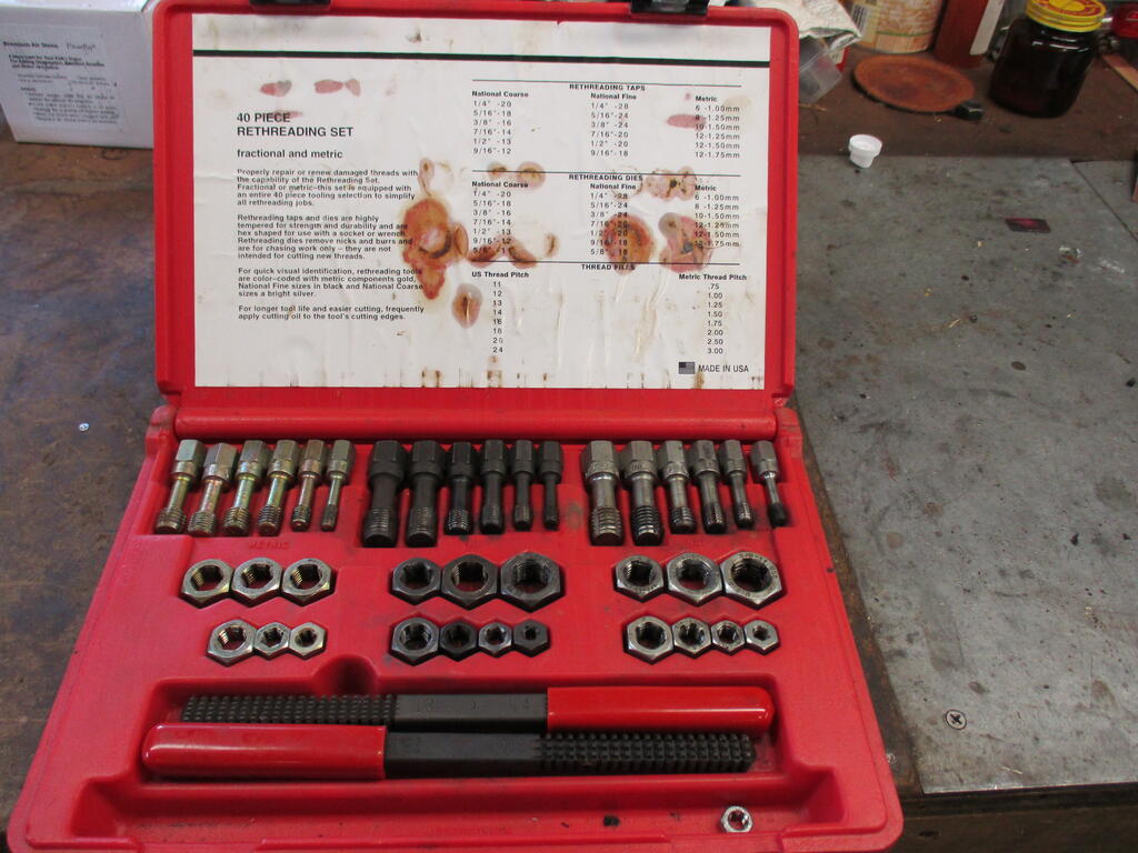

pfrederi 19,448 #8 Posted October 6, 2021 Bought this set probably 25 years ago. One of the best tool investments I ever made.. Use it on Milittay vehicles (lots of NF) Old tractors Case and Farmall and of course lots of Wheel horses. Share this post Link to post Share on other sites
Wheelhorse#1 1,890 #9 Posted October 9, 2021 On 10/6/2021 at 2:07 PM, pfrederi said: Bought this set probably 25 years ago. One of the best tool investments I ever made.. Use it on Milittay vehicles (lots of NF) Old tractors Case and Farmall and of course lots of Wheel horses. That’s a nice looking set.I bought a tap and die set from TS it’s ok but doesn’t have larger sizes. 25 yrs ago craftsman,they were still making nice stuff, now most everything,like every thing els is China garbage …don’t get me started !😉 Share this post Link to post Share on other sites
