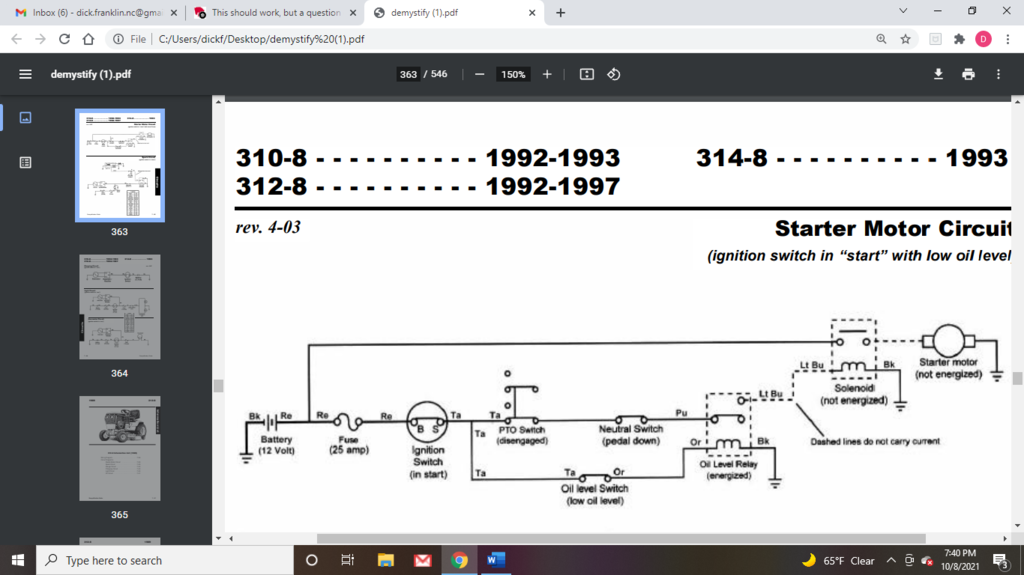

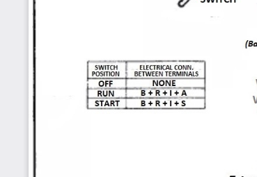

Hi ya all. Just a quick question. I have just bought a Toro WH 212-5 thats a none runner. Its none runner simply because the key snapped off on the ignition switch.
But when i went to pick it up the old owner had very kindly taken out the old switch. My question is i was looking for a "block of wires" that plug onto the back of the switch, however there is not one.
There are all seperate wires with spades on them so they could go any order. The old switch has 7 posts. Can someone just post a close up photo of the back of there switch if possible, or a wiring diagram that includes ign swch please.
