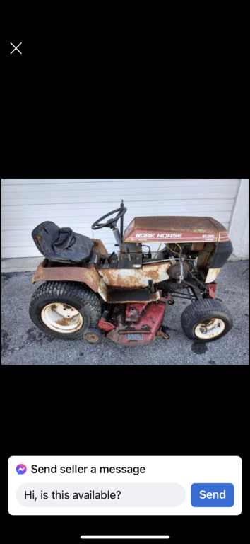

Horse Newbie 7,405 #828 Posted February 13, 2022 Just wondering… why does it seem like we see a LOT / MOST of the Work Horses have a problem with surface rust ? Any ideas why ? The reason I ask is I’m getting closer to painting my 1984 Work Horse GT-1600. Share this post Link to post Share on other sites
TJ5208 1,841 #829 Posted February 13, 2022 Just now, Horse Newbie said: Just wondering… why does it seem like we see a LOT / MOST of the Work Horses have a problem with surface rust ? Any ideas why ? The reason I ask is I’m getting closer to painting my 1984 Work Horse GT-1600. Because people neglect them and leave them sitting outside. 1 Share this post Link to post Share on other sites

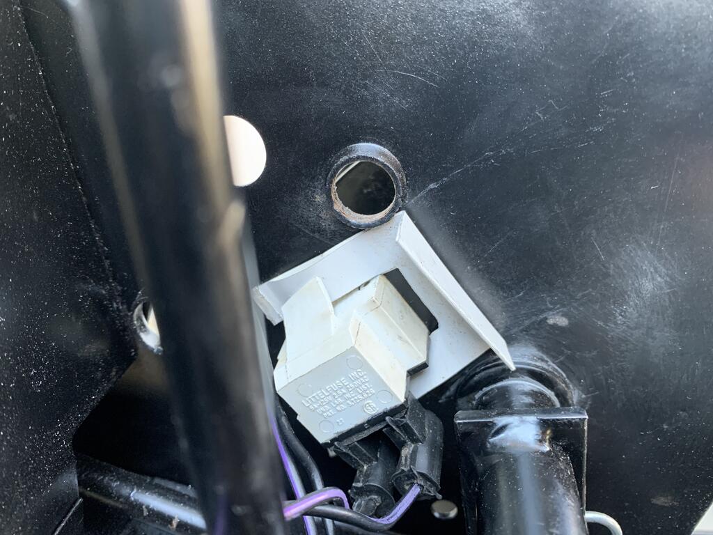

Horse Newbie 7,405 #830 Posted February 13, 2022 Yesterday while I was working on the Work Horse, I made up a little metal clip to slide down on the clutch safety switch… It rattled around in the hole and I was told by someone on here that it needed to be snug. 4 Share this post Link to post Share on other sites

Horse Newbie 7,405 #833 Posted February 14, 2022 Just wondering… why does it seem like we see a LOT / MOST of the Work Horses have a problem with surface rust ? Any ideas why ? The reason I ask is I’m getting closer to painting my 1984 Work Horse GT-1600. Share this post Link to post Share on other sites

ebinmaine 81,283 #835 Posted February 14, 2022 4 hours ago, Horse Newbie said: Work Horses.. surface rust ? Any ideas why ? I can't be sure but I can offer a couple educated guesses. 1. That paint was applied during a time period of gummint mandated change in the industry. LOTS of manufacturers of many different things were having the same issues. 2. Perhaps the demographic that predominantly purchased the price competitive Work Horses was more likely or less able to properly cover their equipment. 4 hours ago, Horse Newbie said: have any of you guys heard of one being needed on the twin Briggs on the Work Horse ?… if so, I’d better order two Haven't specifically heard of the B & S having the same tendencies but you're there. IMHO.... Order two bulbs and be happy it got done on both tractors. FYI. Search carefully and you may find the price is discounted on some fleabay vendors. It may be prudent to buy more than two and keep spares for future use or the next WH project. 2 Share this post Link to post Share on other sites

kpinnc 19,107 #837 Posted February 14, 2022 (edited) 7 hours ago, Horse Newbie said: Just wondering… why does it seem like we see a LOT / MOST of the Work Horses have a problem with surface rust ? I saw one that was pushed out in front of a mower shop years ago in excellent condition. No awning, no cover, nothing. Owner said it wasn't for sale. 5 years later it was still out there, not in such good shape anymore. About like your picture with four flat tires and a cracked seat. Dunno what the heck people think is going to happen to them... Eb's theory on paint quality of the time makes sense to me too. I remeber several folks getting free paintjobs on GM and Chryslers back then. Edited February 14, 2022 by kpinnc 3 Share this post Link to post Share on other sites
ebinmaine 81,283 #838 Posted February 14, 2022 17 minutes ago, kpinnc said: Eb's theory on paint quality of the time makes sense to me too. I remeber several folks getting free paintjobs on GM and Chryslers back then That was fairly well spread across any manufacturer that sprayed paint in the United States. I worked at an old time style wholesale auto parts store from 1992 to 1996. We sold DuPont paint. That was the time period when they were beginning to figure out how to actually get low VOC paint to stick and stay there but it took a few years. We were just one tiny little hole in the wall store and we sold a BUNCH of paint.... 3 Share this post Link to post Share on other sites
cleat 9,451 #839 Posted February 14, 2022 And if I remember correctly, the silver, grey and blue were among the worst colours for adhesion. The reds seemed to fade worse than other colours. 2 Share this post Link to post Share on other sites
kpinnc 19,107 #840 Posted February 14, 2022 2 hours ago, cleat said: The reds seemed to fade worse than other colours. I think they still do, too. 1 Share this post Link to post Share on other sites
Lee1977 7,813 #841 Posted February 14, 2022 They went cheaper on the engine and used the one inch axle 4 pinion transmission they used on the 300 series . They may have used cheaper paint also as they were trying to get the price of the Work Horse down below the 300 series. The red paint they used on the Wheel Horses wasn't that great either, It looked good but didn't hold up very well. 2 Share this post Link to post Share on other sites
Achto 32,964 #842 Posted February 14, 2022 I worked in a body shop from '88 - '89. We did warranty work for the local Ford dealership. I painted a lot of cars & trucks that they brought to us with the paint pealing off. Some of the vehicles you were able to remove most of the paint with just a pressure washer. 1 2 Share this post Link to post Share on other sites
cleat 9,451 #843 Posted February 14, 2022 My dad bought a new Chevy half ton in two tone dark red and silver in 1988. First trip to the car wash a lot of the silver that was on the lower part of the truck peeled off. It was grey primer underneath so he just left it. 1 1 Share this post Link to post Share on other sites

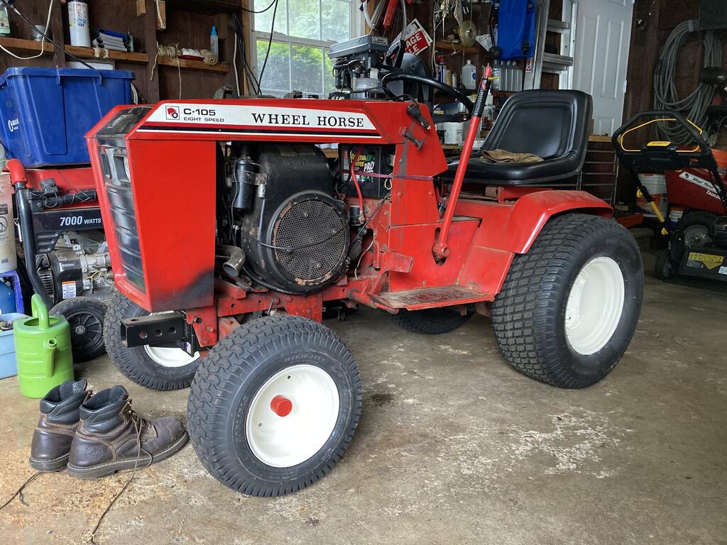

SylvanLakeWH 32,921 #846 Posted February 14, 2022 I have a bulb on my C 105. Works like a charm… couple pumps and fires right up… I also believe they have one way valve(s) or they wouldn’t function… 2 Share this post Link to post Share on other sites

ebinmaine 81,283 #848 Posted February 14, 2022 Where on the tractor do you locate the primer bulb? 1 Share this post Link to post Share on other sites
SylvanLakeWH 32,921 #849 Posted February 14, 2022 Between engine and column on mine…lower right of engine: 1 1 Share this post Link to post Share on other sites
kpinnc 19,107 #850 Posted February 14, 2022 4 minutes ago, ebinmaine said: Where on the tractor do you locate the primer bulb? Anywhere that it is comfortable to reach on the fuel line path. I hit mine every time I raise the hood to check the oil before a start. Cranks on the first turn in most cases. 3 Share this post Link to post Share on other sites
