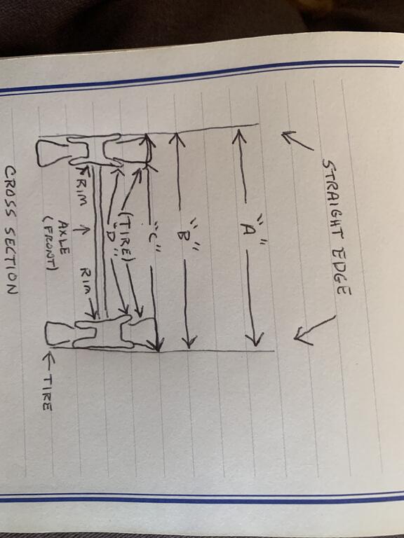

Horse Newbie 7,405 #443 Posted January 8, 2022 I have a question about setting the toe-in on the Work Horse, since I am replacing the tie rods and having the rims powder coated. Take a look at the photo attached and tell me, where do I measure the 1/4 inch toe-in ?… at point “a”, point “b”, point “c”(outer front edge of the front tires), or point “d”( outer front edge of the front rims) ? I have attempted to draw a cross-section view to try to illustrate what I am talking about. I do know the farther out on the straight edge I measure, the less actual “toe-in” I will have at the rims. Any help or advice will be greatly appreciated. Share this post Link to post Share on other sites
Jeff-C175 7,212 #444 Posted January 8, 2022 (edited) 19 minutes ago, Horse Newbie said: help or advice To measure and adjust the toe you also need a measurement BEHIND the axle which you haven't shown. Obviously the further away you are, the more 'sensitive' the measurement, but you don't really need that much. It's not going to make a difference that you can feel. I measure between the fronts of the wheels and between the rear of the wheels. Center the steering wheel and clamp it so it won't move and adjust so the distances are about equal, say within a quarter inch or so. You only need to be close. Edited January 8, 2022 by Jeff-C175 2 1 Share this post Link to post Share on other sites

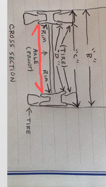

ebinmaine 81,289 #445 Posted January 8, 2022 I measure from the red line to your letter D line. Front of rim to back of rim. I go for about ⅛ to ³/¹⁶ difference. I use 2 rulers stacked and clamped. Get the front snug between the rims and just eyeball the back. 2 1 Share this post Link to post Share on other sites
Jeff-C175 7,212 #446 Posted January 8, 2022 6 minutes ago, ebinmaine said: I go for about ⅛ to ³/¹⁶ difference. 6 minutes ago, ebinmaine said: Get the front snug between the rims and just eyeball the back. Yeah, you want a little bit of toe IN, not OUT. On my machine with the tri-ribs it's easier to measure from the center tire rib itself, it's a big target and easy to get to! 2 Share this post Link to post Share on other sites
Horse Newbie 7,405 #447 Posted January 8, 2022 4 minutes ago, Jeff-C175 said: Yeah, you want a little bit of toe IN, not OUT. On my machine with the tri-ribs it's easier to measure from the center tire rib itself, it's a big target and easy to get to! With “toe-in” meaning the measurement will be shorter in the front of the rims, with the fronts of the rims very slightly angled towards the centerline of the tractor ? 1 Share this post Link to post Share on other sites
Jeff-C175 7,212 #448 Posted January 8, 2022 (edited) 35 minutes ago, Horse Newbie said: With “toe-in” meaning the measurement will be shorter in the front of the rims, with the fronts of the rims very slightly angled towards the centerline of the tractor ? Correctamundo. Strangely though, nearly every WH I've looked at with the non-adjustable tie rods has been toed OUT from the factory by ohhh, maybe a half inch or so. You can stand in front of the machine and SEE it in fact. Which makes me wonder ... WHY ? (I do too much of wondering why I think!) Is there something Mr. Pond knew that we don't know? Fact is though, traveling at 7 MPH tops, it really doesn't matter. In an auto traveling at road speed, if you're toed OUT the steering will have a tendency to want to 'wander' from left to right as the vehicle tries to first follow one tire, then the other. It is NOT a peaceful easy feeling driving a vehicle like that, and I've had a few! The worst thing is when they take to 'oscillating', THAT is scary! Ya know, it's possible... maybe... that a little bit of toe OUT would actually 'lighten' the steering a little bit. If one tire is already pointed in the direction you want to go... as opposed to if they are toed IN a bit, one tire is going to 'scrub' a little. In other words, a slight toe OUT might provide a teeny bit of steering ASSIST. maybe... and I don't even want to START thinking about how that geometry changes as you turn the wheel! And it will change, caster, camber, affect that. And don't forget that the RADIUS of the circle the tire is following is different in a turn. Yeah, just 'eyeball' them and you'll be fine. Edited January 8, 2022 by Jeff-C175 1 Share this post Link to post Share on other sites
