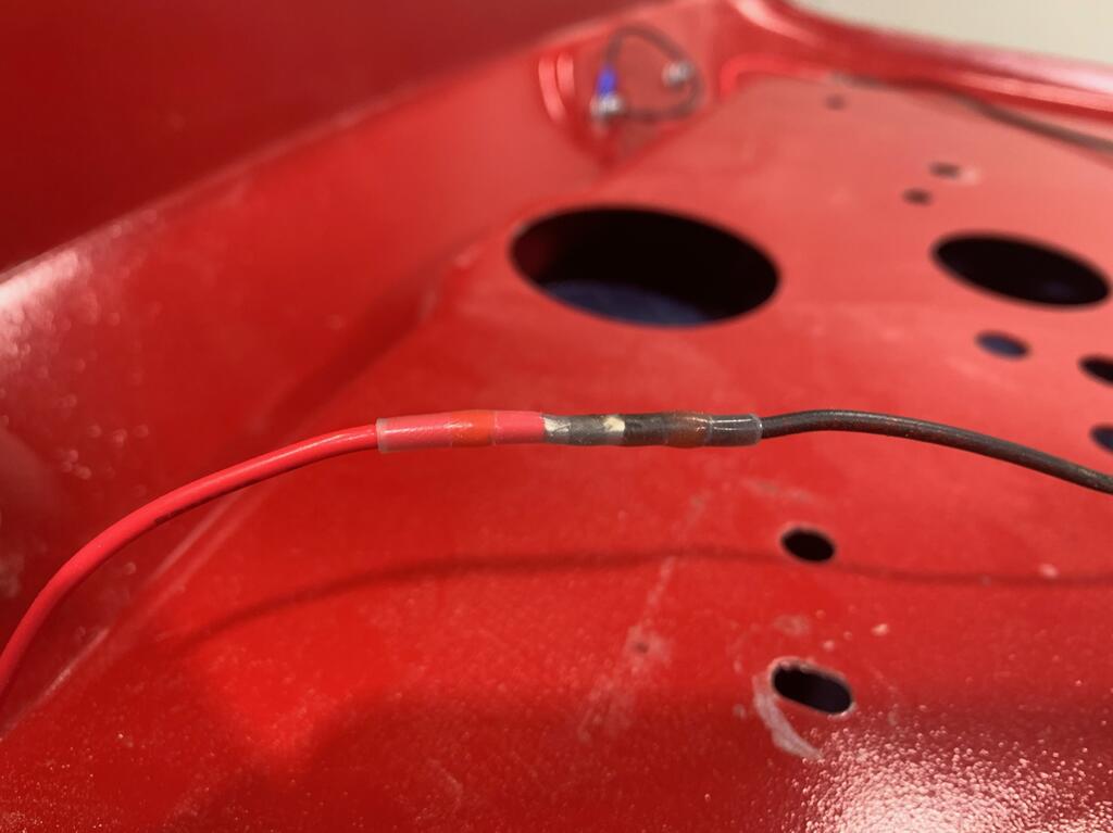

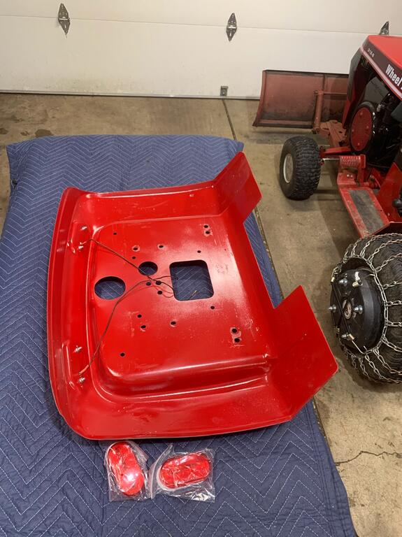

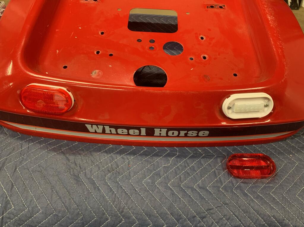

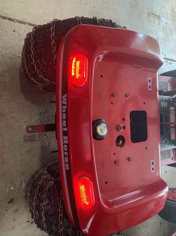

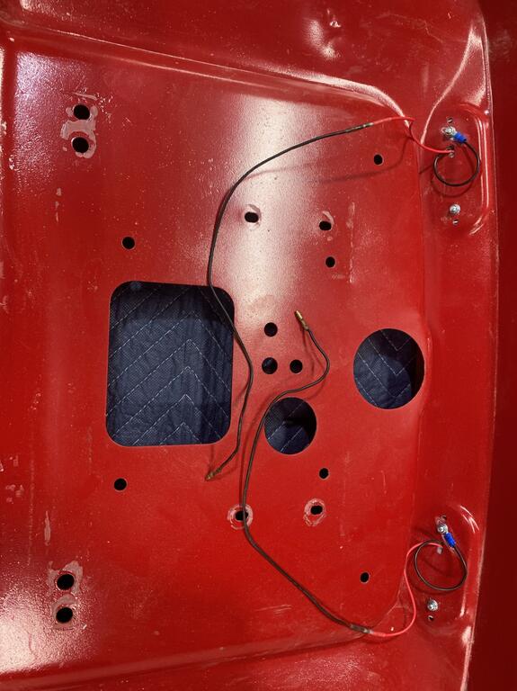

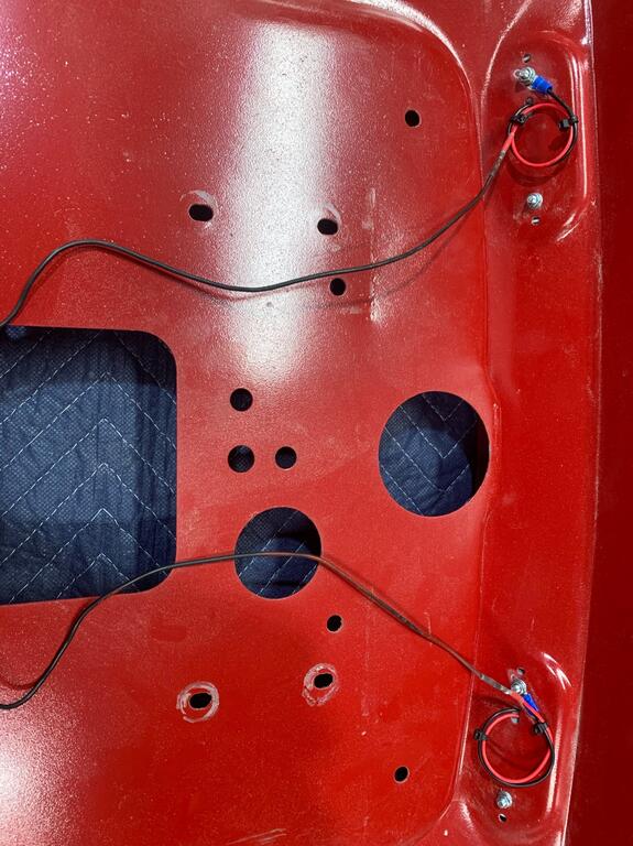

Andy N. 2,558 #2 Posted October 3, 2021 Go LED for the lights. Tail lights require you to drill out the existing tail light holder. I reattached with screws. Also need to attach the ground wire since the old sockets were grounded through the socket rivets. I found heat shrink solder sleeves to attach the existing power connector. Headlights should be a direct replacement. https://www.amazon.com/gp/product/B00VT85Q0G/ref=ppx_yo_dt_b_asin_title_o01_s00?ie=UTF8&psc=1 https://www.amazon.com/gp/product/B07R88B64W/ref=ppx_yo_dt_b_asin_title_o00_s00?ie=UTF8&psc=1 As far as the seat, mine have been torn, but not so bad that I was able to just use a simple seat cover. 2 2 Share this post Link to post Share on other sites
