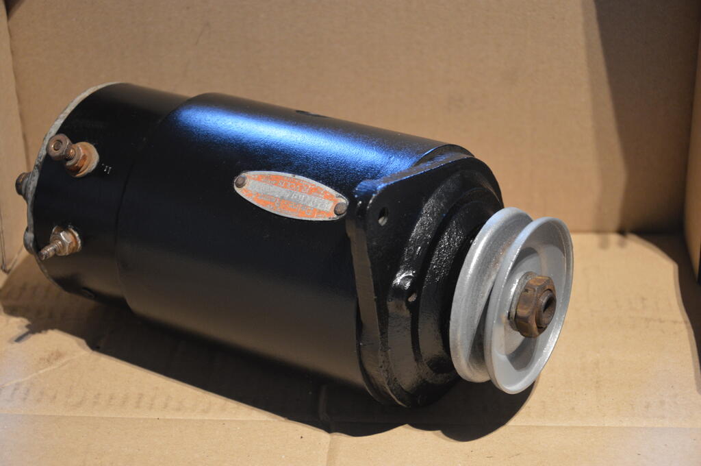

Maxwell-8 4,371 #26 Posted October 3, 2021 (edited) I put everything back together gave it some paint. Brushes looked like they had just some more life in them. couldn't find a part number so I assembled everything after a good internal clean and grease. Looks good, but still isn't like it should be, turns faster but still doesn't has the needed power even if I put direct power to it (cleaned surfaces). I guess the brushes still need to get replaced, everything else looked fine. Edited October 3, 2021 by Maxwell-8 1 Share this post Link to post Share on other sites
squonk 48,157 #27 Posted October 3, 2021 See what that voltage is at the A terminal whilst cranking and report back 1 Share this post Link to post Share on other sites
Maxwell-8 4,371 #28 Posted October 4, 2021 19 hours ago, squonk said: See what that voltage is at the A terminal whilst cranking and report back Haha, battery was low from cranking and trying before the rebuild. The cleaning and polishing the copper was all that was needed. All the dust from the brushes were conductive I guess. Back in Business and now his generator is nicely painted, He might start to restore his Tractor. 2 Share this post Link to post Share on other sites
Handy Don 17,490 #29 Posted October 4, 2021 1 hour ago, Maxwell-8 said: All the dust from the brushes were conductive I guess. Good assumption. Most of it was "powdered" brush. 1 Share this post Link to post Share on other sites
Maxwell-8 4,371 #30 Posted October 4, 2021 25 minutes ago, Handy Don said: Good assumption. Most of it was "powdered" brush. I think all of it, cause it's a sealed unit. Share this post Link to post Share on other sites
