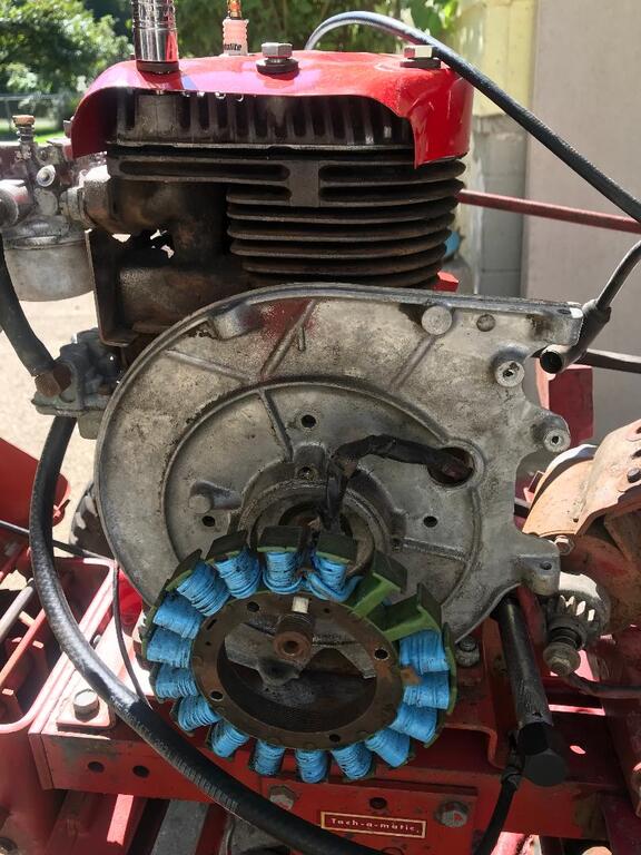

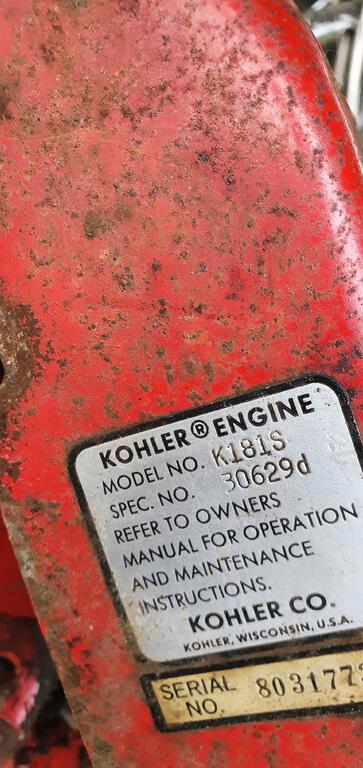

Gary Ch 21 #26 Posted September 29, 2021 This is a Kohler 8 hp engine, spec 30461D thats all I know. Share this post Link to post Share on other sites

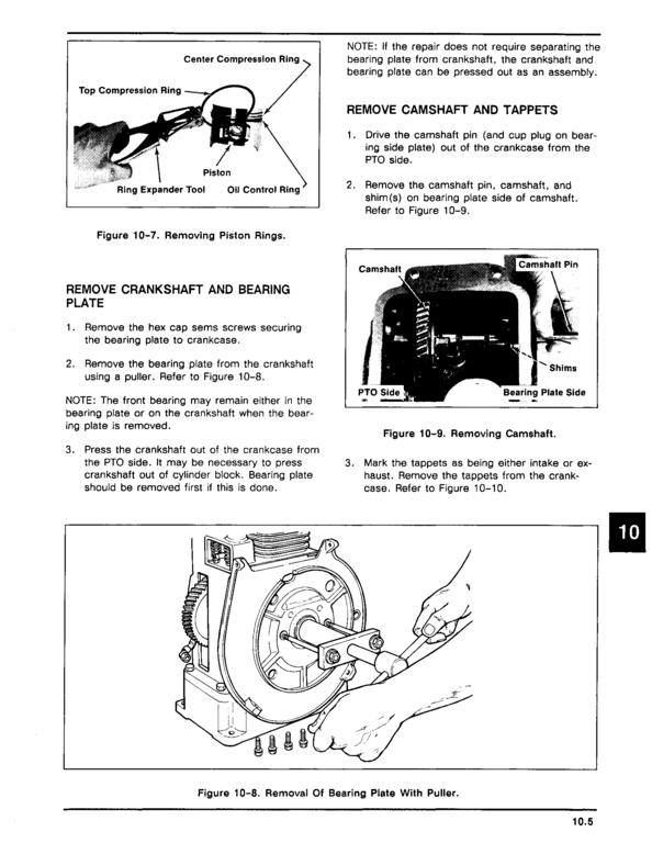

pfrederi 21,181 #27 Posted September 29, 2021 (edited) Use the service manual available free here Click on fuzy picture You have to rig a puller to get the plate off. Edited September 29, 2021 by pfrederi Share this post Link to post Share on other sites
Gregor 4,848 #28 Posted September 29, 2021 (edited) 7 minutes ago, Gary Ch said: This is a Kohler 8 hp engine, spec 30461D thats all I know. Duh I knew that. Not a big block. No balance gears I don't think Removal Installation. Refer to above posted manual. Thats the best thing Edited September 29, 2021 by Gregor Share this post Link to post Share on other sites

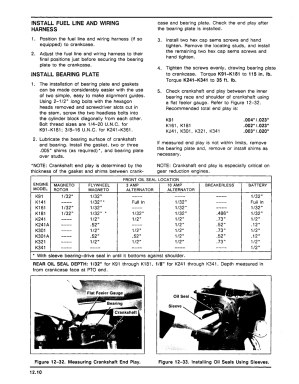

WHX?? 58,220 #29 Posted September 29, 2021 10 minutes ago, Gary Ch said: Is there a ring inside/behind the rubber gasket at the bearing plate No... I get by with gently tap the bearing plate outward the bearing will likely stay on the crank but not always. You might have replace some gaskets behind the bearing plate if they do not come apart cleanly. there may be multiple gaskets as they are what sets the crank end play. All this should all be inthe service manual Paul has graciously provided. Share this post Link to post Share on other sites

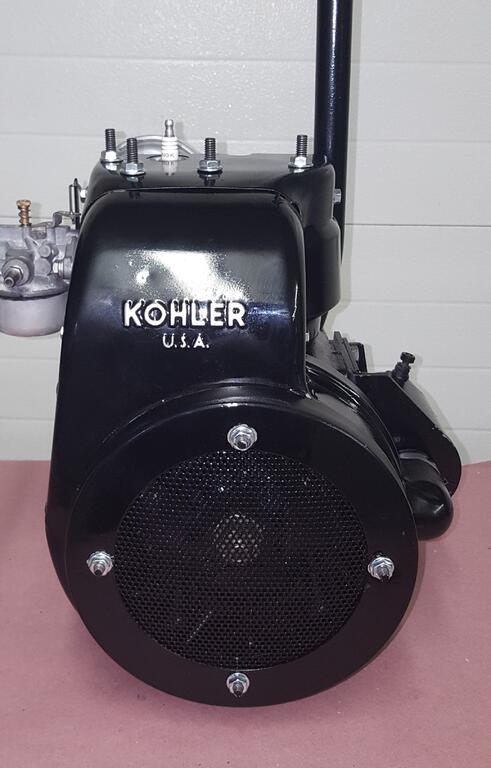

Gregor 4,848 #31 Posted September 29, 2021 This is an 8 HP Kohler, with electric start. This,is what you should end up with, except yours will not have the tall dipstick. This one doesn't either, anymore. 1 1 Share this post Link to post Share on other sites
Gary Ch 21 #32 Posted September 29, 2021 You guys are the besets man! I'll go get a smaller gear puller for this aluminum bearing plate now, got too many things to do, license bureau for the other car I bought. My neighbor said he would get it off the crank, but when I said those plates are $240 to replace, he kinda changed his mind Share this post Link to post Share on other sites

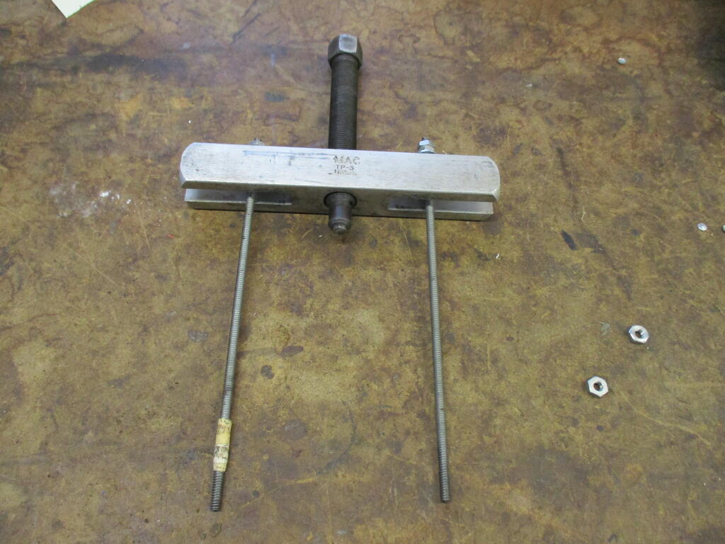

pfrederi 21,181 #33 Posted September 29, 2021 Couple pieces of 10-24 allthread and a timing gear or other puller Use the stator mount holes Share this post Link to post Share on other sites
squonk 48,157 #34 Posted September 29, 2021 I usually get bearing plates off with a dead blow hammer. Share this post Link to post Share on other sites
Gregor 4,848 #35 Posted September 29, 2021 (edited) I have never had to use a puller, but then maybe I have just been lucky. As I said, I didn't think it was even possible to install the bearing plate in that manner, and maybe in the end, it's not. Once you have it off, check it VERY CAREFULLY for cracks. Or maybe even take a close look before you take it off. Once you have the flywheel removed. Edited September 29, 2021 by Gregor 1 Share this post Link to post Share on other sites

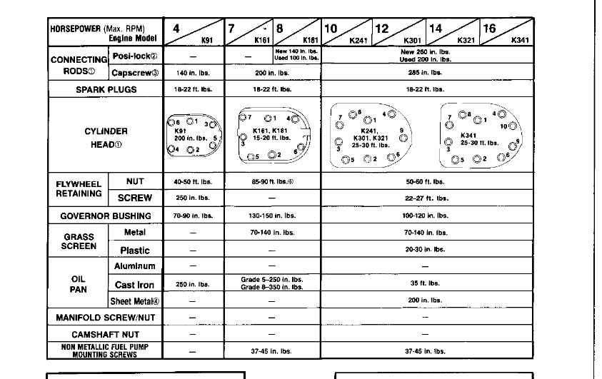

Slimshady 0 #41 Posted October 18, 2021 (edited) It is the sequence you tighten the cylinder head bolts down Edited October 18, 2021 by Slimshady Share this post Link to post Share on other sites
Slimshady 0 #42 Posted October 18, 2021 (edited) Thanks for the welcome ☺ Edited October 18, 2021 by Slimshady Share this post Link to post Share on other sites
Gregor 4,848 #43 Posted October 18, 2021 (edited) Ahhh You mean torque sequence. Got it. Edited October 18, 2021 by Gregor Share this post Link to post Share on other sites
Slimshady 0 #44 Posted October 18, 2021 (edited) Thanks alot bud that's exactly what i want perfect 😁😁👍 Edited October 18, 2021 by Slimshady Share this post Link to post Share on other sites
