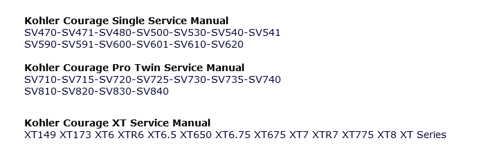

1973Auto 80 #7 Posted September 29, 2021 48 minutes ago, Gregor said: You don't give a guy much to go on. Any #'s on that engine such as these? Many Kohler service manuals are available on line for free download. These manuals include how to test different charging systems, but first, you have to know what you have. thanks! it is a SV540. Share this post Link to post Share on other sites
Gregor 4,847 #8 Posted September 29, 2021 You can download the service manual from here. https://www.kohler-engine-parts.opeengines.com/index.php?main_page=document_general_info&products_id=34596 I can tell you now, it basically says what has already been said above, but sometimes it's still nice to have a manual. Share this post Link to post Share on other sites
