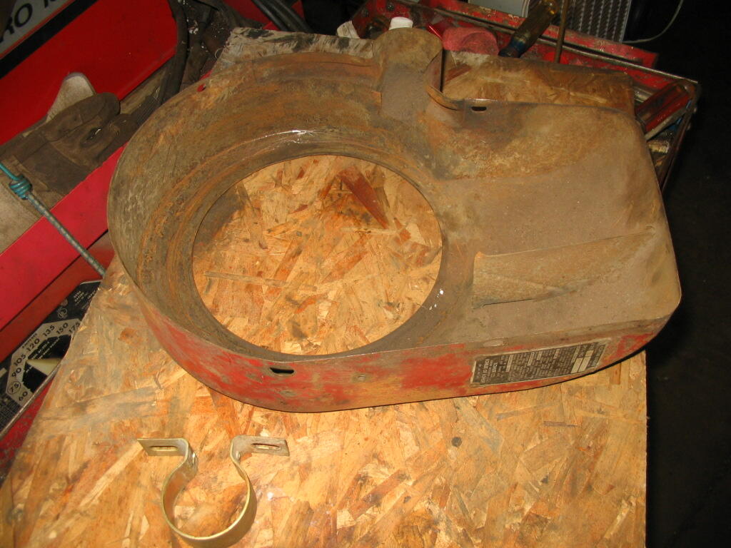

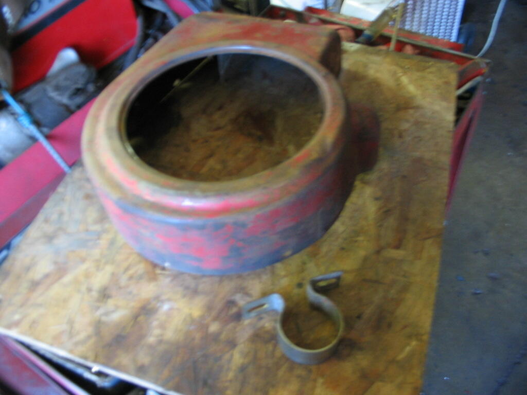

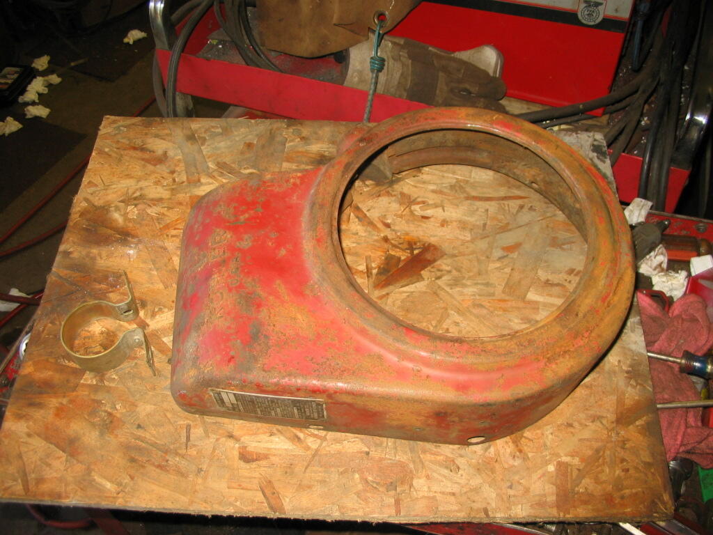

Wheelhorse#1 1,890 #1 Posted September 26, 2021 Hello all Since I’m rebuilding this motor a k301 . I thought I would give it a coat of paint too,something I don’t usually do much Anyhow all the tins are in great shape except this blower housing.I has pretty bad rust rot at the bottom where I guess rain settled in.Previous owner kept it outside. Anyone have any experience in how to repair damage like this ? Share this post Link to post Share on other sites

oilwell1415 563 #4 Posted September 28, 2021 That's not worth fixing. Eventually these parts will dry up and it will be, but not today. If it was just at the bottom it wouldn't be too bad to cut out the bad portions and weld in a panel, but since it's on the face as well it is a pretty complex repair. That's professional metal worker territory. 2 Share this post Link to post Share on other sites
Wheelhorse#1 1,890 #5 Posted September 29, 2021 Thanks for the offer on a replacement ,good price btw. Since I’m strapped for cash right now I decided to go ahead and try and half ers it. Im going to use mesh screen and bondo to patch it.It won’t be perfect but figure it will be close enough.Not looking for show quality on this one ,just better than it was. Already have the material . And since it’s mostly on the bottom won’t see it anyway.I’ll post a pic when done. I’ll replace it down the road after the filler falls out 😉 1 Share this post Link to post Share on other sites
Jeff-C175 7,207 #6 Posted September 29, 2021 (edited) 35 minutes ago, Wheelhorse#1 said: screen and bondo Think about fibreglas instead? Or even POR-15 and glas cloth! There are vids on YT that show plastic bumper cover repair using this method. It looks very promising. Given the circumstances it would be my go to choice for that. Edited September 29, 2021 by Jeff-C175 3 Share this post Link to post Share on other sites
AMC RULES 37,253 #7 Posted September 29, 2021 Whatever method you decide to try, make sure you build up your repair on the outside of the blower housing. Because your flywheel will be taking up all the available space on the inside. 3 Share this post Link to post Share on other sites
