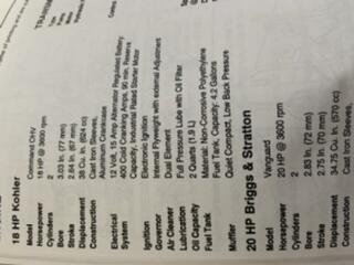

John2189 564 #1 Posted September 26, 2021 I have specs for an18 hp Kohler and a 20 b&s. The kohler has bigger bore a little less struck and more cu in than the b&s sorry the pic is sideway Share this post Link to post Share on other sites
ebinmaine 77,344 #2 Posted September 26, 2021 This is a question that has literally dozens of variables. Horsepower is a calculated figure based off measured torque. Many things influence HP. Engine configuration. (Flat, inline, V etc) Cam shape and timing. Intake and exhaust port shape and smoothness. Size of all the different components. Also very important is the fact that manufacturers will advertise HP that may not be exactly what the engine produces. Sooooo many answers... 1 Share this post Link to post Share on other sites
pfrederi 19,881 #3 Posted September 26, 2021 Partly marketing maybe??? Consider KT-17 and Magnum 18 identical engines except for ignition system... Share this post Link to post Share on other sites
John2189 564 #4 Posted September 26, 2021 18 minutes ago, ebinmaine said: This is a question that has literally dozens of variables. Horsepower is a calculated figure based off measured torque. Many things influence HP. Engine configuration. (Flat, inline, V etc) Cam shape and timing. Intake and exhaust port shape and smoothness. Size of all the different components. Also very important is the fact that manufacturers will advertise HP that may not be exactly what the engine produces. Sooooo many answers... Ok so I get the cam size and timing. So let’s say if it’s put on a dyno and levels out at let’s say 18.75 hp and it spikes at 20. They could say it puts out 20 hp? 1 Share this post Link to post Share on other sites
lynnmor 8,627 #5 Posted September 26, 2021 5 minutes ago, John2189 said: Ok so I get the cam size and timing. So let’s say if it’s put on a dyno and levels out at let’s say 18.75 hp and it spikes at 20. They could say it puts out 20 hp? You could say that is a 20 hp engine since it has a peak of 20. Manufacturers might use the figure that is produced at the engines rated rpm, usually 3600 on lawn and garden equipment. 1 Share this post Link to post Share on other sites

Skipper 1,790 #8 Posted September 26, 2021 What is also very much interesting is how the torque is made, because as Eric so well pointed out, the hp number is just a straight forward calculation, based on torque, rpm and a constant. That doesn't tell you the full story though, of the engines temper. The way it delivers that power. Is it a long stroked engine that delivers oodles of torque down low, or is a shorter stroke that bases it's power more on rpm. Therefor it is important to find an engine that delivers enough power, in a suitable manner, for the task at hand. 2 Share this post Link to post Share on other sites

Maxwell-8 4,370 #14 Posted September 28, 2021 (edited) Torque is what we use in lawn equipment engines. and why a 10hp diesel is stronger then a 10hp gas engine. (in our application) HP= TQ x RPM / 5252 TQ is in foot pounds engine's make more torque below 5252 rpm then HP, above that RPM they make more HP then torque. That's also why Lawn equipment enines make so little Horsepower for their displacement. They just don't rev to 6-7k RPM like a car or bike. (and they don't need to) Edited September 28, 2021 by Maxwell-8 Share this post Link to post Share on other sites
