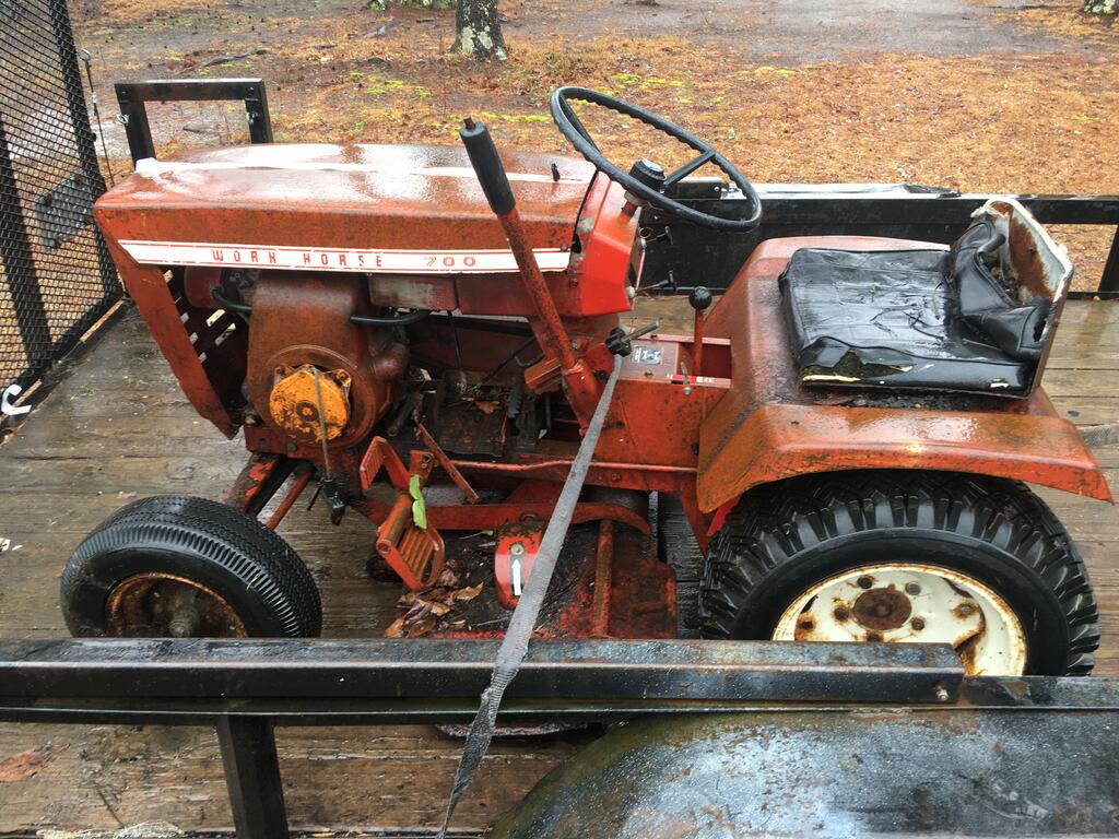

6wheeler 670 #1 Posted September 22, 2021 No pics yet. I just saw it at a consignment auction coming up on Saturday. I think it is a work horse 700. But? I need some info from you all. It has a Tecumseh engine with recoil and electric start. A 3 spd. Tranny. And? A 3 pulley pto drive. So far? So good. Now the question? The engine is white. It has the tank mounted on the engine. There is a half-moon notch cut into the left side hood, for the air cleaner to fit when the hood is closed. The air cleaner is oblong shaped. It looks like a factory cut-out. Because it is very smooth and matches the air cleaner perfectly. Did they come that way. Or do we have a repower situation? Either way. If the price is right? It will be on my trailer.😁😁😁😁😁 1 Share this post Link to post Share on other sites

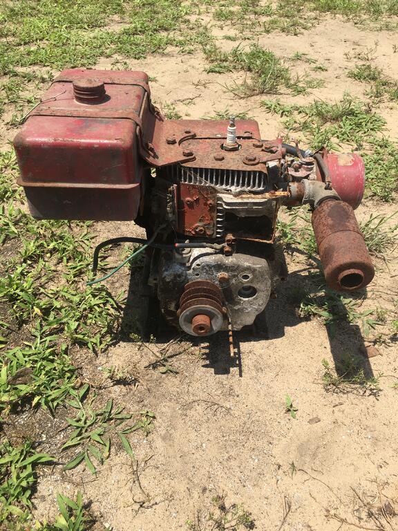

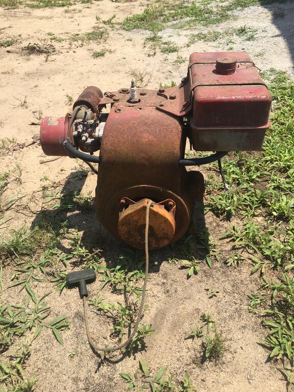

19richie66 17,765 #2 Posted September 22, 2021 Here is what the engine should look like. This came off a 700. If you get it and need engine parts, this is available. Don’t know anything about it except it turns over by hand. Never messed with it. Going Kohler 14hp. Share this post Link to post Share on other sites

Terry M-(Moderator) 2,266 #5 Posted September 24, 2021 Pat , that has been re-powered with a later Tecumseh engine . The hood was trimmed to fit around the air cleaner filter housing. Seen it done like that many times. My 606 originally came that way from the PO. It worked well but didn’t look original. Those newer Tecumseh engines were good running engines. So with that said, don’t let that stop you from getting it. just my 2 cents😎. Share this post Link to post Share on other sites
