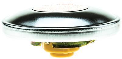

Darrell Mote 5 #1 Posted September 22, 2021 I’m trying to get a replacement fuel cap for a D180 wheel horse can someone help me out . I assume it has to be vented Share this post Link to post Share on other sites

squonk 43,939 #4 Posted September 22, 2021 I think it may be this: https://www.napaonline.com/en/p/BK_7031220?impressionRank=1 Share this post Link to post Share on other sites
Pullstart 67,030 #5 Posted September 22, 2021 12 minutes ago, squonk said: I think it may be this: https://www.napaonline.com/en/p/BK_7031220?impressionRank=1 yes it is, but the vent springs are too heavy for our little (well maybe just a non-fuel pumped) engines to drain the tank. By pulling the heavy spring out of the vent, it still holds fuel in but doesn’t hold it back. 3 Share this post Link to post Share on other sites
pacer 3,177 #6 Posted September 22, 2021 The cap is made by "Kelch" and (I think?) is called an 'eared' cap (because of the 1/4" turn) and seem to recall it is a 9" But. (theres that 'but') they are very difficult to find because of the 'eared', there are hundreds of sizes in threaded but the eared is rare. You might call or email them and ask about that ---- or just do a deep search for it on the bay, My last attempt I thought I had found one and ordered it but came in with threads .... so, I just took my dremel and chewed off the threads til it would 'force' fit the tank, worked pretty good. Also the 2-3 I have found were NOT vented, but a 1/16" drill fixed that. Share this post Link to post Share on other sites
Achto 29,420 #7 Posted September 22, 2021 (edited) Real simple solution, if it is an eared cap.. Harley Davidson used the same eared fuel cap on their Shovel Head models. The right cap was vented and the left was not on the big twins, make sure you get the vented cap. Tanks on Harleys were gravity fed only so no reason to make any type of adjustment to the cap after you buy it. Readily available from many aftermarket vendors. One source. https://www.denniskirk.com/drag-specialties/original-style-gas-cap-w-vent-ds-390130.ph18199.prd/H18199.sku?gclid=EAIaIQobChMI55CDqNmS8wIV4W1vBB3tTgo0EAYYAyABEgIIevD_BwE Edited September 22, 2021 by Achto 2 Share this post Link to post Share on other sites
Darrell Mote 5 #8 Posted September 22, 2021 Thanks guys I got a cap at my local NAPA store and took the large spring out like the video shows . Looks great. 3 1 1 Share this post Link to post Share on other sites
