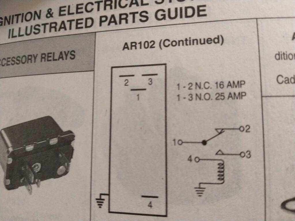

ebinmaine 80,304 #26 Posted February 27, 2022 1 hour ago, squonk said: # AR102. 12 V + to terminal #4. Case is grounded. Pump wires to terminals 1&3 Nothing on number three? What does that one do? Share this post Link to post Share on other sites
squonk 47,890 #27 Posted February 27, 2022 (edited) 14 minutes ago, ebinmaine said: Nothing on number three? What does that one do? Sorry Eric I goofed. (It's hell to get old! ) 12V+ from the battery to terminal #1 Power from the key switch to terminal # 4. Pump power wire to terminal # 3. At rest the relay contact is at # 2 which means if terminal 1 is hot then terminal # 2 is hot also with no power being applied to terminal #4 (Coil posititve) When you were to turn the key on Power is applied to terminal # 4. The coil energizes and creates a magnetic field. This pulls the contact from the # 2 terminal and applies it to # 3. The fuel pump positive wire is connected to # 3 and power now flows to the pump. No wire is attached to the #2 terminal. Edited February 27, 2022 by squonk 1 Share this post Link to post Share on other sites

ebinmaine 80,304 #36 Posted February 27, 2022 7 hours ago, squonk said: Sorry Eric I goofed. (It's hell to get old! ) 12V+ from the battery to terminal #1 Power from the key switch to terminal # 4. Pump power wire to terminal # 3. At rest the relay contact is at # 2 which means if terminal 1 is hot then terminal # 2 is hot also with no power being applied to terminal #4 (Coil posititve) When you were to turn the key on Power is applied to terminal # 4. The coil energizes and creates a magnetic field. This pulls the contact from the # 2 terminal and applies it to # 3. The fuel pump positive wire is connected to # 3 and power now flows to the pump. No wire is attached to the #2 terminal. Thanks for that Mike. Ordered. 1 Share this post Link to post Share on other sites
