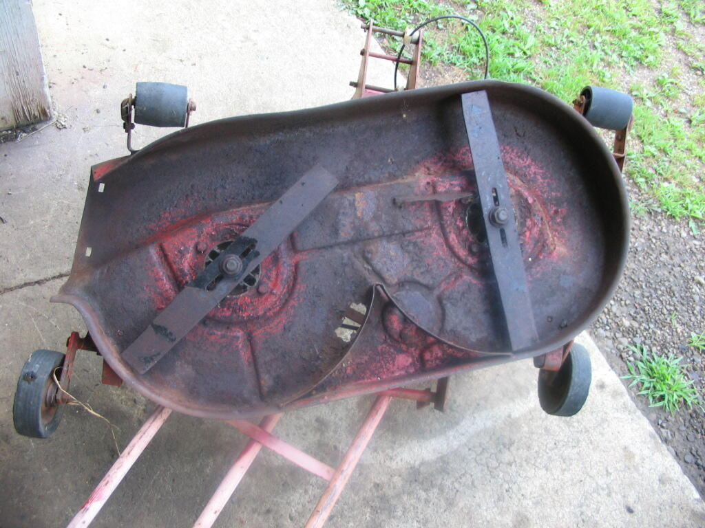

David414 323 #1 Posted September 21, 2021 Rebuilding a 1990, 37" side discharge deck, model 05-37SC02. Does anyone have cross reference numbers for the ball bearings #109966 used in the housing spindle? Trying to find substitute bearings other than the Toro $12.22 supplied bearings? Also substitutes for pulley idler #111170 @ $60, and Pulley-flat idler B @ $148. Toro prices are just mind blowing. Blades #109079, substitutes? Thanks! Share this post Link to post Share on other sites

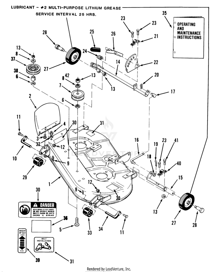

daveoman1966 3,884 #2 Posted September 21, 2021 (edited) NOTE...Most of the pulleys from your 05-37SC02 and my 05-37MS05 are identical...as are the spindle bearings. Is this the IDLER pulley you need (#7) 111170...it is 4-1/4" dia. I have 2 or 3 good used ones for $20 each. I don't get what 'Pulley-flat idler B' is supposed to be. Which pulley is it in this schematic.????? ps... I have abox full of good used pulleys from Wheeelhorse decks & I'm sure I have this...what diameter is it??? Are these accep[table blades...they are from a 37" deck. $20 for the blades...sharpened and ready to cut. Spindle bearings 109966... I can send you 4 of them NEW for $25 $12 otter cover the ship charge on this stuff.... Edited September 21, 2021 by daveoman1966 1 Share this post Link to post Share on other sites

daveoman1966 3,884 #4 Posted September 21, 2021 10 minutes ago, packingheatcgb@aol.com said: Will these spindles work on a 80 wheel horse with 37" deck? I'm having a hard time finding double d 108171 blades I don't see a 1980 37" deck, but I did find the schem,atic of a 1981 37" deck with DD spindle blades. Inasmuch as the deck SHELL is essentially unchanged, my answer would be YES... Share this post Link to post Share on other sites
