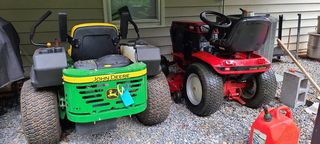

Matash 15 #1 Posted September 19, 2021 Has anyone had the issue were your mower would sputter or misfire when the mower hits a bump ? This thing has me stumped. I really dont like using my other mower cause it just sucks. thanks Matt 20210917_164039_Trim.mp4 Share this post Link to post Share on other sites
