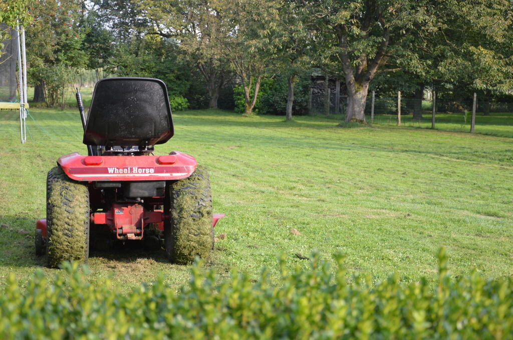

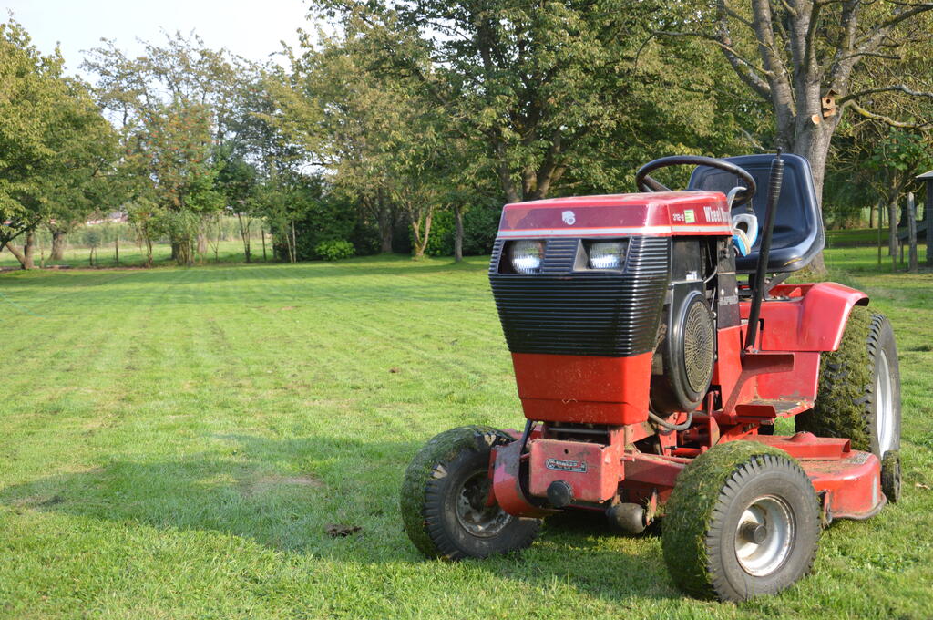

Maxwell-8 4,367 #1 Posted September 16, 2021 (edited) I sold my 312-8 to my aunt cause she needed a mower, didn't wont her to buy some new not so good mowers No real complains other then all those grass clipings. So she wanted a mulcher since bagging ain't an option. Well I gave it a shot and I think it came out good, test day is saterday so hoppefully it's gone work too. Edited September 16, 2021 by Maxwell-8 6 Share this post Link to post Share on other sites
Maxwell-8 4,367 #2 Posted September 19, 2021 I would call it a succes! 1 Share this post Link to post Share on other sites

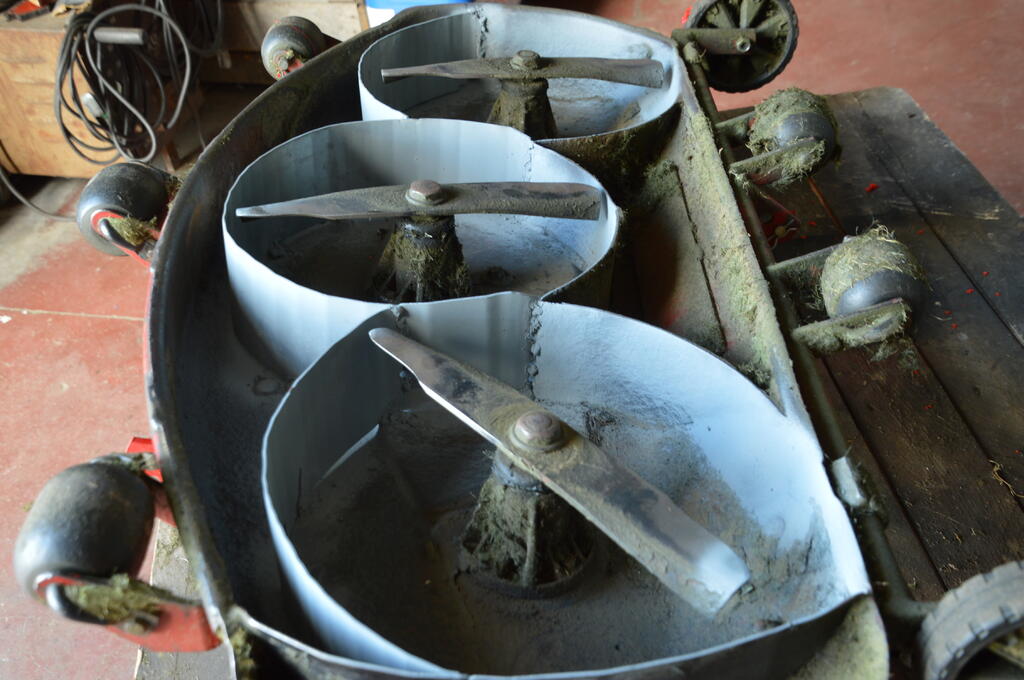

Maxwell-8 4,367 #3 Posted September 19, 2021 How I made it: the red lines show the plates I welded in (not stock) Mesured how high the steel has to be bottow of the deck to the blades, I believe 12cm. mesured the needed lengtes. Got me a big galvanized plate and cut it out with our big old plate scissor. And shaped it our big vice, and welded those in after latst of test-fitting, trimming and adjusting the curve of the metal. and then painted against rust. 1 Share this post Link to post Share on other sites
Sewman 20 #4 Posted September 28, 2021 Good job,I'd like to do it to mine. 1 Share this post Link to post Share on other sites
