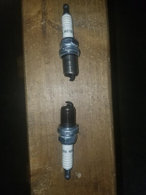

MerkedTrick 2 #10 Posted September 15, 2021 (edited) Just checked compression...left side reading 145 and right side reading 150. The manual says it should be 160. Is that my problem? It doesn't seem like much if a difference but I'm not that versed in these engines. Ordered an inline spark tester and will update in how that goes....dreading having to pull the engine out again. Here is what the spark plugs look like. Top is right side (150 psi) bottom is left side. (145 psi). I think this is leading me to an intermittent spark from the coil on the left side. Edited September 15, 2021 by MerkedTrick Share this post Link to post Share on other sites

JoeM 9,621 #12 Posted September 15, 2021 (edited) 2 hours ago, MerkedTrick said: Maybe a wire got loose. what was the gap on your coils? I use .010 A dollar bill folded in two is just about right. Sure seems like the left side is struggling. Those compression reading I would take that all day long on an 1100 hour machine Edited September 15, 2021 by JoeM Share this post Link to post Share on other sites

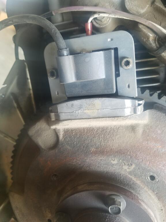

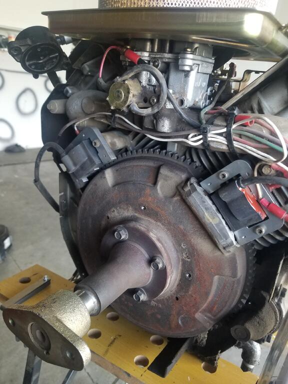

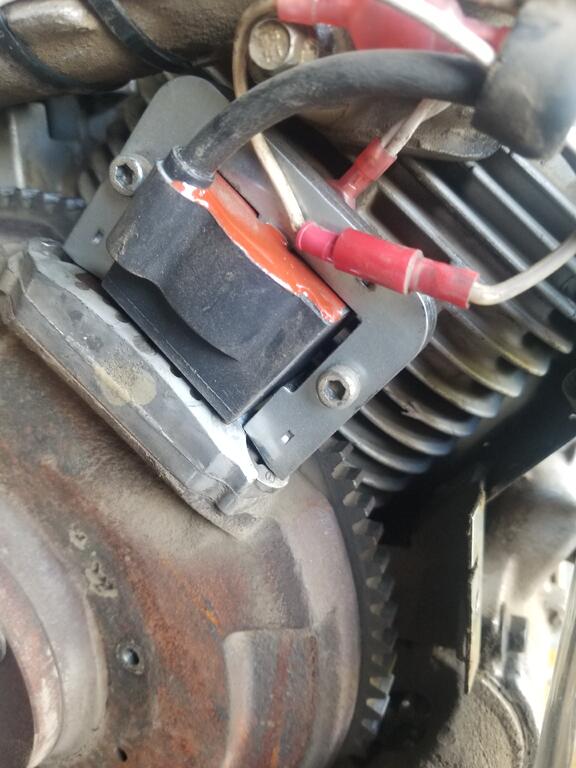

MerkedTrick 2 #14 Posted September 15, 2021 (edited) Got the motor out and all the wiring seems fine and tight but.......the flywheel air gap on the left side was pretty tight. I could not fit a .28mm feeler gauge in between the sides of the coil. The flywheel turns free and does not hit the coil at all. Could this be the issue? The 3rd picture is the left side. The right side is gapped to .30mm. Edited September 15, 2021 by MerkedTrick Share this post Link to post Share on other sites
JoeM 9,621 #15 Posted September 15, 2021 They should be right on. like I said, I mic a piece of paper and put it between the coil and magnet with screws loose and let the coil rest on the paper then tighten the screws. A doubled up dollar bill is .010. .25mm, might try a business card some of those are just right. I have had them set to close and did not run right. I would also check the ohm value between the plug wire and steel laminations. I am thinking 2.5 to 5K ohms is a good reading. Might wiggle the spark plug wire while doing the test to see if there is any fluctuation. Share this post Link to post Share on other sites
MerkedTrick 2 #16 Posted September 16, 2021 (edited) Checked ohms. Warning, not an expert at this. Left side boot to ground : 3.86 Ground to kill wire: 15.05 Right side: Boot to ground: 3.93 Ground to kill wire : 15.06 Gapped the coils with .30mm feeler gauge/triple checked all connections. Giving it a try tomorrow...... Edited September 16, 2021 by MerkedTrick 1 Share this post Link to post Share on other sites
JoeM 9,621 #17 Posted September 16, 2021 Numbers seem good. Now wondering if the magnet is not strong enough on the flywheel. I have not seen any procedure for that test. Clean those plugs up with some carb cleaner too. Your probably getting like a nascar crew taking the engine out. I know now I can get it in under an hour. I have done a couple rear seal changes. Share this post Link to post Share on other sites
