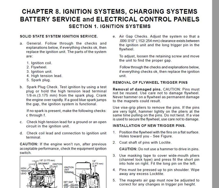

pfrederi 18,624 #4 Posted September 15, 2021 Have you tried this basic spark test (b.) Use some insulation to hold the wire you could get a real jolt Share this post Link to post Share on other sites
