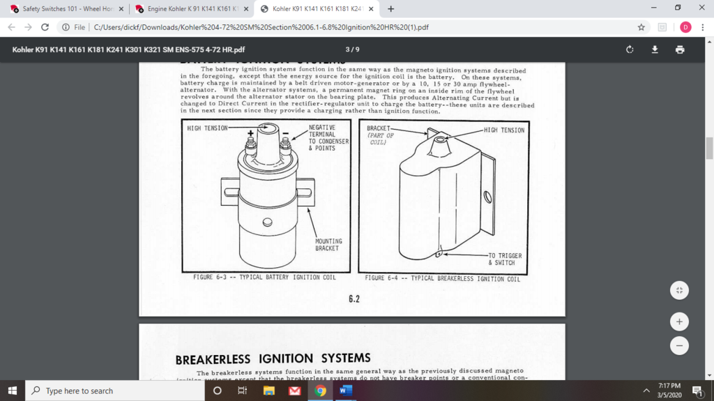

953 nut 63,893 #5 Posted September 13, 2021 Kohler K-241 charging system Are you sure the engine is a K-241? Could it be you have a 10 HP Magnum? Do you have ignition components that look like either of these? Share this post Link to post Share on other sites

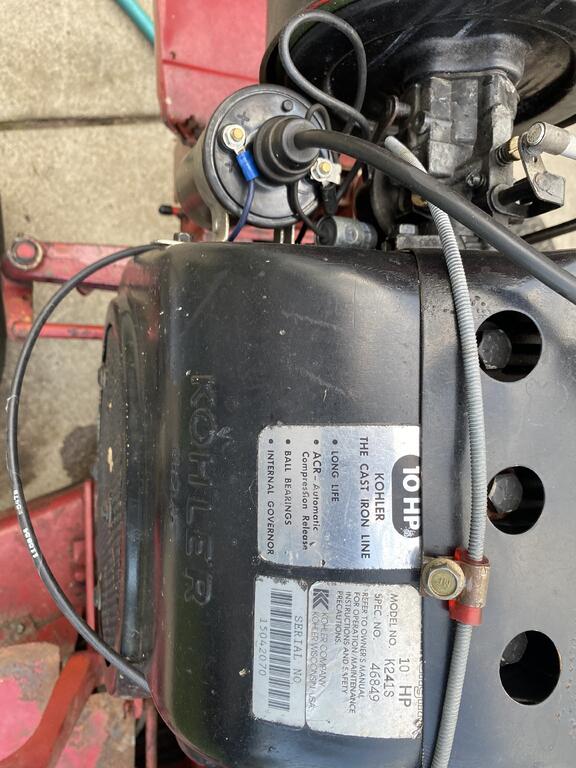

FrankinWNY 12 #8 Posted September 14, 2021 11 hours ago, Gregor said: Is this on a tractor? What tractor? Spec number on motor? 310-8 not original motor K-241 spec 46849 Share this post Link to post Share on other sites
FrankinWNY 12 #9 Posted September 14, 2021 On 9/13/2021 at 11:10 AM, pfrederi said: Good point Gary. He may have a magneto igniting (or even Breakeless) Spec 46849 Share this post Link to post Share on other sites
gwest_ca-(File Mod) 11,970 #10 Posted September 15, 2021 Have never been able to find an illustrated parts list for the K241-46849 but it is listed as the original engine in 1985 310-8 model 21-10K801. Kohler made serial number 15042070 in 1985. Share this post Link to post Share on other sites
