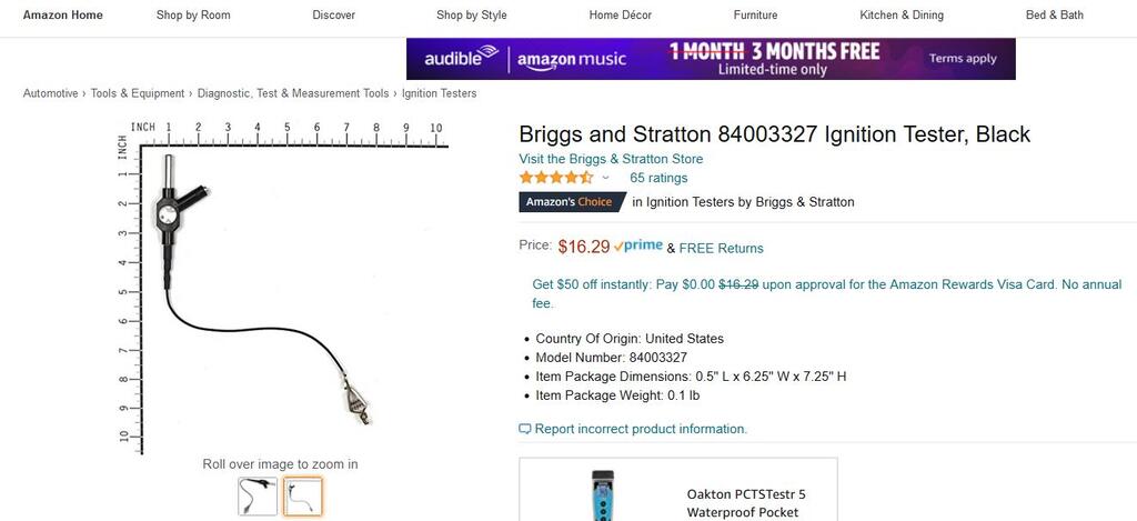

pfrederi 20,062 #10 Posted September 13, 2021 If you plug is wet with gas and you have compression you have a spark problem. Could be a bad wire or defective plug (I stopped using Champion some time ago as they would spark laying on the head but not under compression.) I also have several of teh cheap Harbor Freight neon s[park tester. They will show a flash but there is not enough juice to fire the elug, One of these B&S testers will give you a more accurate assessment of you igniton power 1 Share this post Link to post Share on other sites
