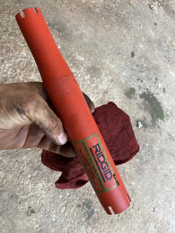

slim67 2,822 #1 Posted September 12, 2021 I was replacing the axle shaft seals on my Raider 10 last week and looked around the house for something to drive them in evenly. I found a basin wrench that fit over the 1-1/8 shafts perfectly after cleaning the shafts up with a scotch lock pad. Just gently tapped them in. 3 2 Share this post Link to post Share on other sites

953 nut 62,032 #3 Posted September 12, 2021 I have a few scrap pieces of PVC that fit the 3/4" , 1" and 1 1/8" seals. They are Sch. 40 3/4". Sch. 80 1" and Sch. 40 1" if memory serves me right. 1 2 Share this post Link to post Share on other sites
roadapples 6,985 #4 Posted September 13, 2021 1 hour ago, 953 nut said: I have a few scrap pieces of PVC that fit the 3/4" , 1" and 1 1/8" seals. They are Sch. 40 3/4". Sch. 80 1" and Sch. 40 1" if memory serves me right. Yup, that's what I use... But like Eric said, use what ya have... 1 Share this post Link to post Share on other sites
