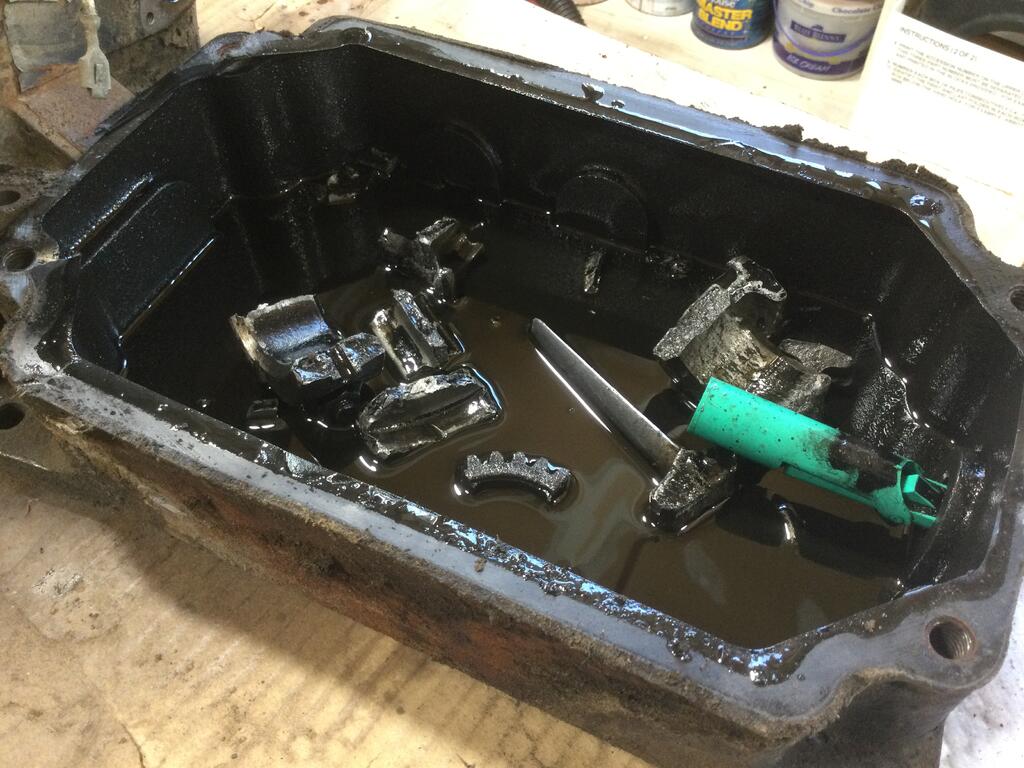

richmondred01 2,311 #3 Posted September 12, 2021 (edited) The balance gear failed on this engine. It happens often especially when the engines are over 1000 hours or weren’t maintained. Things wear out at that age. I only leave them in on the m16 engines and I always press new needle bearings in and triple check the tolerance. Depending on the hours and maintenance history, I personally would pull them during rebuild however, that’s just my opinion. Would I specifically, tear down the engine to just remove them, no. But if you have 800-1000 hours on the engine, it may be time for a rebuild anyway. Edited September 12, 2021 by richmondred01 1 Share this post Link to post Share on other sites
