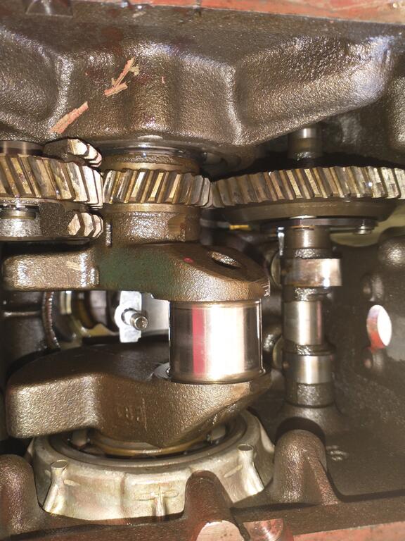

squonk 45,534 #2 Posted September 11, 2021 I use Rotella 30W from tractor Supply in everything. Look how clean the inside of this engine was at 1000 hours. Piston broke but the engine still ran! 5 6 Share this post Link to post Share on other sites
aemsee 93 #3 Posted September 11, 2021 10 minutes ago, squonk said: I use Rotella 30W from tractor Supply in everything. Look how clean the inside of this engine was at 1000 hours. Piston broke but the engine still ran! many thanks. Trip to TSC tomorrow for me 2 Share this post Link to post Share on other sites
