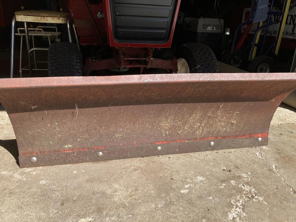

CCW 1,379 #1 Posted September 5, 2021 (edited) The scrapper blade on my 312-8's plow is worn on the outside corners from years of my father plowing the driveway. The top edge is still original. Can it be flipped over? ccwpost Edited September 5, 2021 by CCW Share this post Link to post Share on other sites

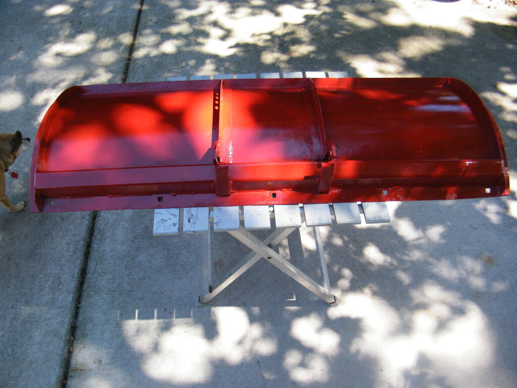

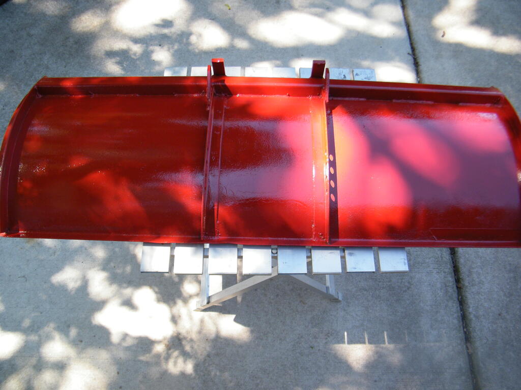

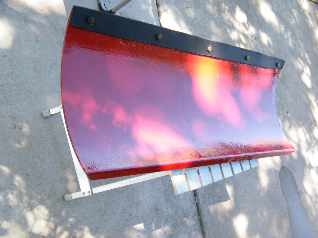

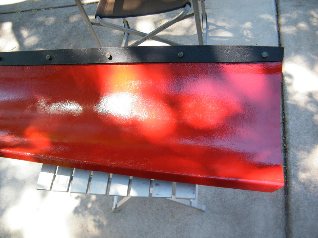

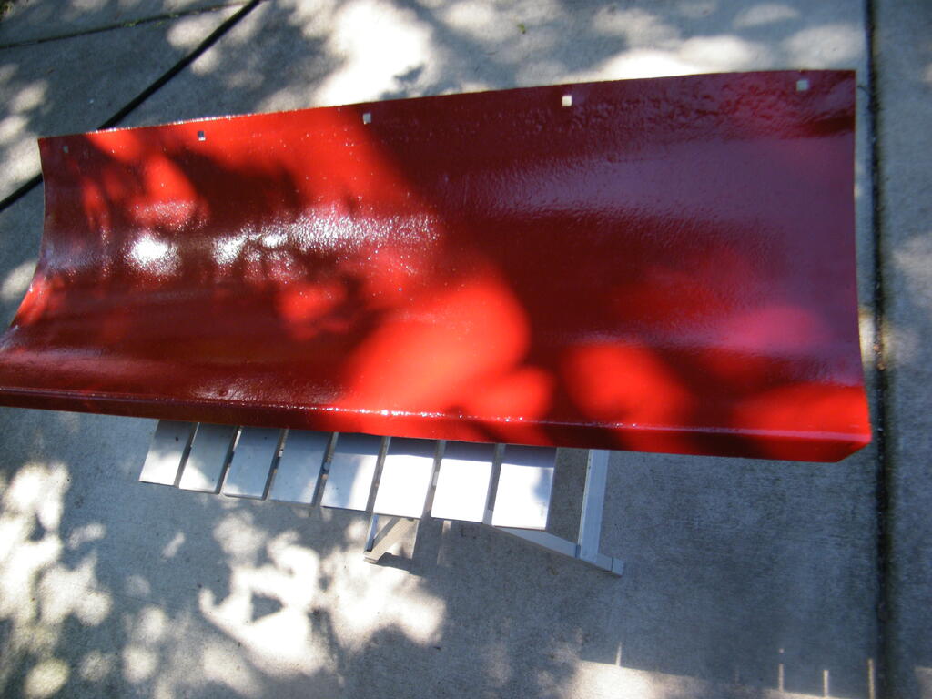

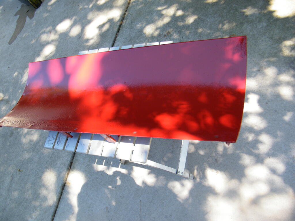

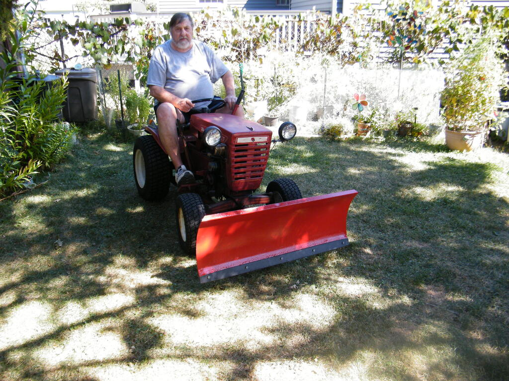

stevasaurus 23,281 #7 Posted September 6, 2021 Mine was rusty like yours. It would not let the snow go when pushing it. I used a 4" grinder with a wire wheel, cleaned off the rust, primed with Rust Oleum red primer. I used a 3" roller and Regal Red in a qt can along with a brush to paint. Painted the scraper flat black a flipped over. Pictures... 1 Share this post Link to post Share on other sites
