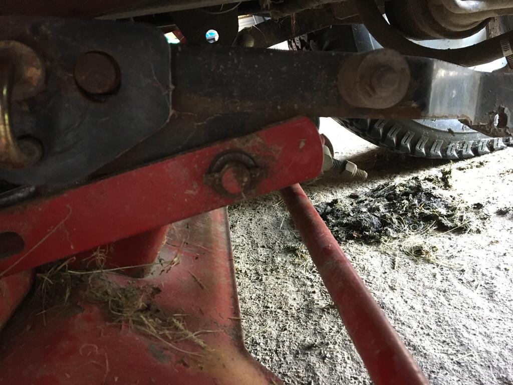

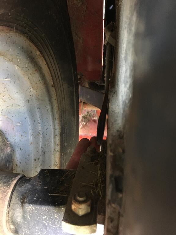

SunHeart 0 #1 Posted September 4, 2021 Hi All, I'm a relatively new (4 months) owner of a 2000 522xi. The belt connecting the motor and deck recently went, and as I was replacing it I noticed that a piece that connects the rear of the deck to the rear frame is not connected! There seems to be a bolt and/or nut missing. Below are some pics. What is missing? Where can I get it? Part #? It is on the left side (if looking from the rear). First pic is the assembly where it meets the mower deck. Second pic is where it should connect to the rear frame. There is a hole there for a bolt/nut. On the other side it looks like a bolt, but I can't see if it screws in or what, or is supposed to go all the way through and then nut? Any help appreciated! Thanks. Share this post Link to post Share on other sites
gwest_ca-(File Mod) 11,995 #2 Posted September 4, 2021 Welcome to Red Square. Do you know the model number of the deck? Trying to find an illustration https://www.partstree.com/models/78370-toro-52-side-discharge-mower-deck-for-5xi-garden-tractors-sn-200000001-200999999-2000/deck-suspension-assembly-2/ Garry Share this post Link to post Share on other sites
JoeM 9,606 #3 Posted September 5, 2021 Look like you need part 6 and the self locking nut 1 Share this post Link to post Share on other sites
