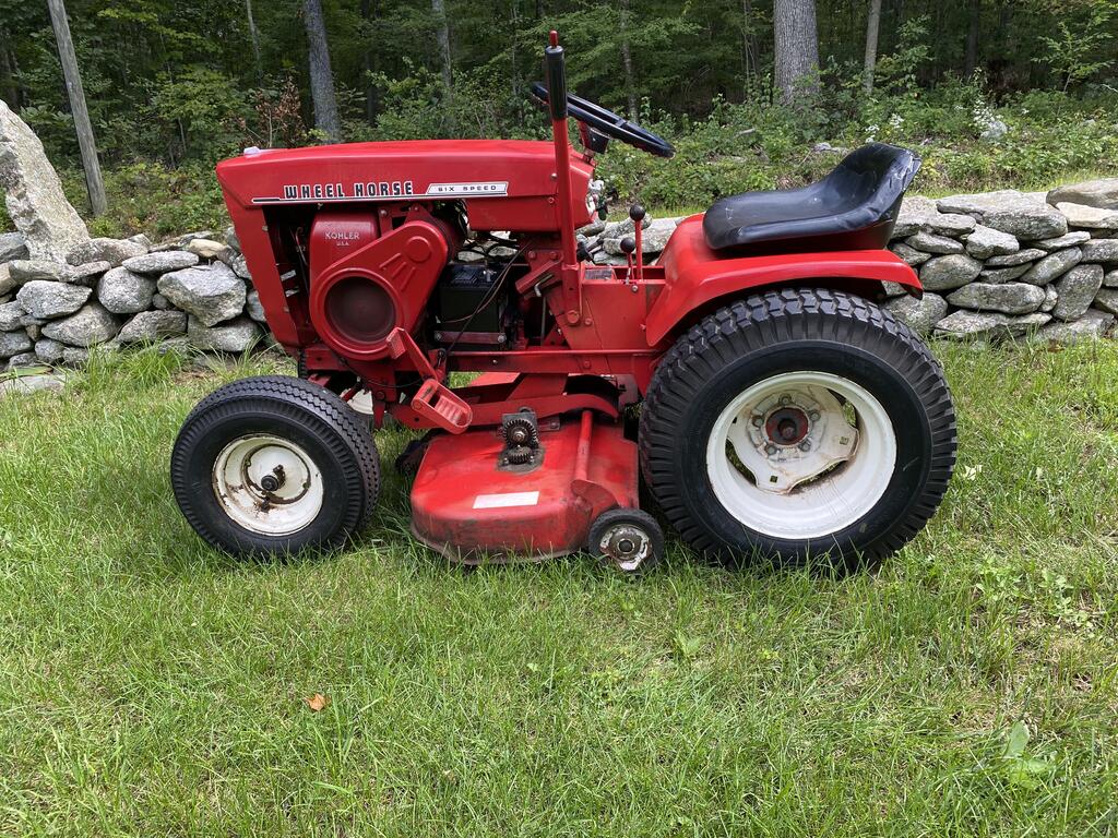

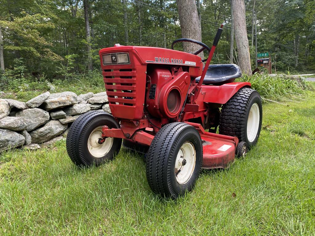

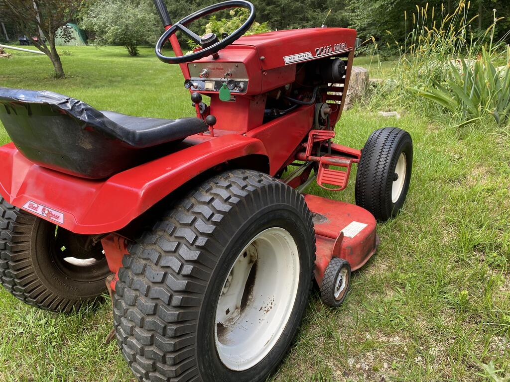

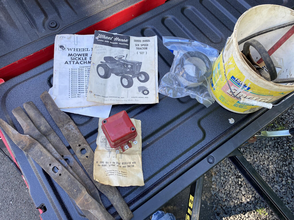

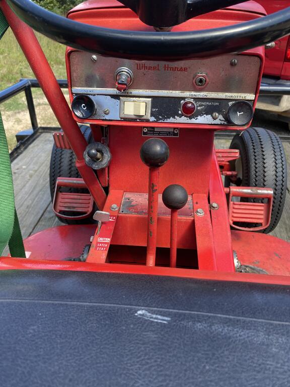

Sparky-(Admin) 24,750 #1 Posted September 3, 2021 Found this 867 for sale an hour from home. Original owner, came with paperwork and a bucket of spare parts, old belts etc. Also new in a canvas bag were tire chains bought for it but never installed. On the ad I could see it was original paint, but when I arrived the elderly gentleman thought he had done me and the tractor a huge favor and shot the top of the hood and fender pan with rattle can red . The new paint is only a week or two old and wasn’t painted onto the decals. I’ll be looking for thoughts on getting it off if you have any. Obligatory pics… 5 9 1 Share this post Link to post Share on other sites

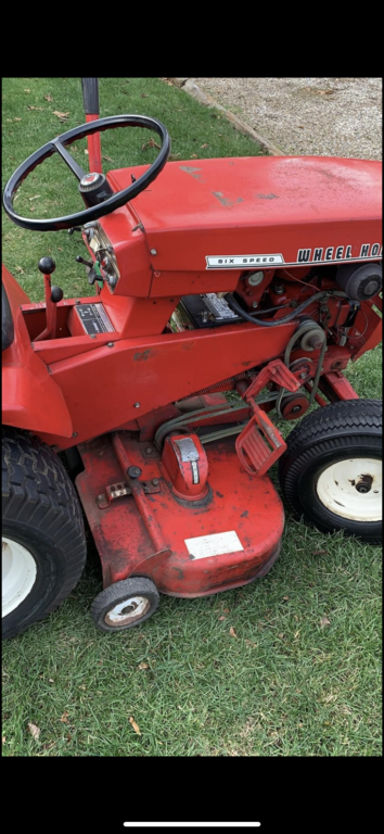

squonk 45,791 #10 Posted September 3, 2021 3M Microfinishing Compound and a buffer. Then Meguiers Swirl remover. Once you get his paint off you may see why he painted it and wish you left it. 2 Share this post Link to post Share on other sites
ebinmaine 77,769 #11 Posted September 3, 2021 3 minutes ago, squonk said: . Once you get his paint off you may see why he painted it and wish you left it. I was wondering about that too. Sparky is the old paint surface rough under the new paint or does the new paint look okay as far as smooth surface and shine? 1 Share this post Link to post Share on other sites

Sparky-(Admin) 24,750 #13 Posted September 3, 2021 1 hour ago, squonk said: 3M Microfinishing Compound and a buffer. Then Meguiers Swirl remover. Once you get his paint off you may see why he painted it and wish you left it. Here’s the hood as I saw it in the ad…It had factory paint with a few blemishes. I’m good with blemishes 3 Share this post Link to post Share on other sites

Retired Wrencher 6,515 #21 Posted September 4, 2021 Looks pretty nice Mike. Clean for it`s age. The left hub has to adjusted maybe with a new seal. I like the looks of those old start gens. Enjoy it. 2 1 Share this post Link to post Share on other sites
