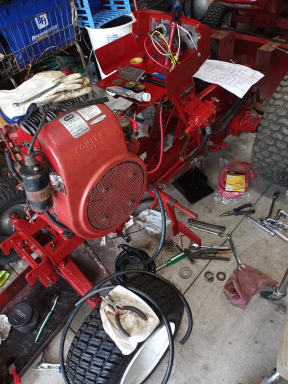

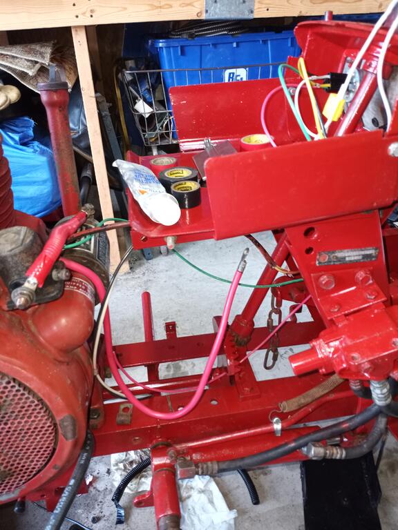

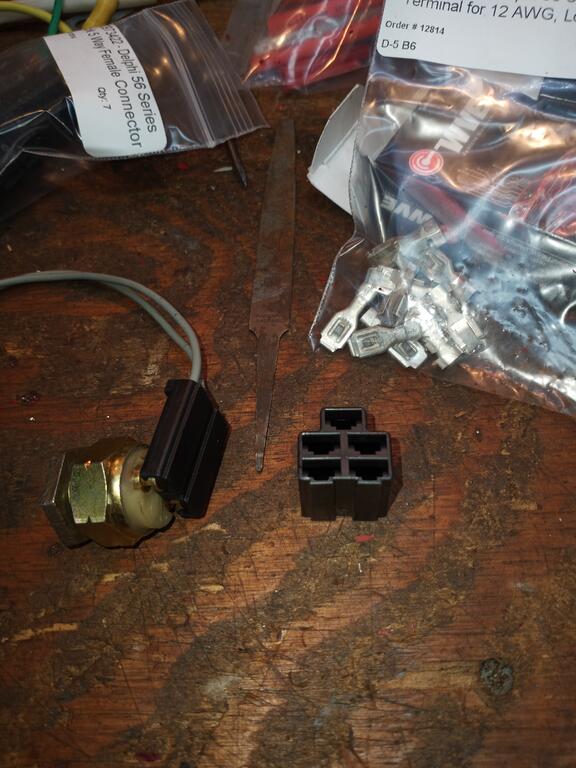

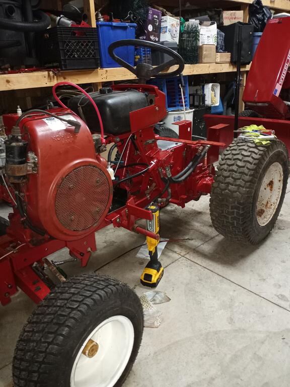

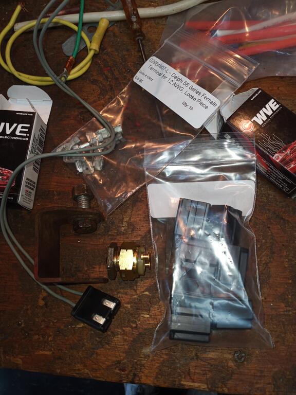

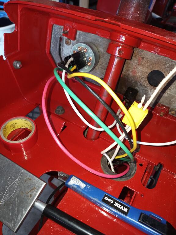

BOB ELLISON 2,983 #33 Posted September 26, 2021 I'm back at it again, had to stop working on it for a few days because I lost one of my best friends. He was the assistant Pastor of my Church. One of the nicest persons I have ever known. I'm starting to wire up the old girl trying to get it running by next weekend. I had to order a carb from isavetractors.the carb on it was for a 10hp engine and even though it did run ok im sure it didn't use all the power it had because of it. And some electrical connectors from CustomConnectorKits. they had the delphi 56 series connectors. I did over order on the 5 post ignition switch connector so I may have to give some away for Christmas gifts. Haha. I ordered 7 of the 5 post and 10 of the female connectors. I decided to install the brake switch for safety reasons I ordered 2 of them and the connectors. ill put one on my first c160 after I get this one up and running. I don't need one for the PTO because I don't use it. 6 Share this post Link to post Share on other sites

ebinmaine 80,765 #35 Posted September 26, 2021 11 hours ago, EB-80/8inPA said: Very sorry to hear of the loss of one of your best friends, Mr. Ellison. Agreed. My condolences. Excellent work on the wiring there. 1 Share this post Link to post Share on other sites

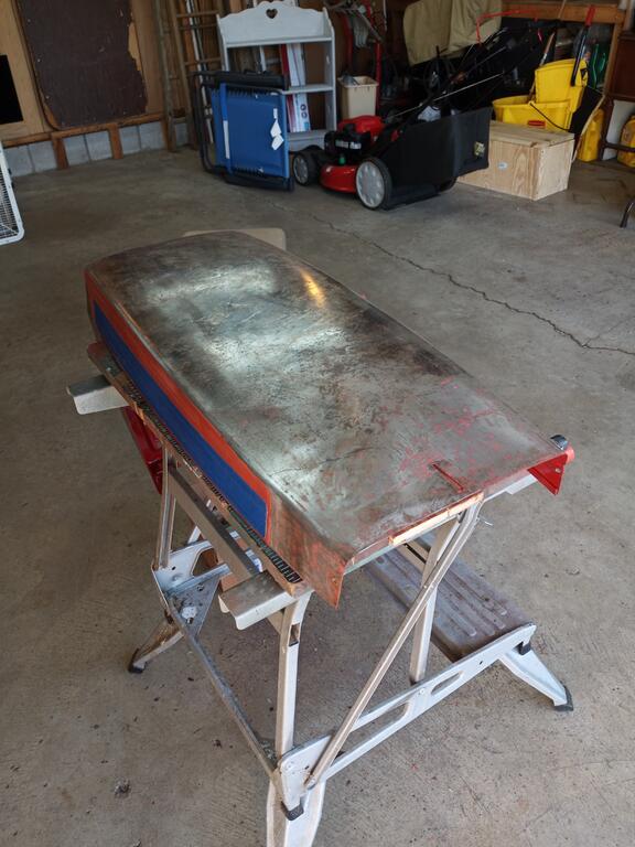

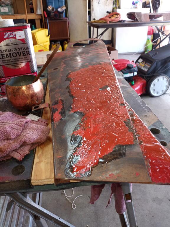

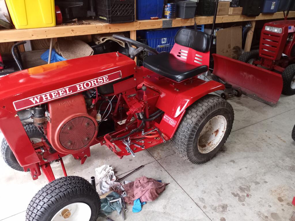

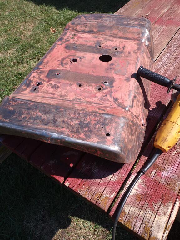

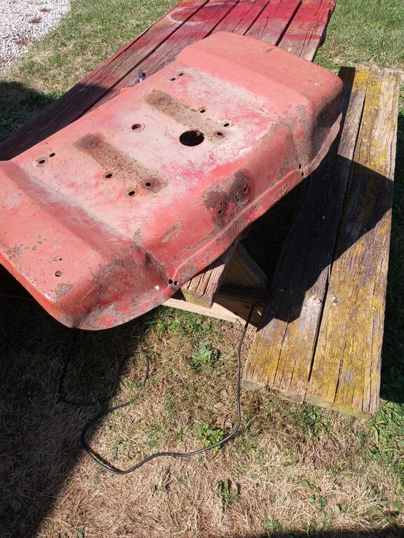

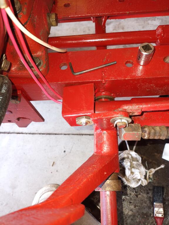

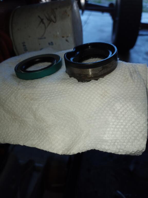

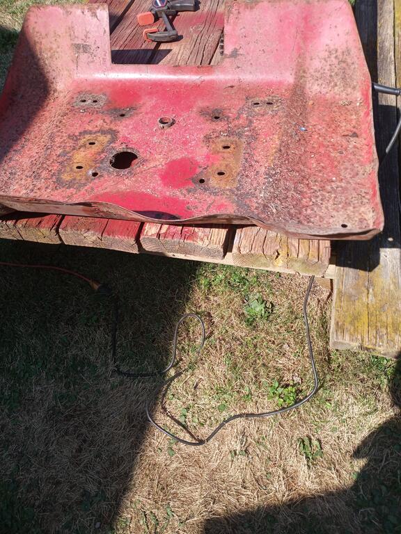

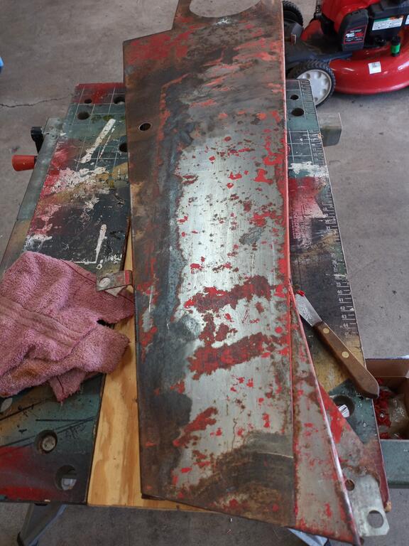

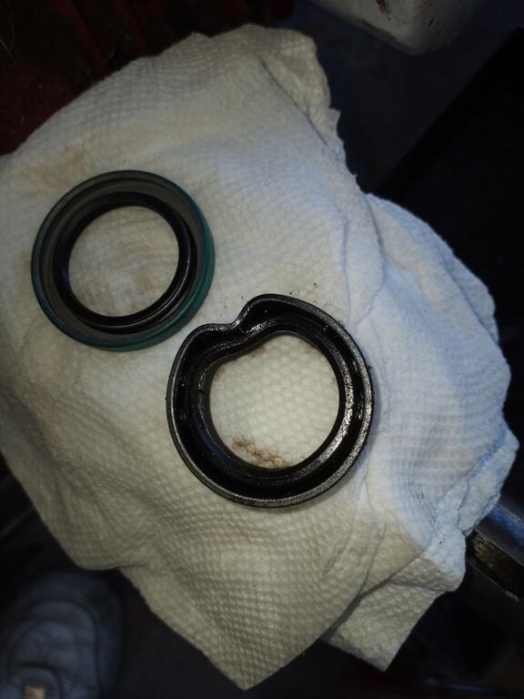

BOB ELLISON 2,983 #36 Posted September 29, 2021 I'm back at it again today trying to get it back together. I did finish the electrical and I got the right axle seal replaced. This was the biggest oil seal I've ever seen. The replacement seal is less then half the size. There was so much trans fluid on the hub that it was easy to remove and hub and shift were in great shape. I striped the paint off the finder,foot rests and belt cover. The paint was so thick on the belt cover I had to use paint stripper to get it off. How can anyone bend up the back of the finder that bad. I have some welding on the finder because the holes are braking apart from the bolts. 5 4 Share this post Link to post Share on other sites

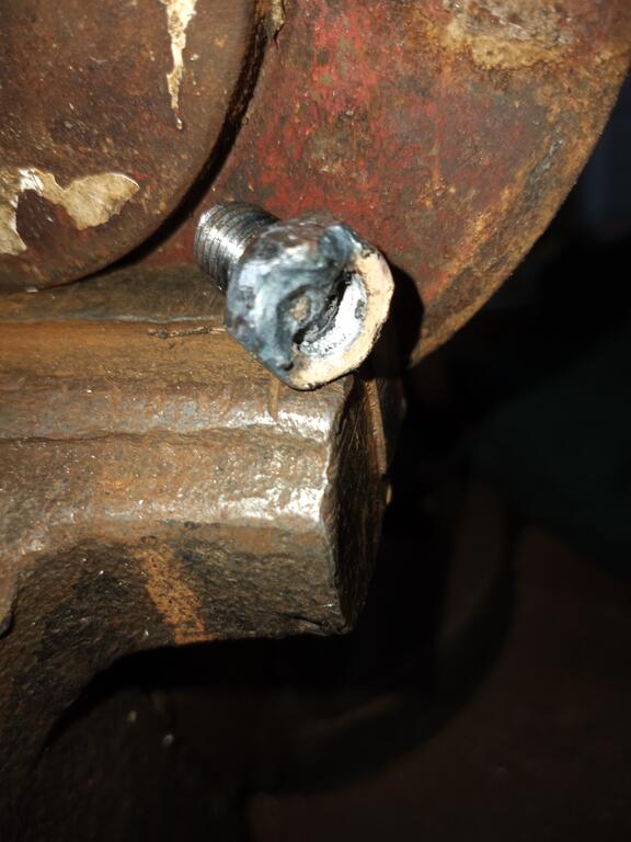

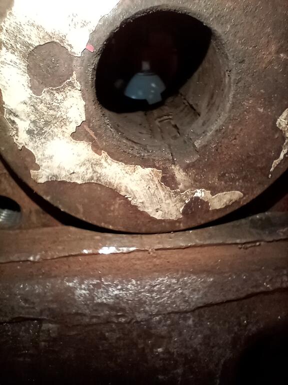

BOB ELLISON 2,983 #37 Posted September 30, 2021 Working again on the old girl. The c160 you dirty minded people. I got most of it painted except the hood I don't know if I'll have enough warm weather to get it done. Anyways I did get the right axle seal replaced and whoever tried to fix it put a woodruff key on that was to small so they put a piece of wire to raise it up. so I decided to check the left and it's a good thing I did the hub moved 1/4inch both ways with out moving to axle the nut screwed off a threaded stud. "Figure that out". So I had to weld the nut to the stud and it did come out. The hub came off easly with my gear puller. The hub will have to be replaced but it didn't hurt the axle or the woodruff key. Now I'm looking for a 1 1/8" hub Anyways a few pictures 4 1 1 Share this post Link to post Share on other sites

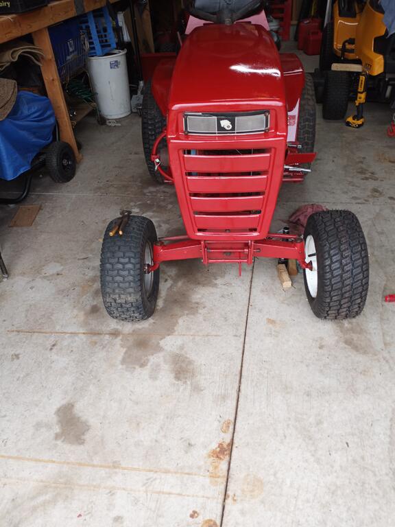

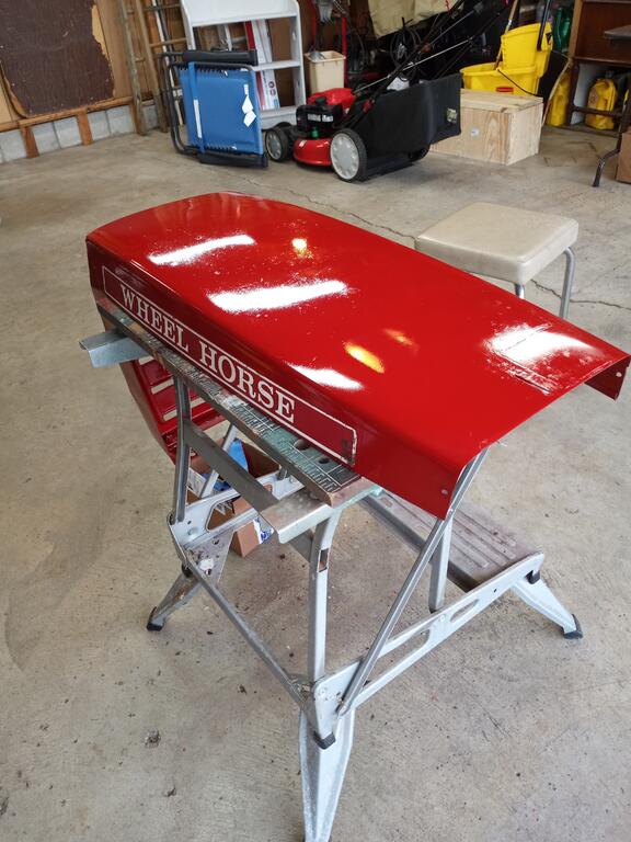

BOB ELLISON 2,983 #38 Posted October 3, 2021 Well moving right along. All the electrical is done. New carb and throttle and choke cables. Got everything painted even the hood. I got a hub. Its the little things that takes so long. I do have to confess I cheated on the painting. I got a quart of regal red and brush painted the undersides of the finder,belt cover and hood. But they look pretty good. I just had to stop the rust. The hood really doesn't look that good because I didn't prime it first. The old paint was so thick a wire wheel took forever to get it off. and but I waited to long to start on it. I hope to have it running by next week. 11 1 Share this post Link to post Share on other sites

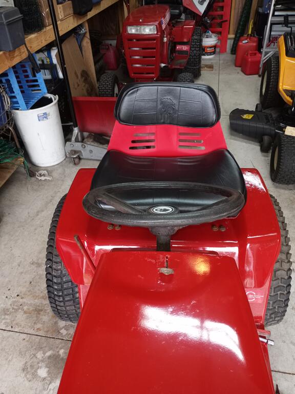

BOB ELLISON 2,983 #39 Posted October 8, 2021 Finally got it done. I tried to get it started for the first time in 3 years and I turned the key and nothing. So I had to get the ohm meter out to find the problem. I decided to use the amp gage to see if it was charging and sure enough it was dead. I had another gage from my 74 c160 that was working ok before I changed it to a voltage gage. Well this time after about 2 seconds it fired up and runs great. And I decided to install the only seat i kept and made. Everything works and no more rust except for a few bolts I reused. Im very happy with my C160's. 1 6 1 Share this post Link to post Share on other sites

rjg854 13,380 #44 Posted October 8, 2021 Great job, Bob. That seat looks fantastic on there, I wonder who made that. 1 1 Share this post Link to post Share on other sites
chip61 666 #45 Posted October 8, 2021 2 hours ago, rjg854 said: Great job, Bob. That seat looks fantastic on there, I wonder who made that. Still kicking myself for not buying one for my C160!! Tractor looks great!! 1 Share this post Link to post Share on other sites
BOB ELLISON 2,983 #46 Posted October 8, 2021 9 minutes ago, chip61 said: Still kicking myself for not buying one for my C160!! Tractor looks great!! I loved making the seats for the lawn ranger and the 1054/953 but the c160 seats were a lot more work. Maybe someday someone will bring them back and start making them again. 1 Share this post Link to post Share on other sites

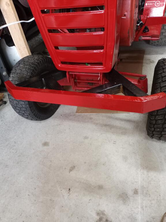

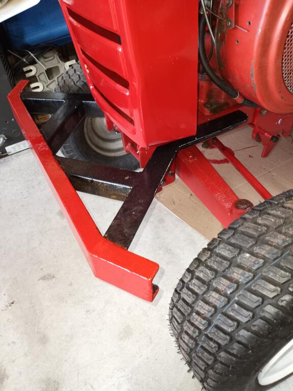

BOB ELLISON 2,983 #49 Posted October 10, 2021 I got my bumper back on the 77 c160. This came on my 1974 but I removed it for my plow. I wasn't sure if the plow would work with it on so I put it in my storage garage and I hid it pretty good. Anyway this is on and I like it. I painted the front because it was starting to rust. 2 3 Share this post Link to post Share on other sites
ebinmaine 80,765 #50 Posted October 10, 2021 1 minute ago, BOB ELLISON said: bumper That's pretty snazzy Bob. I've been finding the value of a front bumper occasionally. My Mackissic chipper frame lives on the front of my own C-160 right now. 1 Share this post Link to post Share on other sites
