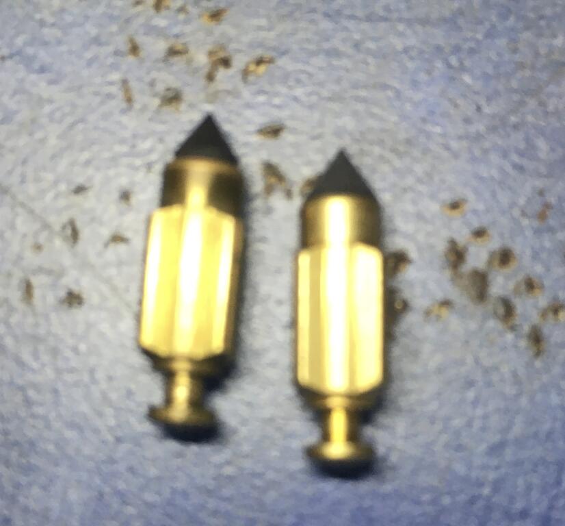

WheelHorse520H 710 #28 Posted October 2, 2021 (edited) Okay, new float needle is in and it started after I messed around with a few things. It ran for about 30 seconds to 1 minute and would stumble and die, then one time I moved the throttle up just a smidge until it stopped stumbling. Ran good for about 3 minutes no choke so I raised the throttle to see if it would engage the PTO. Nope… same as before it would stumble and die and then backfired twice. I realize now, I don’t think it was at full throttle. I think my tach is broken but I have heard this thing run at 3600 rpm and this did not sound like it. Since it backfired twice it will not restarted. Ideas? Thanks, Andrew P.S. Below is a photo of the old needle (left) and the new one (right) I used a Briggs and Stratton 797410 and it was identical to the old one. Well except this one actually has the seal. Edited October 2, 2021 by WheelHorse520H Photos Share this post Link to post Share on other sites

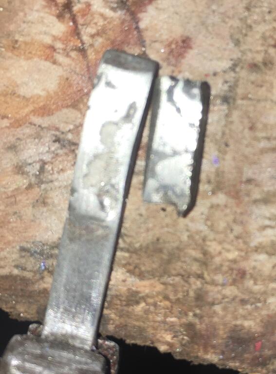

WheelHorse520H 710 #39 Posted October 10, 2021 Done. The idle adjustment screw was out of wack. It ran and idled better than ever. I even started to mow with it today. Until the mule drive fell off because it was not installed correctly and I sheared a flywheel key. But the story with that is I bought one from @onanparts.com but it was defective, I broke it yesterday when I took the flywheel off to get better access to change the vacuum line. So naturally since I don’t have a welder I took my dad’s plumbing torch and some soldering wire and after a couple tries was able to make it work to get things solved. Ordered 2 new ones from Jack’s Small Engines because they were cheaper. One extra to keep in case one breaks. So all in all it was a good day here. Thank you all for the valuable info and hopefully this machine is squared away, I will be sure to keep you all posted. The photo below shows the defects (kind of) in the flywheel key. You can see the little etchings where there was just no metal, at first I thought it was the way it broke but I noticed that both pieces were flat or dropped down, nothing fit into the etched areas. Share this post Link to post Share on other sites
Handy Don 16,751 #40 Posted October 10, 2021 5 minutes ago, WheelHorse520H said: It ran and idled better than ever. I even started to mow with it today. Until the mule drive fell off because it was not installed correctly and I sheared a flywheel key. Ok, so some good and some not so good. Puzzled about the keys and defects. Keys are pretty simple pieces of steel designed to hold things securely but yield by shearing if the load exceeds the design. Can you post a picture with them in better focus please? Is this the key between the flywheel and the crankshaft? It's pretty darn rare to shear a flywheel key without having something being driven by the engine abruptly stop the engine from turning--is that what happened when the Mule fell off? Share this post Link to post Share on other sites
WheelHorse520H 710 #41 Posted October 10, 2021 (edited) 14 minutes ago, Handy Don said: Can you post a picture with them in better focus please? I might try again when I swap them out but it was tough to get a good shot. 14 minutes ago, Handy Don said: Is this the key between the flywheel and the crankshaft? Yes. 14 minutes ago, Handy Don said: It's pretty darn rare to shear a flywheel key without having something being driven by the engine abruptly stop the engine from turning Yes, I agree that’s what makes me believe it was a defect, it got stuck in the key way on the flywheel yesterday when it broke, I think some rust jammed it up, then I tapped a rock with the deck today witch I believe weakened my solder enough that when I tried to restart it after mounting the mule drive it broke. 14 minutes ago, Handy Don said: is that what happened when the Mule fell off? No, the engine still ran and I actually ran over the mule drive and didn’t notice that it wasn’t a rock at first. It’s a very complicated situation here. Edited October 10, 2021 by WheelHorse520H Share this post Link to post Share on other sites
