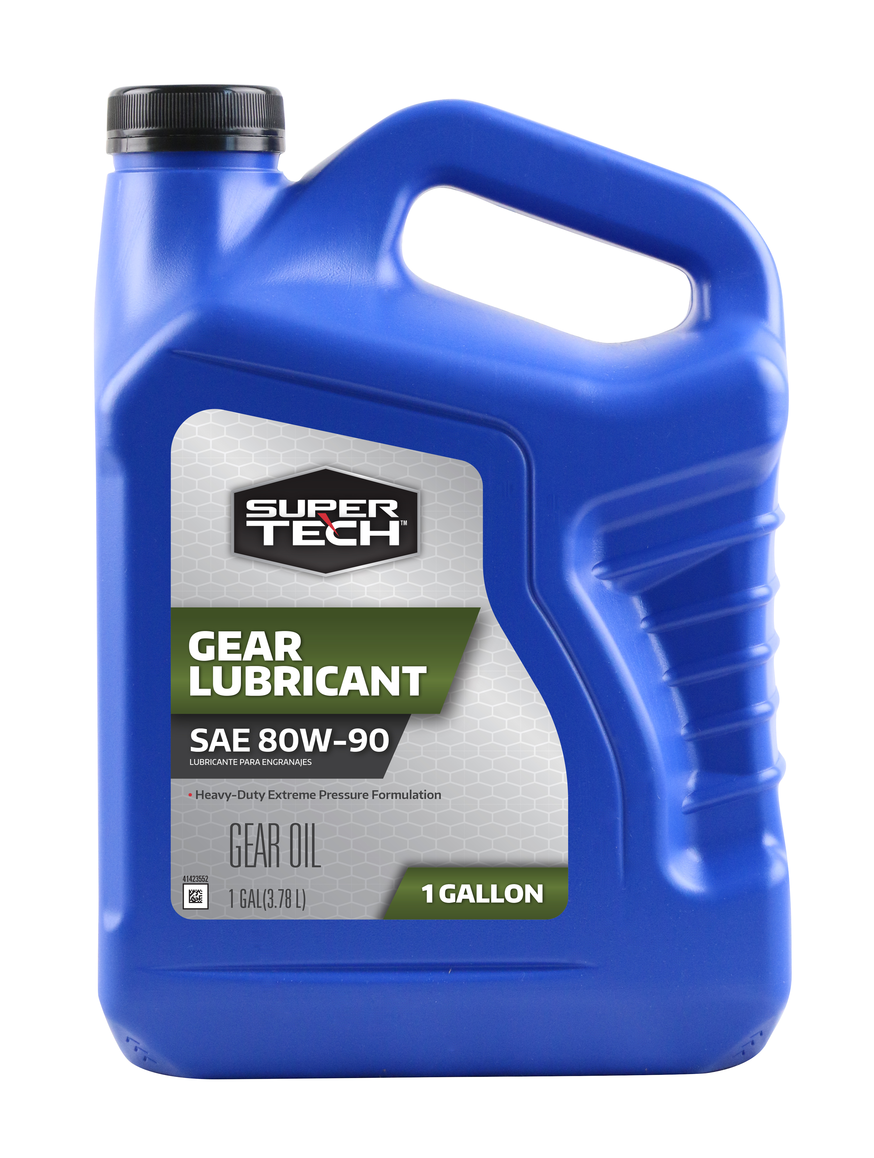

71_Bronco 1,072 #6 Posted August 30, 2021 If I recall correctly, I jus used the blue bottle from Walmart. They had 1 gallon jugs of the 80W-90 last time I bought it. Brand is "Super Tech". Probably not the best stuff out there, but then again, these are not really top-fuel dragsters here we are dealing with. 1 Share this post Link to post Share on other sites
