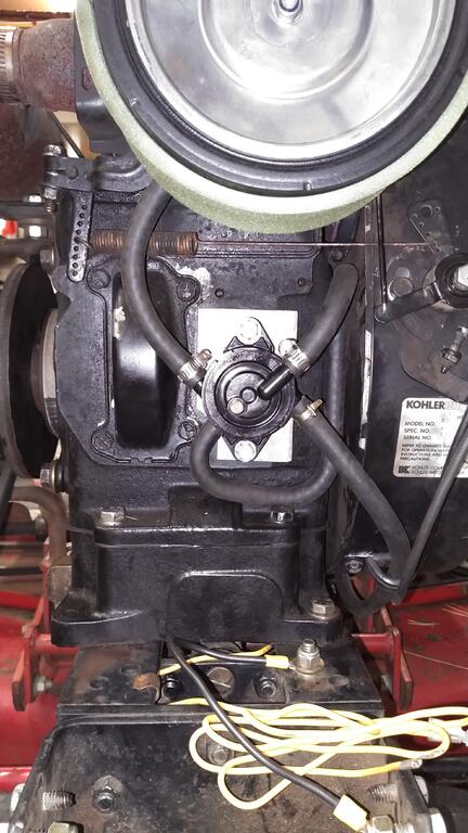

Bill D 2,247 #5 Posted August 26, 2021 Consider something like this. I made this plate to allow me to use a vacuum impulse pump on these engines. Cheaper than OEM. The pump in the picture is a Kawasaki pump. 1 Share this post Link to post Share on other sites
