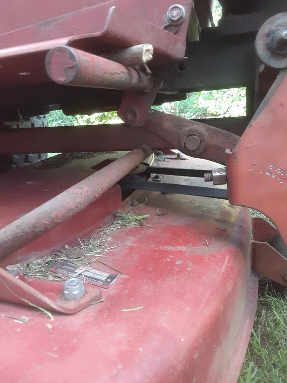

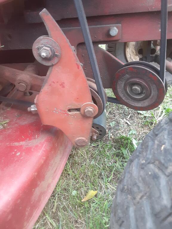

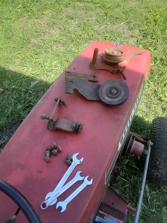

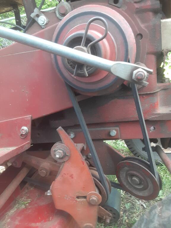

Carrot platinum 7 #31 Posted September 9, 2021 Howdy all. I got all the parts i needed from pullstart in the mail yesterday. Shoutout to him for being such a big help. I love how he used my username as the name on the package, brought a smile to my face. Everything went on easy, took about 20 minutes with the aid of the service manual. I still have to find the deck lift, so the deck is always down, but it still works great. The hardest part was the big lift thing that goes on the deck, figuring out combinations of nuts for an effective, tight double nut. It cuts great, and the deck engaging and running is quieter that alot of modern mowers i have heard. Thanks again, i will definitely be sticking around this forum for knowledge. 1 Share this post Link to post Share on other sites
