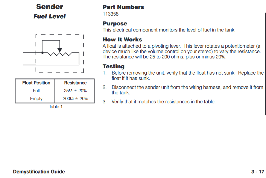

lynnmor
This may help diagnose the problem:
