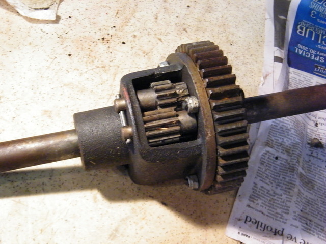

stevasaurus 23,662 #26 Posted March 22, 2022 Rich, I would buy a gallon of diesel and use a plastic wash tub, soak the part and use a wire brush or wire wheel to clean off the gunk. After that, it you have a rust issue, I would recommend electrolysis or blasting with plastic beads. Electrolysis is much cheaper and works great. You are correct that somebody has been in your transmission before. Look at your differential and your mushroom gear. Your differential has the bolt on bull gear and the mushroom gear to fit the bull gear. Like in this picture. These were not factory issue in the #5003 transmission. If you take apart your differential, notice the direction of the pinion gear under the nut on the through bolt. If you put it back together with the pinions turned the opposite direction, you will not be able to start that nut. See picture. Share this post Link to post Share on other sites

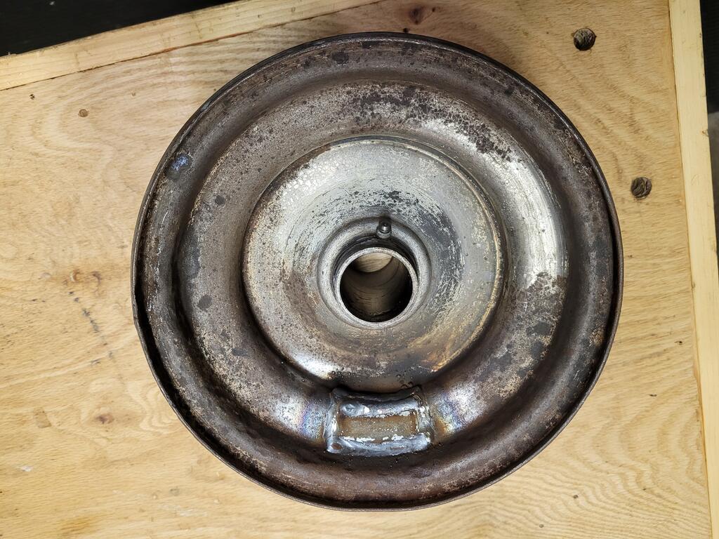

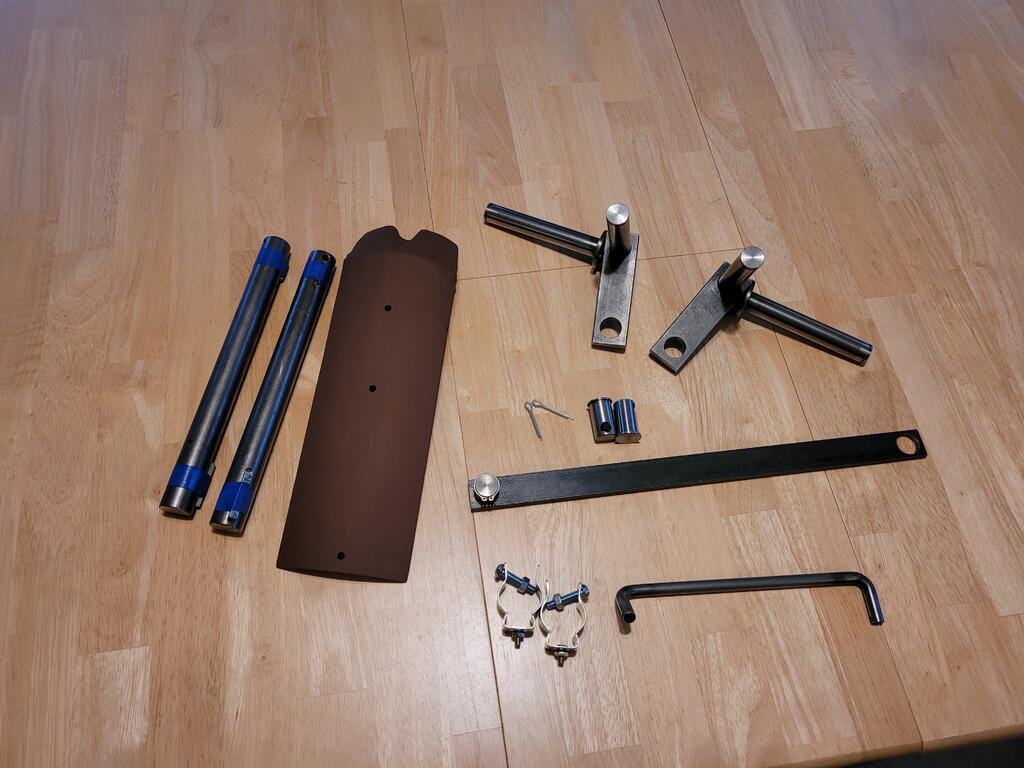

RichJ 29 #27 Posted March 22, 2022 Steve, I'm on it. Got the diesel fuel today. Will start the soak tomorrow. Somewhere in my web surfing, I've come across the detachable bull gear before. It's funny though, because I just watched your video on the bull gear bolts interfering with the pinion gears last night. Below are some pictures of the parts I accumulated over the winter. Not shown are a really nice pair of rear hubs that will replace the striped out old ones. I had a small patch welded in a bad spot on one front rim. Haven't had a chance to grind the welds yet. The other three rims are not perfect, but OK. One question, though. One press-fit bushing on a front rim was removable by hand, so the fit is a little loose. Is there a slightly over-sized bushing or other type of over-sized bearing available? 1 2 Share this post Link to post Share on other sites

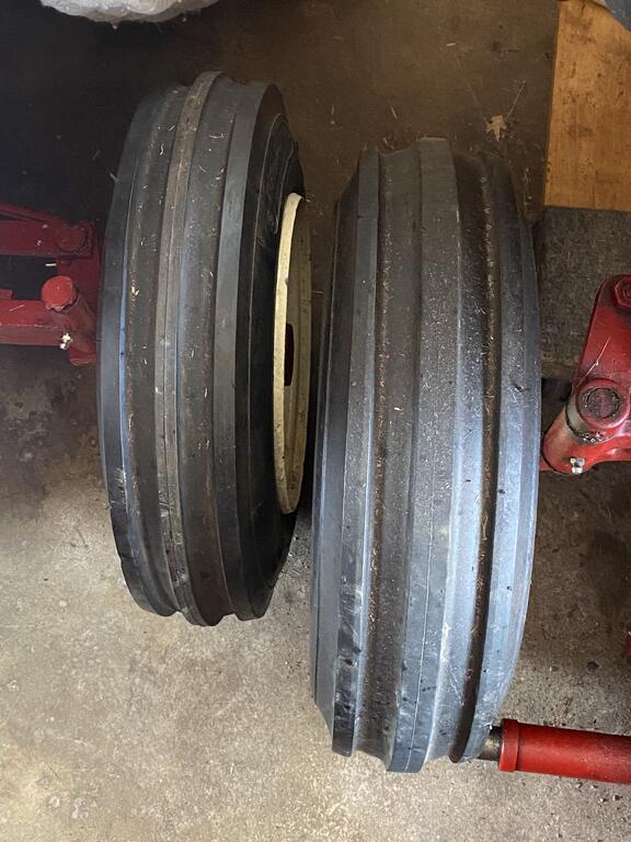

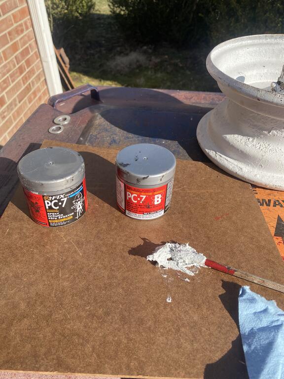

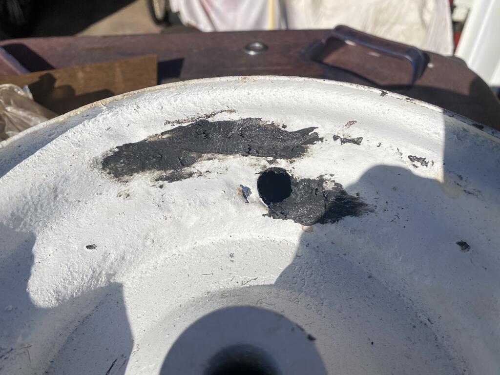

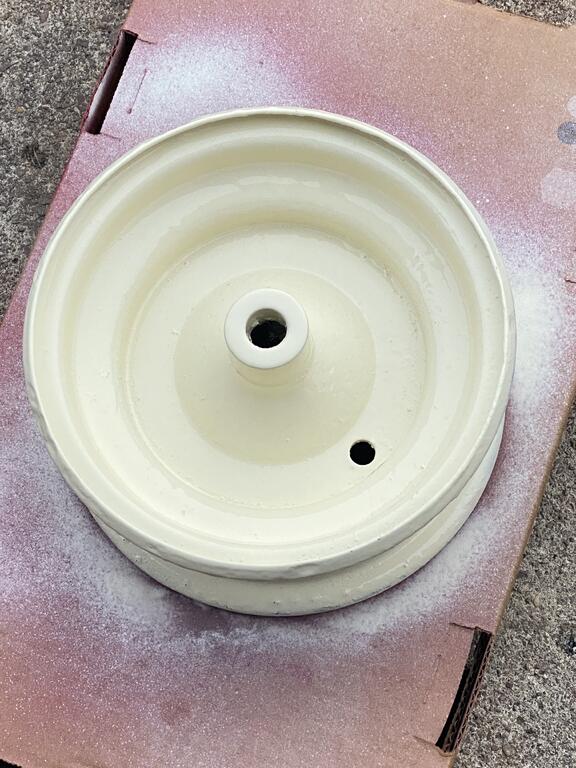

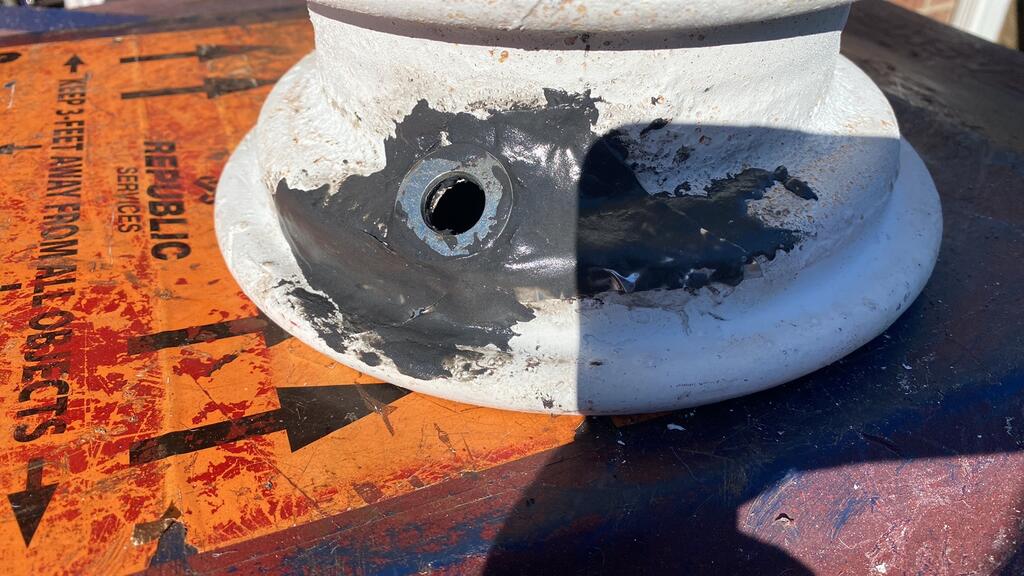

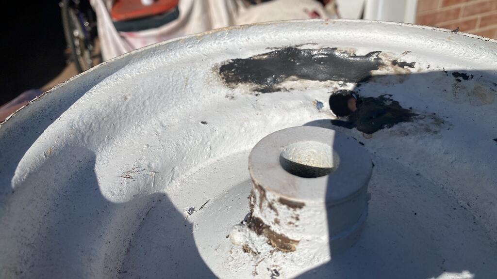

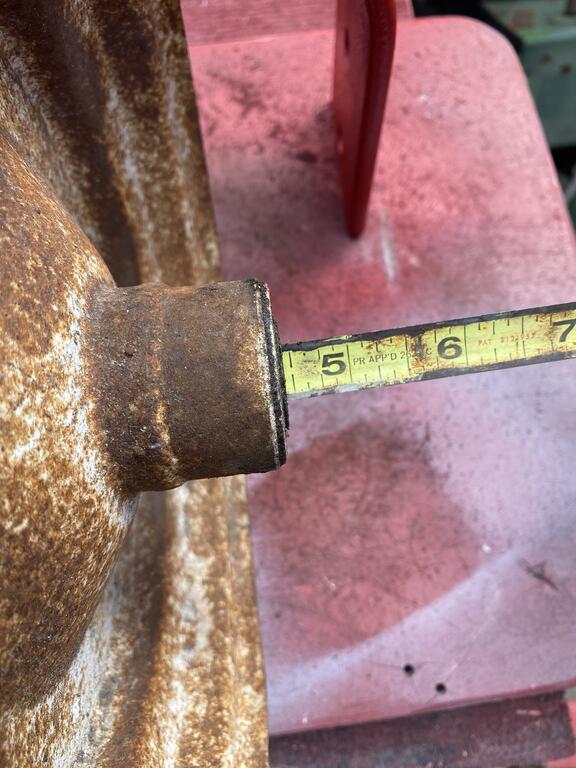

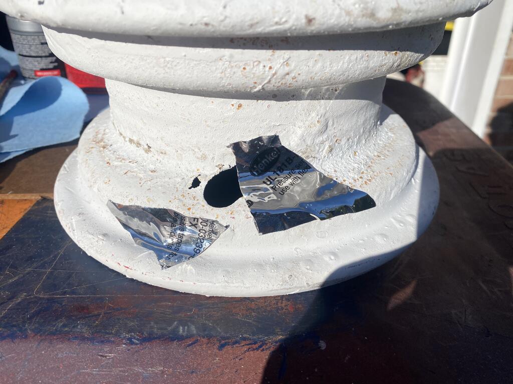

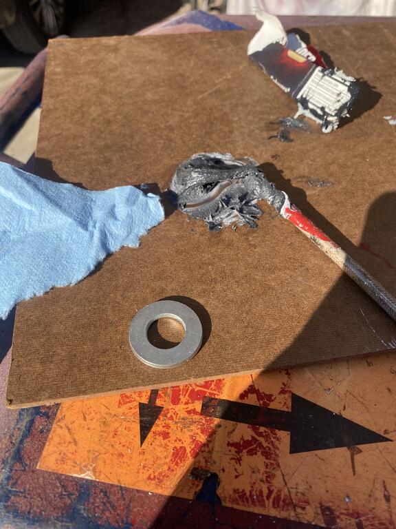

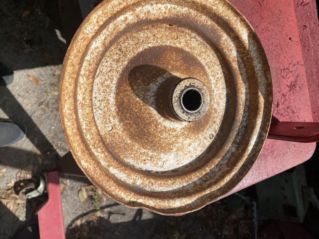

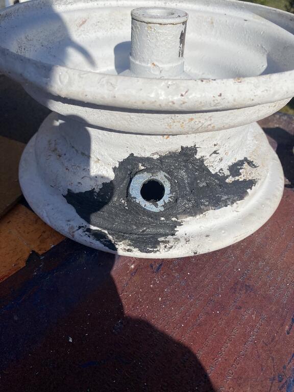

Lane Ranger 11,951 #33 Posted March 26, 2022 On 3/21/2022 at 10:44 PM, oliver2-44 said: Your front rims were only used from 1958 to 1961. They are getting harder $ to find. Most were shipped from the factory with calcium chloride for ballast which is corrosive. I’ve used fiberglass to repair some really bad ones. LB Weld or just Bondo works on the heavily pitted ones. Post some pictures when you get to that part. Also If you haven’t already bought new axles you can flip then and drill new roll paint n holes. When you get your gears all cleaned up post closeup pictures of each one. These guys can tell you what will work. For a show cruiser you can put up with a little pitting. PC-7 is also a very good product to use on old RJ rusty wheels. Available at auto parts stores and Wal-Mart. Thanks to Craig Herne (AMC Rules) for the tutorial on this stuff. I used on a set of old wheels. You can use metal tape, steel wool, or other materials to fill big or small rust holes and then fill remainder with PC-7 mix. It can be worked for 25 to 30 minutes and can be smoothed with a wet finger etc ( I wore vinyl gloves). Dry for a day then sand to smooth further. I had a big rust hole o. My wheel valve hole. I used grey primer and then Rustoleum Antique White Gloss for final painting. Share this post Link to post Share on other sites

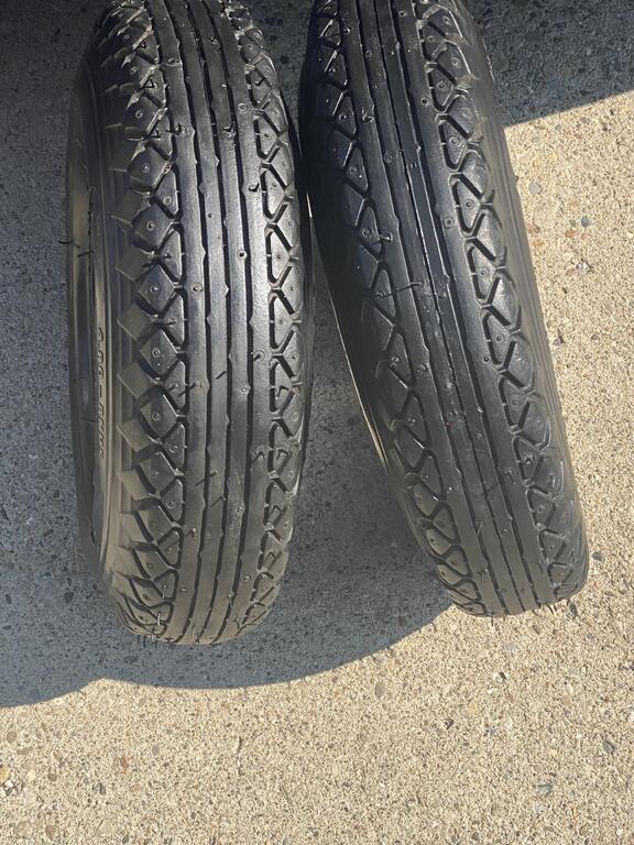

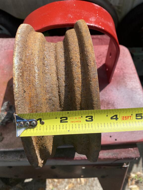

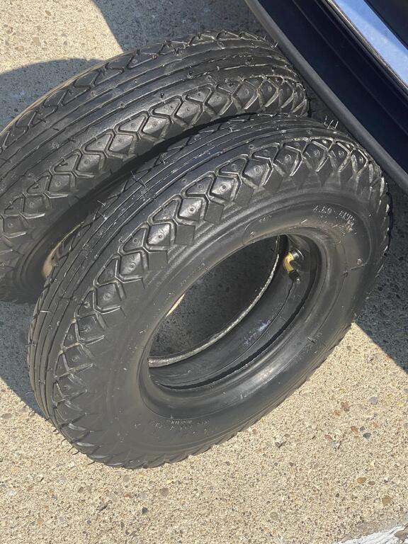

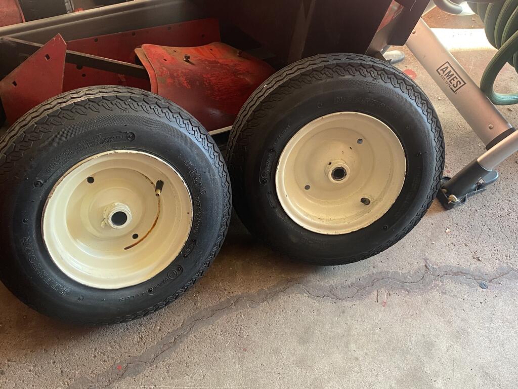

Lane Ranger 11,951 #34 Posted March 26, 2022 Some other things to consider on RJ/Suburban front wheels. Rib tires can be used ( they were not on originals but look good and work well for steering). The first photo is of tri-ribs that are 3.5 x 8 and 4.0 x 8 on right. Both can be used on RJ fronts . I think the smaller looks better. The second shot is of some Goodyear 1960 tires I just bought that were new old stock I am going to put on one of my RJs. These were used on RJs and Suburbans. The fourth photo is of some Deestone tires on wheels for some later Wheel Horse tractor models but often used on RJs and Suburbans. The fifth, sixth and seventh photos are of a very early wheel that was used on belt drive Ride-a-Way juniors. It is a Shenuit tire wheel (confirmed by Clay Brooks - one of the big Wheel Horse collectors and an expert, professional tire guy). Shenuit tires no longer made and although hub is same width as the RJ/Suburban wheel spindles-it is one inch narrower however to accommodate the old Shenuit tires. Just some more food for thought on your RJ redo. Share this post Link to post Share on other sites
