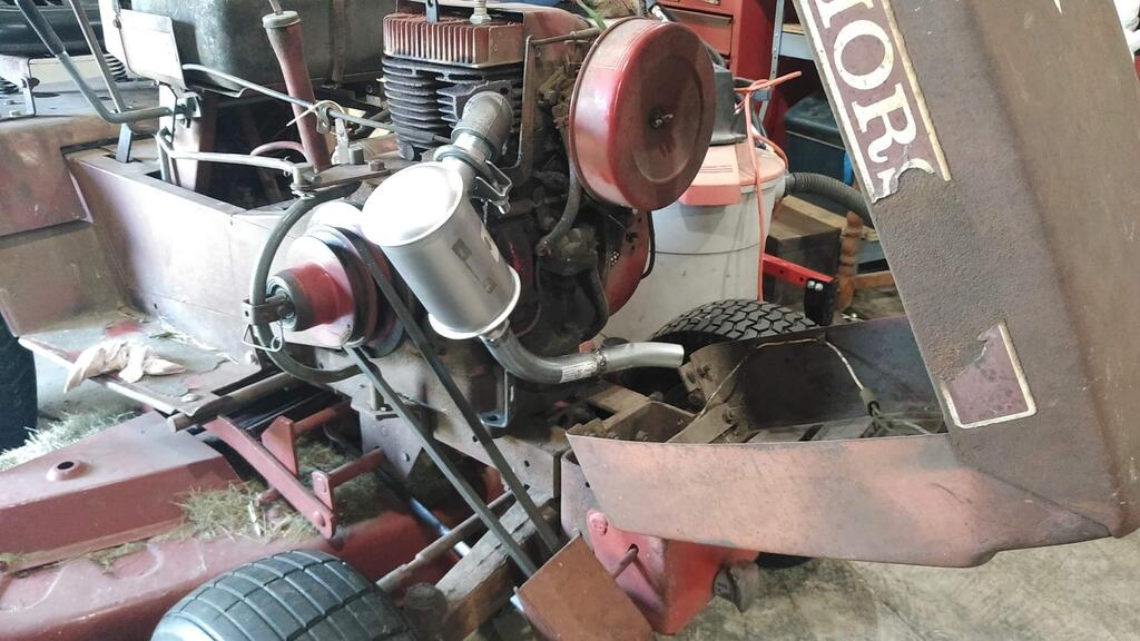

edgro
this is my current project, outlet is emt tubing.
working on trying to find a better clamp, the 1-1/2 HD exhaust clamp is way oversize.
planning on a support bracket for the outlet pipe
skrusins
Thanks for sharing your picture. That is going to help get me started. Thanks Again
