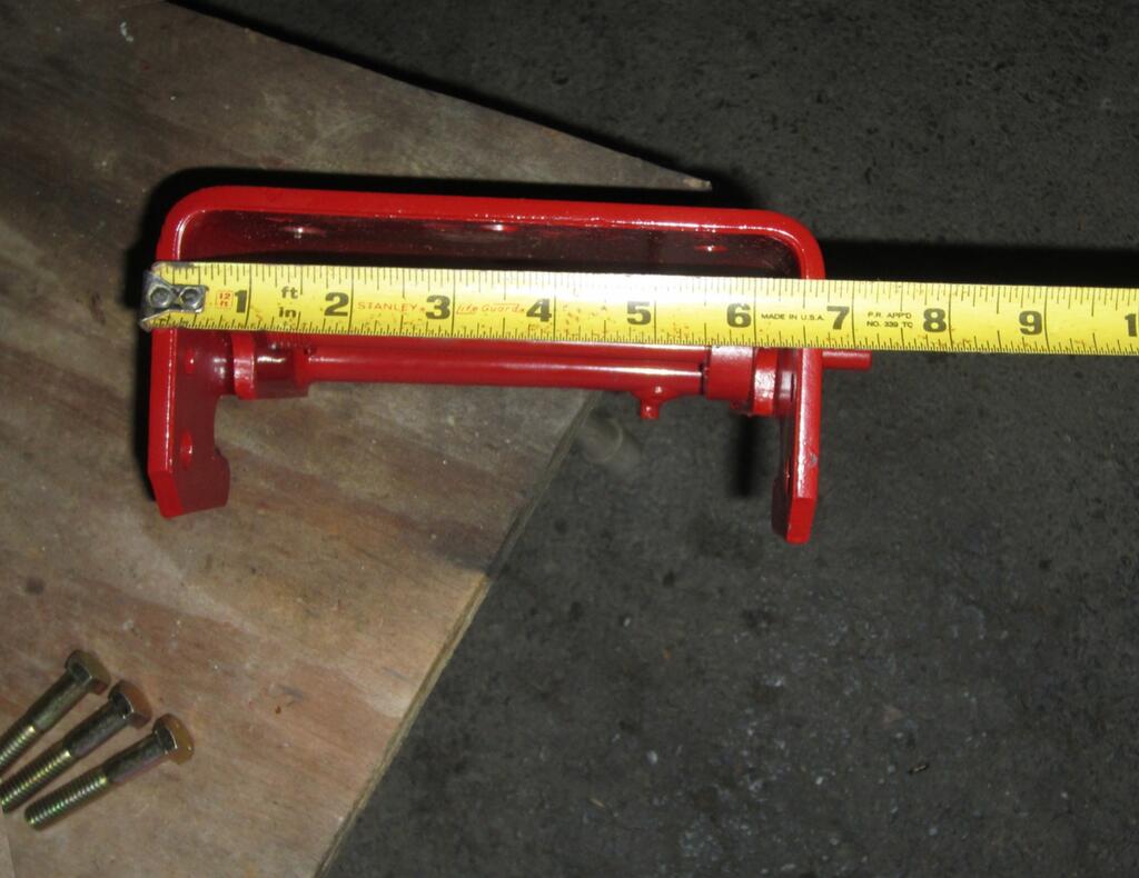

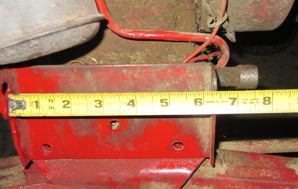

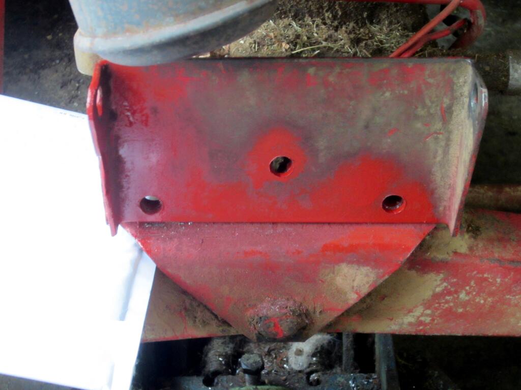

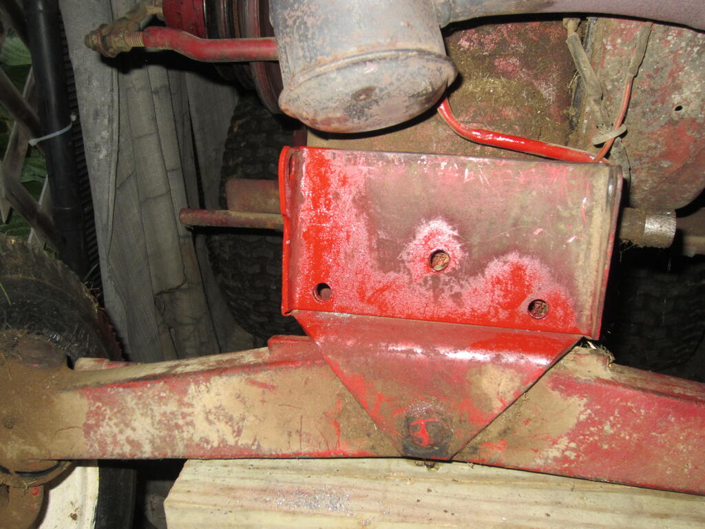

Ed Campbell 1 #1 Posted August 13, 2021 I just performed the mule drive upgrade on my 1969 charger 10 as is shown here and it went well except my hood support is about 1'8" narrower than the front hitch I had is wide. I installed a 1/2" solid plate and it pretty much fit as it should once it was extended out like that. I had an 86" belt on hand which also fits my 42" deck which I hoped would work, as that is what is called for with some newer decks and this belt arrangement, but it was about 8" short of reaching, (one way), My guess is using the 86" belt for a trial, I am going to need a belt that is 102" which is easy enough, I thought I would ask what others may have gotten to use properly with the new setup? Thanks, Ed Share this post Link to post Share on other sites

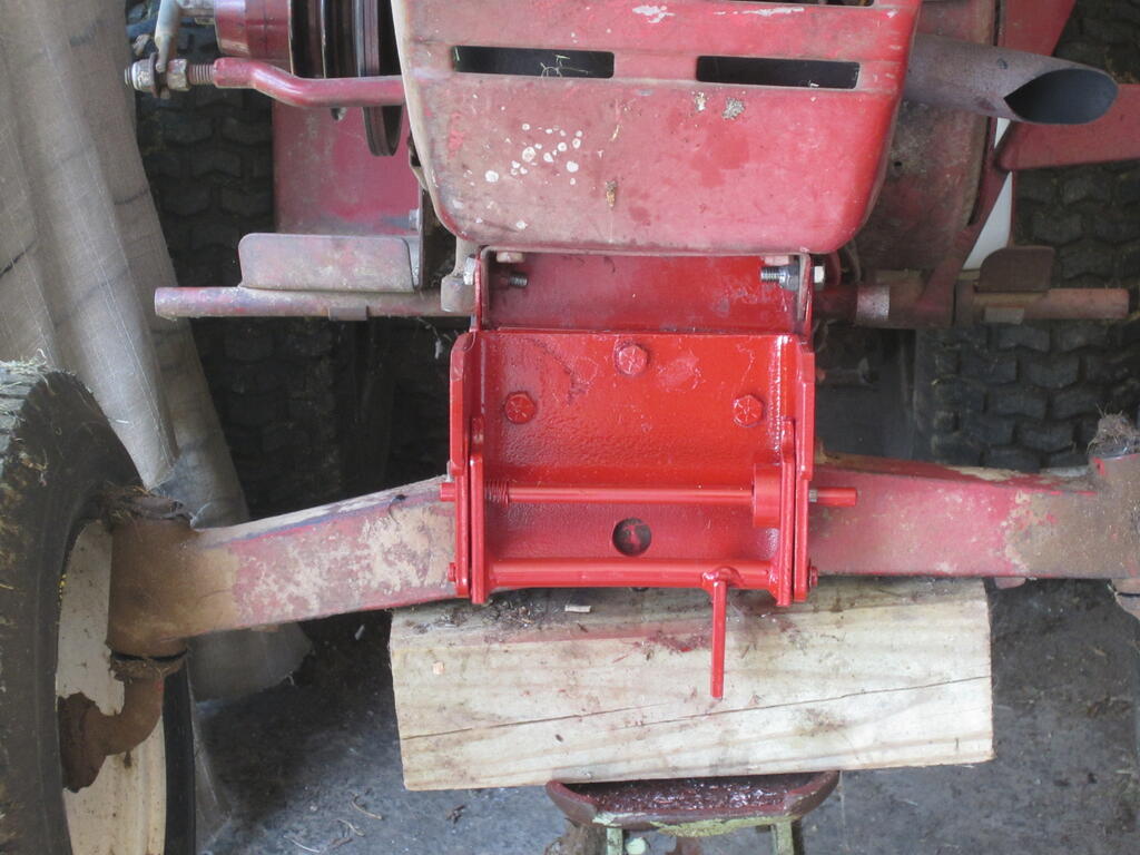

Ed Campbell 1 #6 Posted August 18, 2021 I got 102" with a rope check, but a 102" belt would barely fit over the snout of the pulley. A 105" ended up being an easy slide on fit with everything relaxed and I am just breaking in the belt now with mild tension. The belt is slapping around some like that, but I will readjust it after an hour or so. If the pictures attach, you can see the front hitch I got is wider than the hood support is wide, and it is also built with the axle pivot point off center. I had to make a small notch on the right upright even with the 1/2" spacer, but it ended up pretty good I think. 1 Share this post Link to post Share on other sites
