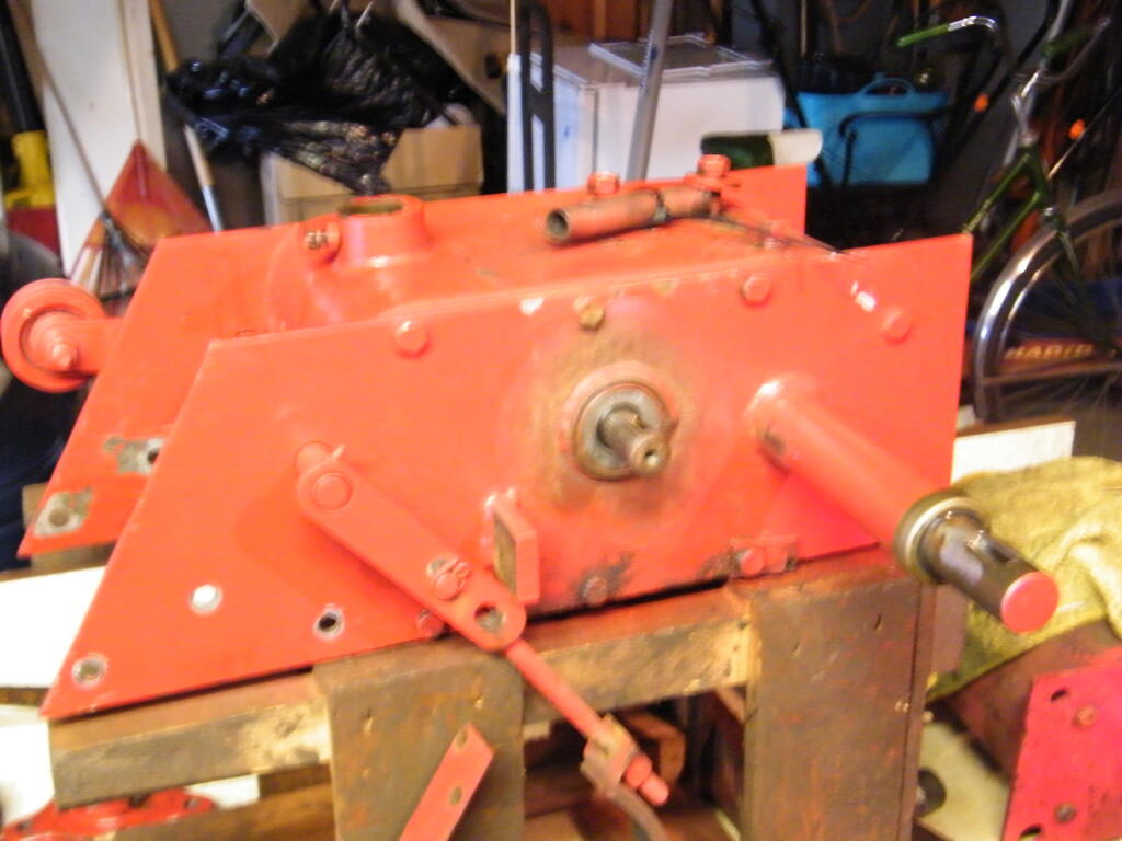

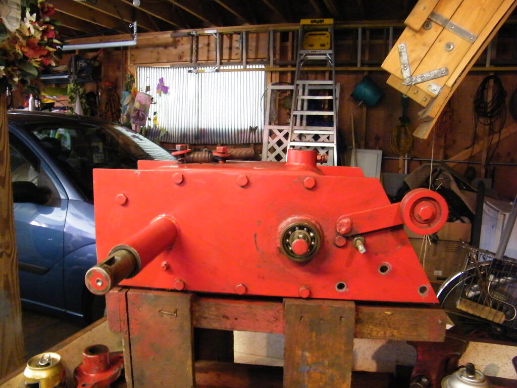

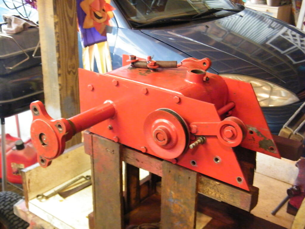

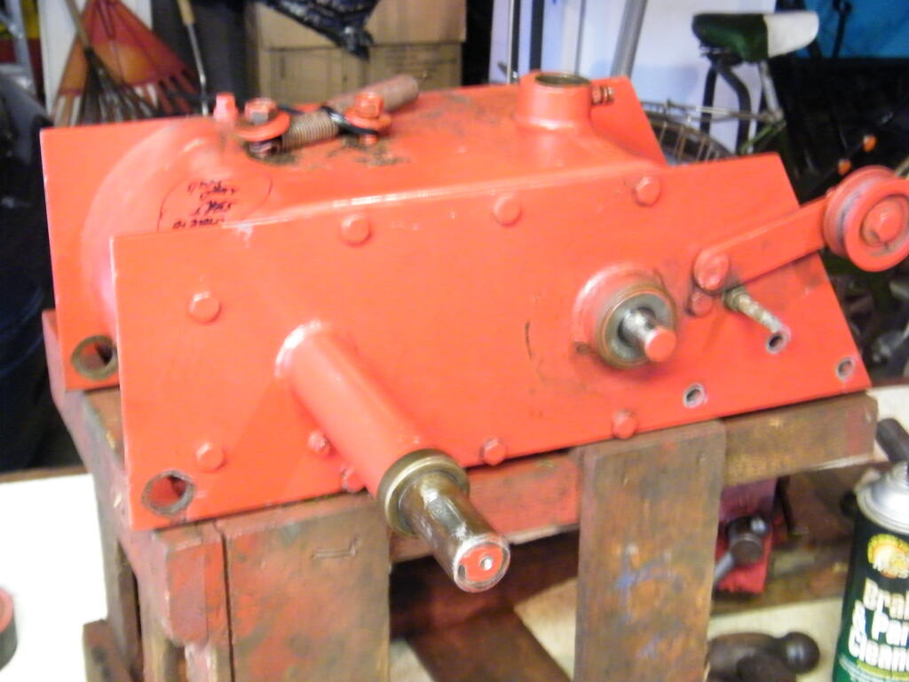

stevasaurus 23,808 #10 Posted August 10, 2021 That information would have been helpful...you think?? I use an old case that they used for 5 gallon carboys (glass water jugs). I can turn it different ways to be able to hold the parts of the trans solidly. It is easy to use on the work bench and put paper towels or cloth towels underneath. It would be easy to make one, but they are still available and they are solid. It has enough holes and places to turn the trans to what ever position you need it to be in. It has been perfect for working on these transmissions. 1 Share this post Link to post Share on other sites
