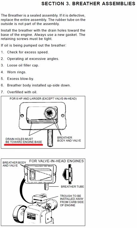

ebinmaine 77,350 #1 Posted August 9, 2021 1968 model year HH100. Looking at the inside of the breather there are a couple of tiny little pin holes. Am I correct in thinking those go to the upward side as installed? Also, should I put a skim coat of silicone on that gasket or no? Share this post Link to post Share on other sites
Stepney 2,357 #2 Posted August 9, 2021 If nobody else gets back I'll check for my old teccy service book. May be in there. I thought the little holes went down for oil to drain, and it had a little reed valve to control the vent.. 1 Share this post Link to post Share on other sites
Howie 900 #3 Posted August 10, 2021 I think the holes go down, lets the breather drain. 1 Share this post Link to post Share on other sites
gwest_ca-(File Mod) 12,000 #4 Posted August 10, 2021 From service manual 1 Share this post Link to post Share on other sites
