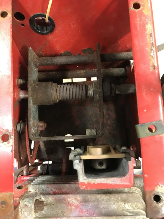

Bentoolong 94 #8 Posted August 16, 2021 Is there anything to tighten/lube/adjust in this area. Things work well in my mind but then this is my first WH hydro. Thanks. BTL Share this post Link to post Share on other sites
Jeff R. 35 #9 Posted August 16, 2021 I have read to not lube this area at all, but others will chime in that know more than I do. You can adjust the tension of the hydro control, but I would look at the manual that is available on this site which will explain the process in great detail. I would not make any adjustments until you have it running and you get a feel for the control to see if it is too loose or too tight. As far as your push valve, this is a very common problem. You have the right approach with the penetrating oil. What I did was use lots of penetrating oil, then took an air chisel and gave it two short hits on the side of the shaft. I clamped my vice grips on it and it broke free. Now since I have it free, I turn it in and then back out once a year so it does not freeze up again. Good luck. Share this post Link to post Share on other sites

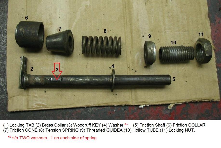

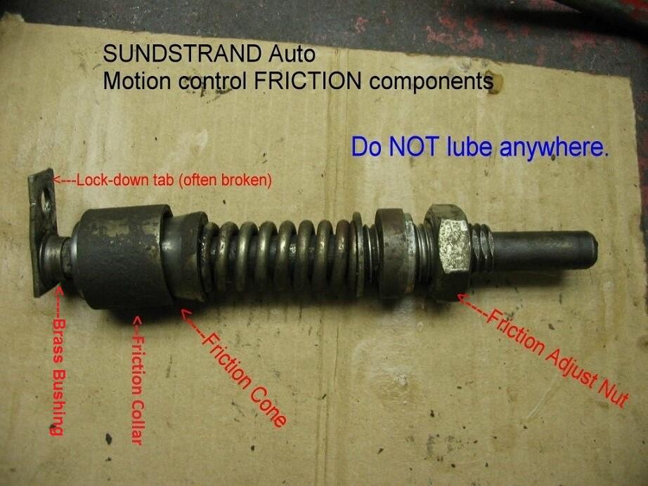

daveoman1966 3,882 #10 Posted August 16, 2021 This 'Friction Control Motion Lever' only needs to be kept free of dirt and any debris. By definition, it's design works on FRICITION and any lubricant defeats the purpose. Accordingly, don't lube anything in this apparatus. The friction adjustment is accomplished by the locking nut (#11) in my pic. Don't lube the NYLON cam either... Share this post Link to post Share on other sites
Bentoolong 94 #11 Posted August 23, 2021 Thanks, Just what I needed. Bentoolong Share this post Link to post Share on other sites

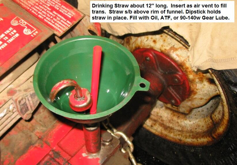

Bentoolong 94 #12 Posted September 8, 2021 I'm adding some 10W-30 to the trans and after pouring the lube in I realized that the tranny is a closed system and I just plugged the vent. I got oil in a few places that I don't need it. Is there a bolt I could loosen somewhere to allow air to escape some place other than the filler tube? Thanks, BenTooLong Share this post Link to post Share on other sites
pfrederi 19,941 #13 Posted September 8, 2021 Run a piece of wire down the filler tube alongside you funnel and pour slowly!!! The four seat support bolts in the top of the tranny are not drilled through Share this post Link to post Share on other sites
daveoman1966 3,882 #14 Posted September 8, 2021 Easy fill...No spill. 2 Share this post Link to post Share on other sites
rmaynard 16,886 #15 Posted September 8, 2021 1 hour ago, daveoman1966 said: Easy fill...No spill. I've done this and I'll add one thing. Make sure that the bottom of the straw remains above the level of the fluid in the tranny. Share this post Link to post Share on other sites
