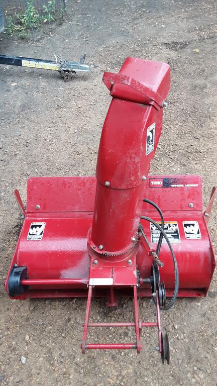

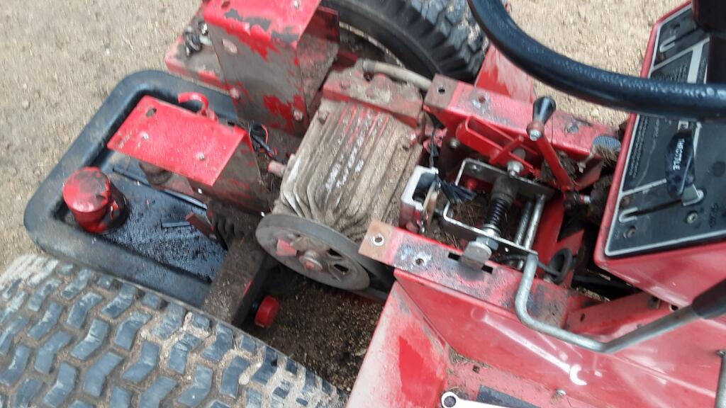

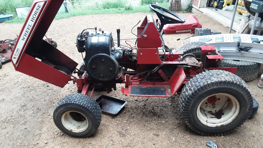

Jon925mn 39 #1 Posted August 9, 2021 Picked up a C145 with 42" deck & blower for $400 this weekend. Separate buys 20 miles apart. Gamble is the tractor as it's been sitting 4-5 yrs with old fuel. Love that varnish stank! Motor turns over so there's hope. Maintenance from owner was absent at best. I think the hydro filter might be original and air filter was clogged. At least the engine and transmission had oil. So she's now mine & we'll see what happens as we flush change and replace the bad. The body is actually in good shape except the cracked up fender pan. Anyone got a metal replacement? The blower is a good score and only missing the long lift rod. If I can get this C-145 running then it will only be used for snowblowing here in MN. Does anyone have horror maintenance stories and still end up with a good running tractor without rebuilding? 8 1 Share this post Link to post Share on other sites

pacer 3,179 #4 Posted August 9, 2021 9 minutes ago, squonk said: I've had a lot worse! Amen to that!! From the pics it appears relatively .... original? meaning doesnt seem to be any glaring PO "modifications" and it must have been inside -- yes? Nice looking tractor, and that is a right good model to boot. 1 Share this post Link to post Share on other sites
Bill D 2,593 #5 Posted August 9, 2021 Nice machine. I have heard that there may be problems fitting a snowblower on a black hood. Others may be able to confirm this. Nice score though. Share this post Link to post Share on other sites
c-series don 11,354 #6 Posted August 9, 2021 I’d look for a good metal fender pan and not plastic one. A metal one from that era will bolt right on. 1 Share this post Link to post Share on other sites
Tuneup 1,452 #7 Posted August 9, 2021 If you hit eBay at the right time looking for a fender, you can still get them cheap. My '80 C125 8 speed has a 520H fender. Cake bolt on. 1 Share this post Link to post Share on other sites
Gregor 4,847 #8 Posted August 9, 2021 5 hours ago, Jon925mn said: Anyone got a metal replacement? I have bought 2 C series, metal fender pans from Lincoln @ A to Z. Very happy with both. Share this post Link to post Share on other sites
Gregor 4,847 #9 Posted August 9, 2021 3 hours ago, Bill D said: I have heard that there may be problems fitting a snowblower on a black hood. I'd like to know more about this. Share this post Link to post Share on other sites
squonk 45,491 #10 Posted August 9, 2021 The only issues with the snowblower are: Getting to the rock shaft to install the lift flag and getting the hair pin in and the blower belt comes real close to the side of that fat lower hood. 1 Share this post Link to post Share on other sites

peter lena 9,761 #13 Posted August 9, 2021 @Gregor, should have no issues on the blower , long as the tech a matic is in place , I have a 82 -c85 , with 12 hp magnum power , all 3 of mine have the same tech a matic set up so I rotate the blower and the plow blade , over winter , did a lot of detailing on the blower , especially in the chute base area , as well as a lubrication upgrade in the chain auger drive area. that blower should spin over by hand . also rotate 3, 42" R/D mower decks over spring thru fall . that blower looks sweet, bought a c-14 last year , hoping to bring it back, it was so thrashed , sold it for parts , best part of that deal was the 2 stage blower that went with it , did a full service on that ,and sold that . get it when you can ,pete 1 Share this post Link to post Share on other sites
Jon925mn 39 #14 Posted August 10, 2021 9 hours ago, peter lena said: recommend that you add RISLONE ZINC TO YOUR OIL Worth a try even tho I've never been a big fan of additives. Low cost can't hurt but might help. Thanks Pete. 9 hours ago, pacer said: original Yep does seem original and not left outside. For some reason just didn't care about maintenance. 8 hours ago, Bill D said: Nice machine If I get it running proper it will be for sure. 8 hours ago, c-series don said: metal fender pan Yep I need one, hate the plastic. 5 hours ago, Gregor said: I have bought 2 C series, metal fender pans from Lincoln @ A to Z. Very happy with both. Thanks for tip. Share this post Link to post Share on other sites

Jon925mn 39 #16 Posted August 10, 2021 1 hour ago, Pollack Pete said: horror story Hard to understand why one would do that when everything on this tractor is accessible. Compared to my 520 working on this 145 has cut way down on the cursing. 1 Share this post Link to post Share on other sites
