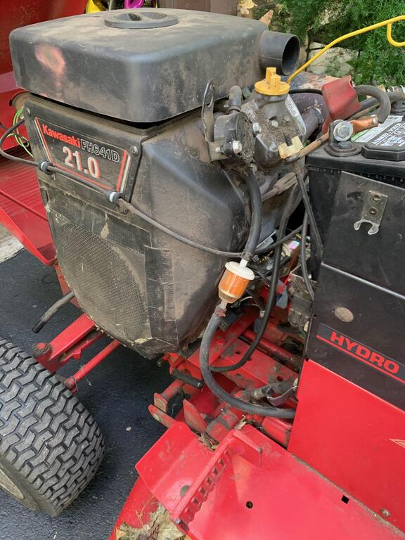

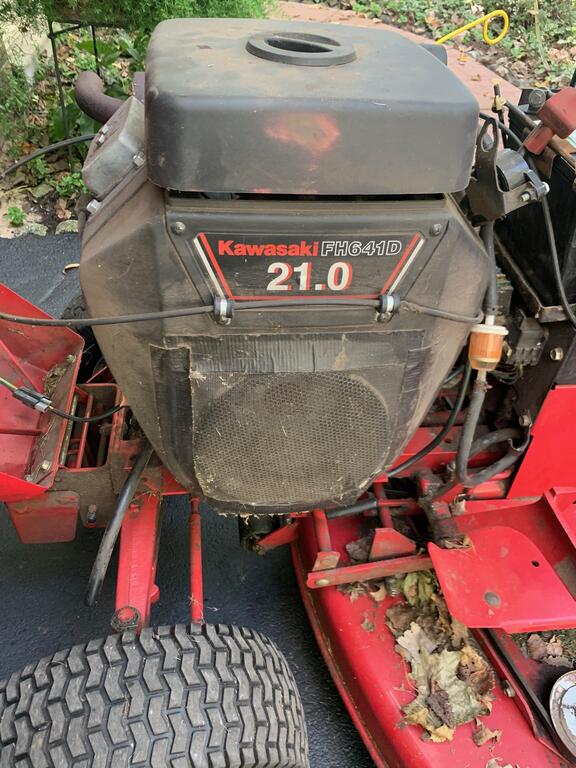

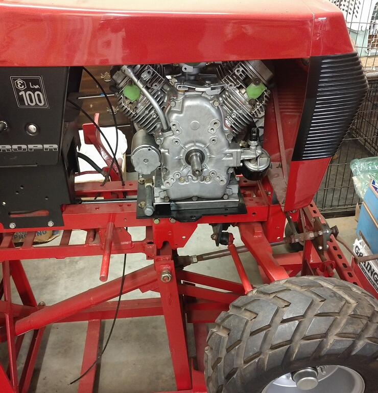

kpinnc 18,886 #76 Posted August 29, 2021 4 hours ago, Sewman said: Hope I don't get flamed for this!The Onan on my 418H took a dump & I found a 21HP Kawasaki twin & put on it 10 yrs ago & it's still going strong Always better to repower these machines rather than junk them. I have as many with the "wrong" engine on them as not. Plus, sometimes a repower allows plenty of time to rebuild the original engine while still getting use from the tractor. Either way keeps the tractor in use. Not many here would complain about that. Even if someone does, it's your tractor to do with as you please. I've been told Kawasaki makes a good engine. Never owned one myself, but know a few friends with them on a zero turn, and they love them. 4 Share this post Link to post Share on other sites
Sewman 20 #77 Posted August 29, 2021 13 hours ago, kpinnc said: Always better to repower these machines rather than junk them. I have as many with the "wrong" engine on them as not. Plus, sometimes a repower allows plenty of time to rebuild the original engine while still getting use from the tractor. Either way keeps the tractor in use. Not many here would complain about that. Even if someone does, it's your tractor to do with as you please. I've been told Kawasaki makes a good engine. Never owned one myself, but know a few friends with them on a zero turn, and they love them. I like the sound of the Onan better but the Kawa been very dependable & besides oil needed a starter replaced about 5 yrs ago,I think it's been on for around 10yrs. 3 Share this post Link to post Share on other sites
slim67 2,825 #78 Posted August 29, 2021 19 minutes ago, Sewman said: It looks like a clean installation. Was it a lot of work? 3 Share this post Link to post Share on other sites
Snoopy11 5,731 #79 Posted August 29, 2021 20 hours ago, Sewman said: Hope I don't get flamed for this!The Onan on my 418H took a dump & I found a 21HP Kawasaki twin & put on it 10 yrs ago & it's still going strong. Absolutely not! I have defended my Tillotson and Duromax billet built engines, and would put them up to anything on the market today. 21hp v twin will raise the dead... (get it...?) ...even your 418H... Don 1 1 Share this post Link to post Share on other sites
Sewman 20 #80 Posted August 29, 2021 2 hours ago, slim67 said: It looks like a clean installation. Was it a lot of work? No,really pretty easy. 1 Share this post Link to post Share on other sites
slim67 2,825 #81 Posted August 29, 2021 18 minutes ago, Sewman said: No,really pretty easy. Nice work. 1 Share this post Link to post Share on other sites

chipwitch 73 #95 Posted September 4, 2021 Anyone considering swapping motors with the carrol stream 16hp, beware. This is NOT a simple swap. You'll need a shaft adapter, fabricate an adapter plate to mount to the frame and raise the motor 2cm (or new shorter belts and adapt the pto clutch) The hood will not fit without adaptation to either the hood or the carb, air breather and muffler. If you want to use the dashboard throttle and choke they'll need adapting as well. Of course it can all be done. Just letting others know what all they're in for. I wouldn't have gone this route if I had known what all was involved. Just trying to save others the time I now have to spend on it. 1 Share this post Link to post Share on other sites
kpinnc 18,886 #96 Posted September 4, 2021 (edited) 5 hours ago, chipwitch said: Anyone considering swapping motors with the carrol stream 16hp, beware. This is NOT a simple swap. You'll need a shaft adapter, fabricate an adapter plate to mount to the frame and raise the motor 2cm (or new shorter belts and adapt the pto clutch) The hood will not fit without adaptation to either the hood or the carb, air breather and muffler. If you want to use the dashboard throttle and choke they'll need adapting as well. Of course it can all be done. Just letting others know what all they're in for. I wouldn't have gone this route if I had known what all was involved. Just trying to save others the time I now have to spend on it. I think nearly all repowers are like this. The electrical alone on the 500 series tractors is enough to need psychotherapy afterward. Very few newer engines use 1.125 PTOs. As you already said, most also require some mounting fabrication. If all that goes well, then the hood won't fit. Most folks cut the hood, but I prefer not to. I've had to modify air intakes and mufflers, but prefer to keep the tractor unmolested. Don't give up on it. Sometimes you just have to walk away and sleep on it. You might be surprised what you come up with. Edited September 4, 2021 by kpinnc 4 Share this post Link to post Share on other sites
slim67 2,825 #97 Posted September 4, 2021 1 hour ago, kpinnc said: I think nearly all repowers are like this. The electrical alone on the 500 series tractors is enough to need psychotherapy afterward. Very few newer engines use 1.125 PTOs. As you already said, most also require some mounting fabrication. If all that goes well, then the hood won't fit. Most folks cut the hood, but I prefer not to. I've had to modify air intakes and mufflers, but prefer to keep the tractor unmolested. Don't give up on it. Sometimes you just have to walk away and sleep on it. You might be surprised what you come up with. That’s why I cheat and use pull start engines! No electric to worry about just like in the early years of wheel horse. I realize that won’t work for a lot of applications but suits me just fine. 1 Share this post Link to post Share on other sites

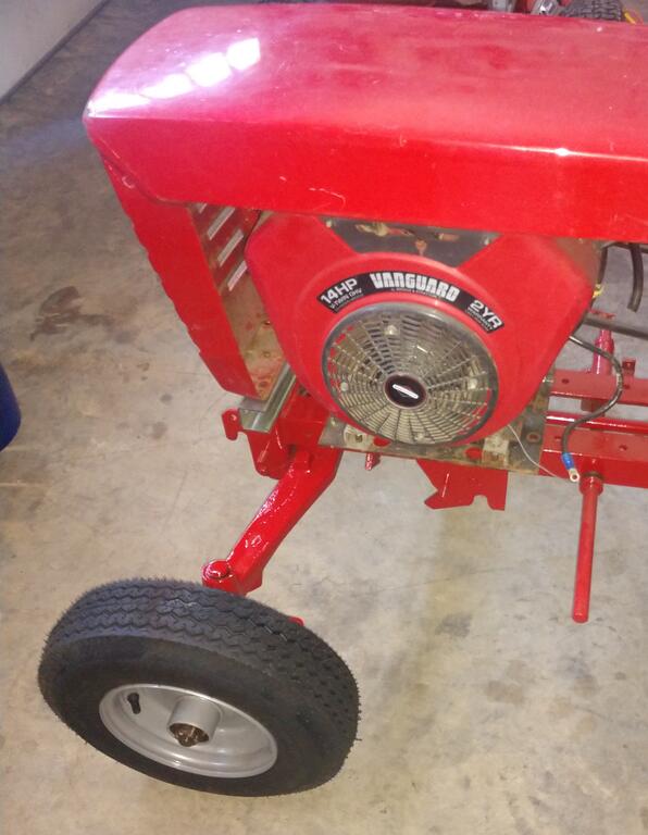

kpinnc 18,886 #98 Posted September 4, 2021 8 minutes ago, slim67 said: That’s why I cheat and use pull start engines! No electric to worry about just like in the early years of wheel horse. I realize that won’t work for a lot of applications but suits me just fine. I just last night ordered a pull start for my Vanguard 23 in the top picture above. Still gonna keep the electrical, but nothing sucks more than a dead battery. Hard to keep all these machines trickle charged... 2 Share this post Link to post Share on other sites
chipwitch 73 #99 Posted September 4, 2021 2 hours ago, kpinnc said: I think nearly all repowers are like this. The electrical alone on the 500 series tractors is enough to need psychotherapy afterward. Very few newer engines use 1.125 PTOs. As you already said, most also require some mounting fabrication. If all that goes well, then the hood won't fit. Most folks cut the hood, but I prefer not to. I've had to modify air intakes and mufflers, but prefer to keep the tractor unmolested. Don't give up on it. Sometimes you just have to walk away and sleep on it. You might be surprised what you come up with. I appreciate your words of encouragement. I won't give up. My only gripe is too little time to spare for it at the moment. Nevertheless, my choice is already made. Like it or not, it is a priority. The weeds are tickling my thighs! Good looking build 2 Share this post Link to post Share on other sites
Snoopy11 5,731 #100 Posted September 4, 2021 7 hours ago, chipwitch said: Anyone considering swapping motors with the carrol stream 16hp, beware. This is NOT a simple swap. You'll need a shaft adapter, fabricate an adapter plate to mount to the frame and raise the motor 2cm (or new shorter belts and adapt the pto clutch) The hood will not fit without adaptation to either the hood or the carb, air breather and muffler. If you want to use the dashboard throttle and choke they'll need adapting as well. Of course it can all be done. Just letting others know what all they're in for. I wouldn't have gone this route if I had known what all was involved. Just trying to save others the time I now have to spend on it. Yes sir, everyone has to do this when they swap engines... no matter the engine. You should see how modified mine is... Don Share this post Link to post Share on other sites
