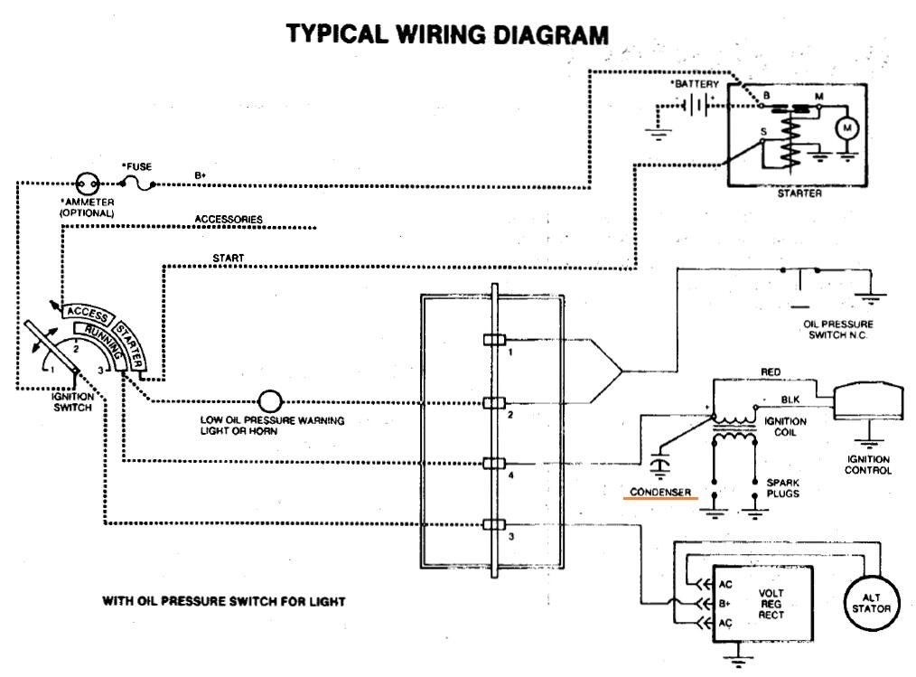

gwest_ca-(File Mod) 11,560 #2 Posted August 4, 2021 On 8/2/2021 at 10:42 PM, mstanfield said: 416-8/ P216 Onan Could the capacitor have impact to my spark issue? The capacitor is wired to the coil (+) so it is there to smooth out the power to the coil. If the condenser was shorted it would affect the voltage to the coil but highly unlikely. Try disconnecting it and see if there is any improvement. I have no Onan experience. Garry Share this post Link to post Share on other sites
953 nut 60,685 #3 Posted August 4, 2021 1 hour ago, gwest_ca said: The capacitor is wired to the coil (+) so it is there to smooth out the power to the coil. If the condenser was shorted it would affect the voltage to the coil but highly unlikely. Try disconnecting it and see if there is any improvement. This is the best way to do a quick check of a condenser. An engine will run without a condenser for testing, it is there to extend the lifespan of the ignition points. I have no Onan experience. Garry .Garry, wouldn't the condenser be connected to the "-" side of the ignition coil? Share this post Link to post Share on other sites
gwest_ca-(File Mod) 11,560 #4 Posted August 4, 2021 I believe all P-Series Onan engines use electronic ignition. Some Wheel Horse wiring diagrams do show the condenser but not all likely because the condenser is considered part of the engine. This illustration is from the Onan service manual. Share this post Link to post Share on other sites
