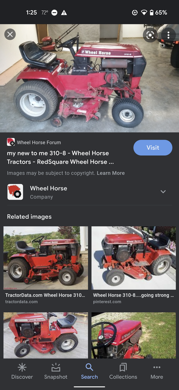

tunahead72 2,621 #5 Posted August 2, 2021 VIN plate should be around the seat somewhere, maybe just in front on the fender. While you're at it, tell us about the engine, should be a Kohler, either K241 or Magnum. Share this post Link to post Share on other sites
RITEK 25 #7 Posted August 2, 2021 Mmm I still can't find the s/n Share this post Link to post Share on other sites
pfrederi 20,062 #9 Posted August 2, 2021 The picture is a K-241 not a Magnum. Big difference in running down ignition problems. (no oil sentry on a K 241) You said you ran a lead from batterY + to solenoid terminal sparked but no crank. Have you tried a jumper from battery + direct to the starter motor terminal??? Share this post Link to post Share on other sites
