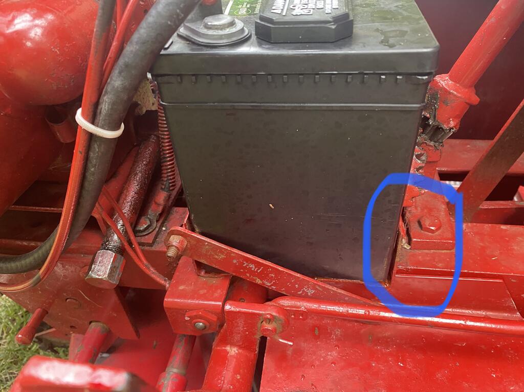

TonyBer 82 #1 Posted August 2, 2021 Any advice? Didn't realize that when trying to loosen the nut on battery box it was seized and snapped the screw that was attached/welded to box. Is this part available as a whole or any ideas on a fix? Thanks in advance. Share this post Link to post Share on other sites

squonk 48,072 #4 Posted August 2, 2021 My local farm store sells the replacement weld on studs. 4 Share this post Link to post Share on other sites
TonyBer 82 #5 Posted August 2, 2021 Interesting, is it a chain farm store like tractor supply or just local? Another gentleman was checking in entire box but if I can’t get that I’d buy those. Thnx! Share this post Link to post Share on other sites
pfrederi 21,145 #6 Posted August 2, 2021 Being frugal I just cut the head off a 1/4 bolt file an inch or so of it so its kinda flat on one side and weld it to the box... 3 Share this post Link to post Share on other sites

squonk 48,072 #9 Posted August 2, 2021 2 hours ago, TonyBer said: Interesting, is it a chain farm store like tractor supply or just local? Another gentleman was checking in entire box but if I can’t get that I’d buy those. Thnx! Independent store. Time is money. You can spend time cutting and filing if it's your thing , or weld these on and be on to something else. 1 Share this post Link to post Share on other sites

TonyBer 82 #12 Posted August 2, 2021 4 minutes ago, squonk said: Independent store. Time is money. You can spend time cutting and filing if it's your thing , or weld these on and be on to something else. Can you give me store info or how I can purchase? Thnx Share this post Link to post Share on other sites
squonk 48,072 #13 Posted August 2, 2021 11 minutes ago, TonyBer said: Can you give me store info or how I can purchase? Thnx Send me a PM with your address and I'll send them to you 1 Share this post Link to post Share on other sites
pfrederi 21,145 #14 Posted August 2, 2021 19 minutes ago, squonk said: Independent store. Time is money. You can spend time cutting and filing if it's your thing , or weld these on and be on to something else. Let's see 8 miles one way to the hardware store I can cut and file a bolt a lot quicker... 1 Share this post Link to post Share on other sites
squonk 48,072 #15 Posted August 2, 2021 Next time you drive to the hardware store for a toilet flapper pick a couple up. That's what I did. 1 Share this post Link to post Share on other sites
TonyBer 82 #16 Posted August 2, 2021 1 minute ago, squonk said: Next time you drive to the hardware store for a toilet flapper pick a couple up. That's what I did. Please explain or show a pic? I’m game Share this post Link to post Share on other sites
