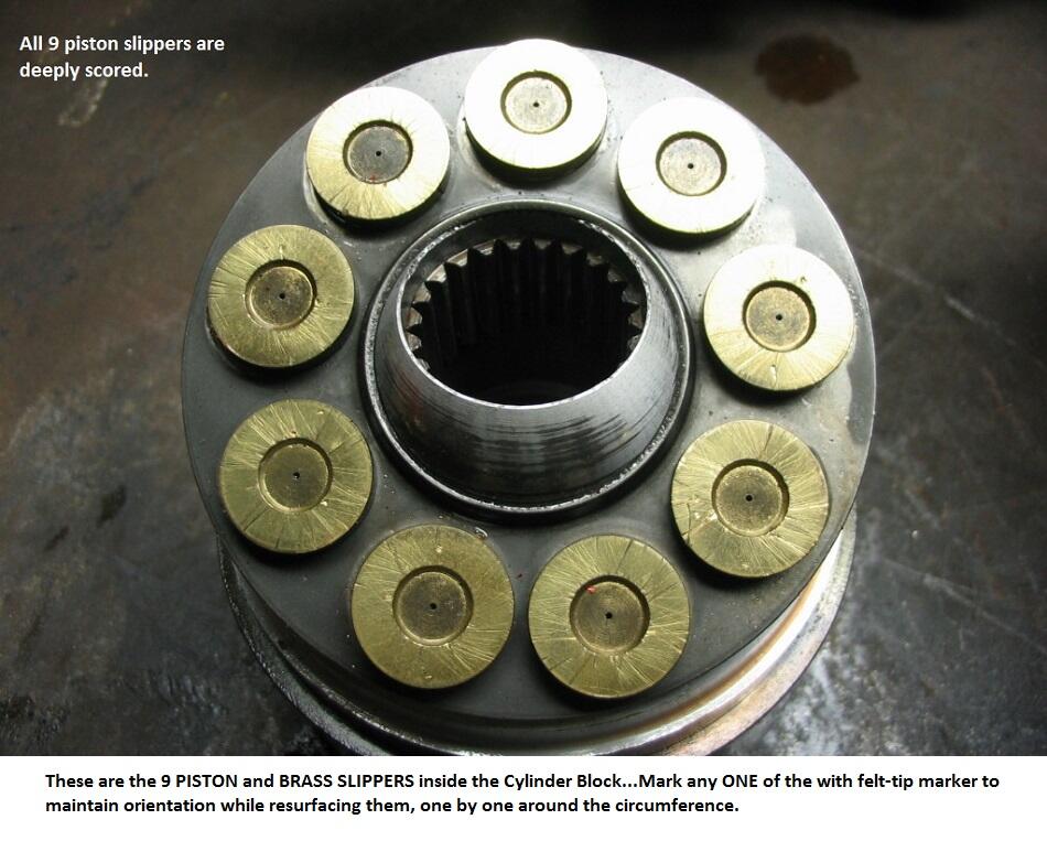

daveoman1966   3,839 #4 Posted August 2, 2021 Unless you've had the Sundstrand pump & motor rebuilt, you colud atleast open the pump for inspection. It is, after all, pushing 50 and...without doubt...you'll find some internal wear issues. Now would be the ideal time to address those issues. To restore these Sundstrands is not a difficult endeavor and I have a couple of .pdf files to assist in the overhaul. Here are examples of what you MAY find inside the pump. 1 1 Share this post Link to post Share on other sites
