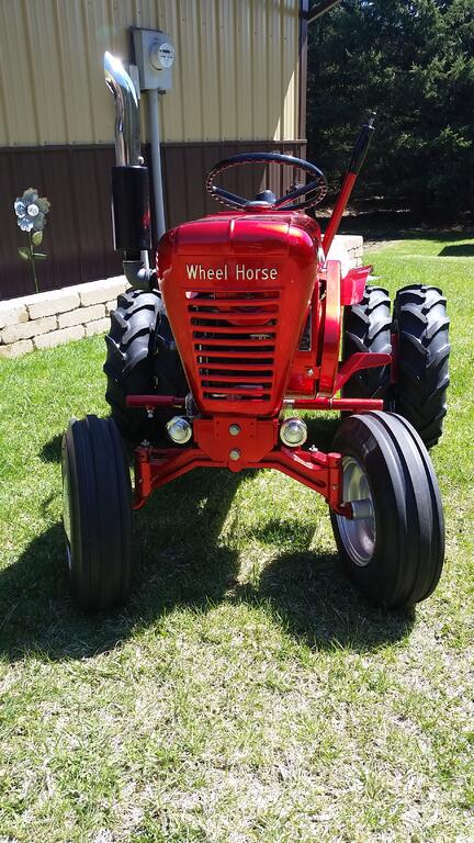

Gregor 4,847 #1 Posted July 30, 2021 I have a persistent problem with my C-141. I have a Jim Kemp stack on it. The larger one I believe. Try as I might, I cannot keep the exhaust connections tight. The muffler keeps wanting to fall over. I have tried tightening everything with an 18" pipe wrench, while it is all hot. I have lock rings at every joint, hammered home with a punch. Nothing seems to help. It will stay for a while, but eventually will start to fall again. When putting together an exhaust system, is it better to use galvanized pipe, or black pipe? Or does it make any difference? Thanks Greg Share this post Link to post Share on other sites
WHX?? 52,899 #2 Posted July 30, 2021 (edited) That's odd i have three of Jim's and they all stay tight. I use black iron mostly 'cause that's what we use for gas piping at work so available. Thinking when the threads rust a bit holds them tight?? The only lock ring I use is one at the base of the stack and sometimes one at the block. If your a lock ring fan some are made of pot metal and will melt. Even when I ran this unwieldy beast never had a problem.... since replaced with a JK.... Edited July 30, 2021 by WHX?? 2 Share this post Link to post Share on other sites
squonk 44,625 #3 Posted July 30, 2021 Where does it loosen? If it's at the engine itself the block hole is probably eroded some and the threads aren't as deep as they used to be. I have the same issue on my 953 Share this post Link to post Share on other sites
Gregor 4,847 #4 Posted July 30, 2021 15 minutes ago, squonk said: Where does it loosen? Mostly at the joint between the nipple in the motor, and the coupling screwed to it. The nipple in the motor has never been out since I have owned it. I am considering drilling and tapping a hole through the two, insert a stainless steel screw, in an effort to hold it in place. 1 Share this post Link to post Share on other sites
squonk 44,625 #5 Posted July 30, 2021 That nipple may be eroded from the inside out and possibly "crushing" when your coupler is tightened down. Then as it heats and cools it loosens up. If you were to replace that nipple your issue may go away. I use schedule 80 black iron when it's available. 2 Share this post Link to post Share on other sites
peter lena 9,456 #6 Posted July 30, 2021 @Gregor removing the original nipple from the engine is probably your best bet , using a 18" pipe wrench on that nipple , and a 3 lb hammer , just after the pipe wrench adjustment area , that's the most solid impact area , with no " bouncing to impact " effect. having worked with a pipefitter for years , taught me the secrets to pipe removal. a bounce free hammer blow on the engine mounted exhaust nipple , should move it , then use a pipe tap on the engine bore hole , along with a new steel nipple . detail the pipe wrench solid bite on the nipple , 45deg angle on wrench , 3lb hammer blow on end of adjustment area , " NO HAMMER BOUNCE , SOLID IMPACT WILL MOVE IT " , just my own experience on my own engines , pete 1 Share this post Link to post Share on other sites
WHX?? 52,899 #7 Posted July 30, 2021 22 minutes ago, Gregor said: insert a stainless steel screw, I like that idea. Malleable iron drills & taps pretty easy. Just remember it might have to come apart some day. Be real carefull if you are going to try and remove the engine nipple. You oval it out, which can easily happen, yer done. 1 Share this post Link to post Share on other sites
squonk 44,625 #8 Posted July 30, 2021 (edited) I think his nipple is already ovaled! Slice the nipple from the inside with a sawzall. Simple and quick. Collapse the nipple and it comes right out. Edited July 30, 2021 by squonk 4 2 2 Share this post Link to post Share on other sites

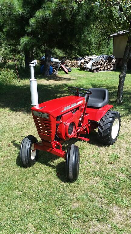

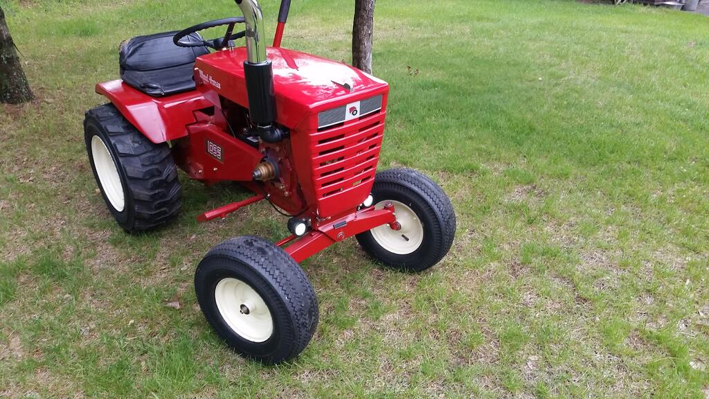

rmaynard 16,589 #23 Posted July 30, 2021 Wheel Horse tractors were not designed to have stack mufflers. I personally would not have one due to low hanging branches. But if you insist on having one, make a bracket to hold it upright and to support the weight. The cast iron exhaust outlet on Kohler engines is not designed for stacks without some sort of brace. Just my for the day. 5 Share this post Link to post Share on other sites
