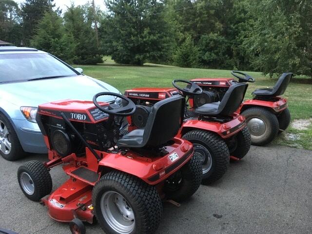

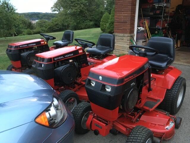

cschannuth 3,819 #2 Posted July 28, 2021 My low hour, like new 2000 314-8 is disappointing with a 42” deck so I can’t imagine an 8 horse trying to spin a decent size deck. Admittedly, I’m used to a 520 and a C-161 with a twin Briggs so I’m spoiled for horse power. They both mow in high gear with a 48” deck with ease. Share this post Link to post Share on other sites

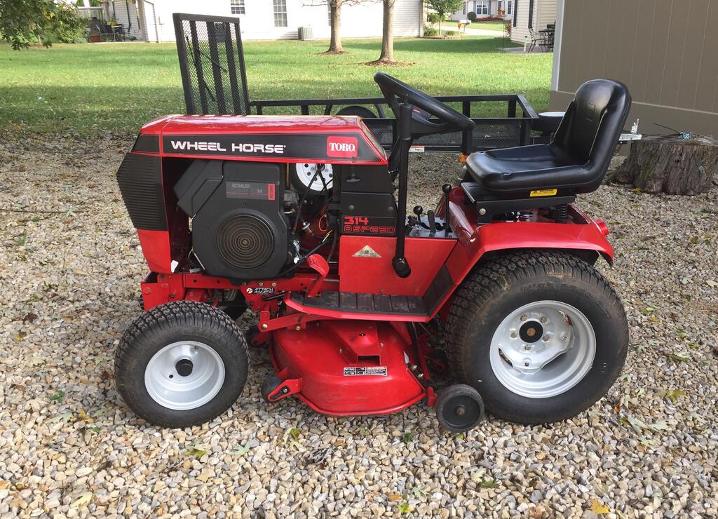

cschannuth 3,819 #8 Posted July 29, 2021 1 hour ago, Ed Kennell said: That really surprises me Craig. I have run 42"SD on 312H, C-120H, and Raider10 and they have all done a great job. Just my experience. For the 48"ers I use the 417H It runs perfect and it’s quiet and smooth as can be. it’s just that I can’t get a clean cut in second gear high range like I can with my bigger machines. But, my yard is very thick because I’m kind of a nut when it comes to fertilization. Share this post Link to post Share on other sites
cschannuth 3,819 #9 Posted July 29, 2021 (edited) 51 minutes ago, OutdoorEnvy said: Yeah something must be up...My 312 runs a 42" SD great. It has mowed really heavy stuff with ease...Are you sure it might not be the friction disc losing traction or something or the mule needs tightening? It runs perfect and it’s quiet and smooth as can be and only has a couple hundred hours on it. it’s just that I can’t get a clean cut in second gear high range like I can with my bigger machines. But, my yard is very thick because I’m kind of a nut when it comes to fertilization. Edited July 29, 2021 by cschannuth Share this post Link to post Share on other sites

cschannuth 3,819 #13 Posted July 29, 2021 (edited) 8 hours ago, tom2p said: your experience does not surprise me My 314 is so smooth and quiet that I thought maybe it wasn’t reaching full rpm so I checked it and it was it just under 3600 RPM so it’s doing everything it should. Because it’s so quiet I love using it and I’ve turned it into one of my toward tractor but don’t use it any more for mowing. Consequently the brand new looking 42” deck sits in my shop. Edited July 29, 2021 by cschannuth Share this post Link to post Share on other sites
