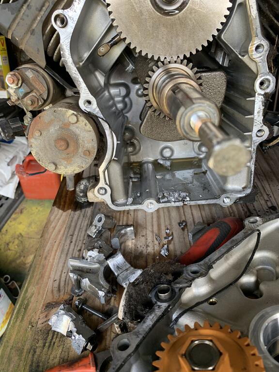

Hwhitaker1 1 #1 Posted July 28, 2021 We have a 2002 522xi this just started today when mowing going uphill the engines Boggs down and will die but I can go uphill fine without pto on. If it’s a slight incline if I let up on gas it will kick back in full speed then it made a noise and completely died! Share this post Link to post Share on other sites

Hwhitaker1 1 #7 Posted July 31, 2021 Yep no compression found some bits of aluminum in the oil ☹️ 2 Share this post Link to post Share on other sites
Hwhitaker1 1 #8 Posted August 2, 2021 Yep no compression found some bits of aluminum in the oil ☹️ Someone had removed the oil sentry so when the oil came out while mowing it didn’t shut off! 2 Share this post Link to post Share on other sites
