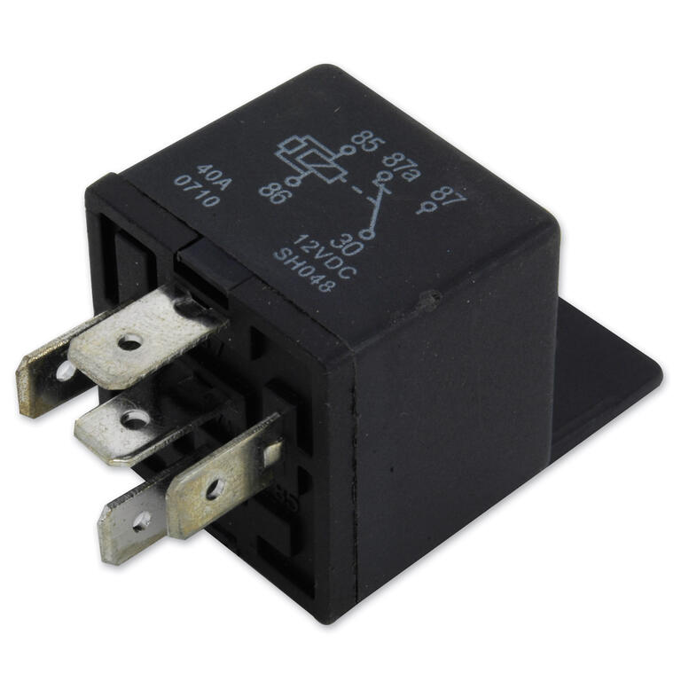

Achto 29,501 #3 Posted July 28, 2021 3 hours ago, Dan.gerous said: When you turn the ignition to start it all you get is a quiet "click" somewhere below the battery and nothing else. The quiet click that you hear is most likely the starter relay, ( little black box under the battery) The start signal goes through a series of switches (key, PTO, & clutch peddle ) and then powers up a magnet inside the start relay to close a switch to send power to the small terminal on the starter solenoid. This powers a magnet in the starter solenoid and closes the switch between the 2 large terminals to send battery power to the starter. Starting at the key switch, use the diagram that gwest provided to trace the starting circuit and find the power interruption. 1 Share this post Link to post Share on other sites
