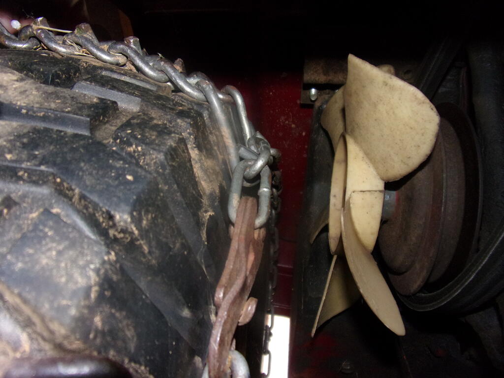

Jon925mn 39 #1 Posted July 25, 2021 2 rear tires ( 23x9.5-12 ) on '89 520 need replacing. I have 2 tires (23x10.5-12 ) sitting around that will fit on rims but am concerned about clearance. Anyone hear have 10.5's with chains on their 520-H? Do I need spacers to avoid hitting fan? Share this post Link to post Share on other sites
pfrederi 20,187 #2 Posted July 25, 2021 Don't have any 520s but I do use 10.50 on a Charger 12 hydro with rubber chains no clearance issues. Share this post Link to post Share on other sites
Ed Kennell 45,615 #3 Posted July 25, 2021 This is the clearance I have with the 9.5" tires on my '88 520. I think you would be OK with the 10.5"ers, even if they bulge the total 1/2" on the inside. Just don't leave any loose side chains flopping around on the inside. 2 Share this post Link to post Share on other sites
lynnmor 8,729 #4 Posted July 26, 2021 (edited) 10.5 was the original tire size on my 1991 and up 520H's, 9.5 was recommended ag tires. The first 520H's had 9.5 and the 520HC had 10.5. Edited July 26, 2021 by lynnmor Share this post Link to post Share on other sites
Lee1977 7,632 #5 Posted July 26, 2021 The 1988, 1989, 520-H had 7" wide rear wheels that will make the side of 10.50 tire bulge out more then the later 8.5" wide wheels. Share this post Link to post Share on other sites
Jon925mn 39 #6 Posted July 27, 2021 Tires are on without chains and look good. I think the chains are more likely to hit the tank bracket than the hydro fan. Chains will definitely need to have no slop on inside. Thanks all for comments. 2 Share this post Link to post Share on other sites
lynnmor 8,729 #7 Posted July 27, 2021 7 hours ago, Jon925mn said: Tires are on without chains and look good. I think the chains are more likely to hit the tank bracket than the hydro fan. Chains will definitely need to have no slop on inside. Thanks all for comments. I bought a pair of wheels with 10.5 Dico tires that I believe to be original. I don't know what tractor they were on, but the seller did say it was a Wheelhorse. The offset is less causing the reduced clearance at the tank bracket, so check that. Share this post Link to post Share on other sites
WheelHorse520H 710 #8 Posted July 27, 2021 (edited) Norman with isavetractors.com has a 300 series (I believe they are the same frame, or at least very similar in size) and had a Video (about 9 minutes into the video) about how the sidewalls actually rubbed with the frame. Edited July 27, 2021 by WheelHorse520H Share this post Link to post Share on other sites
